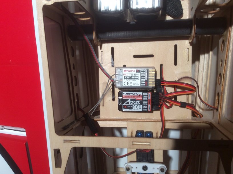

Here's a shot of the gyro in the plane.

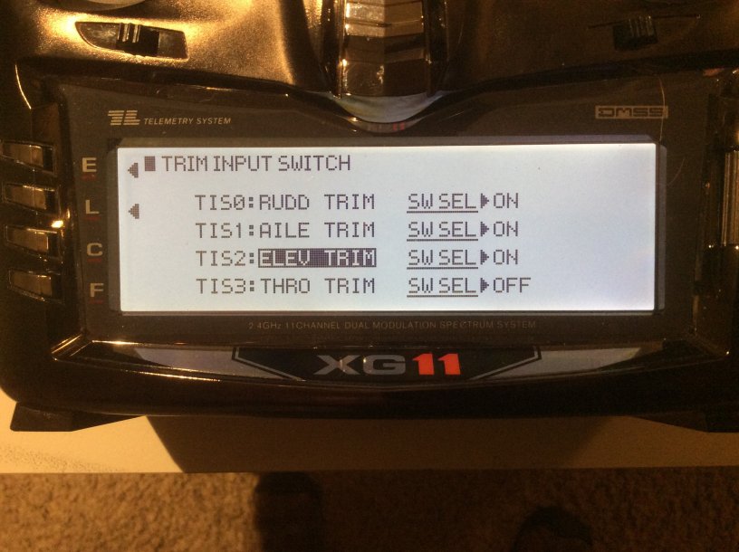

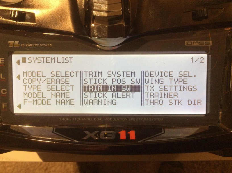

I also setup the gain adjustments independently by using the trim switches to adjust the gains in flight.
