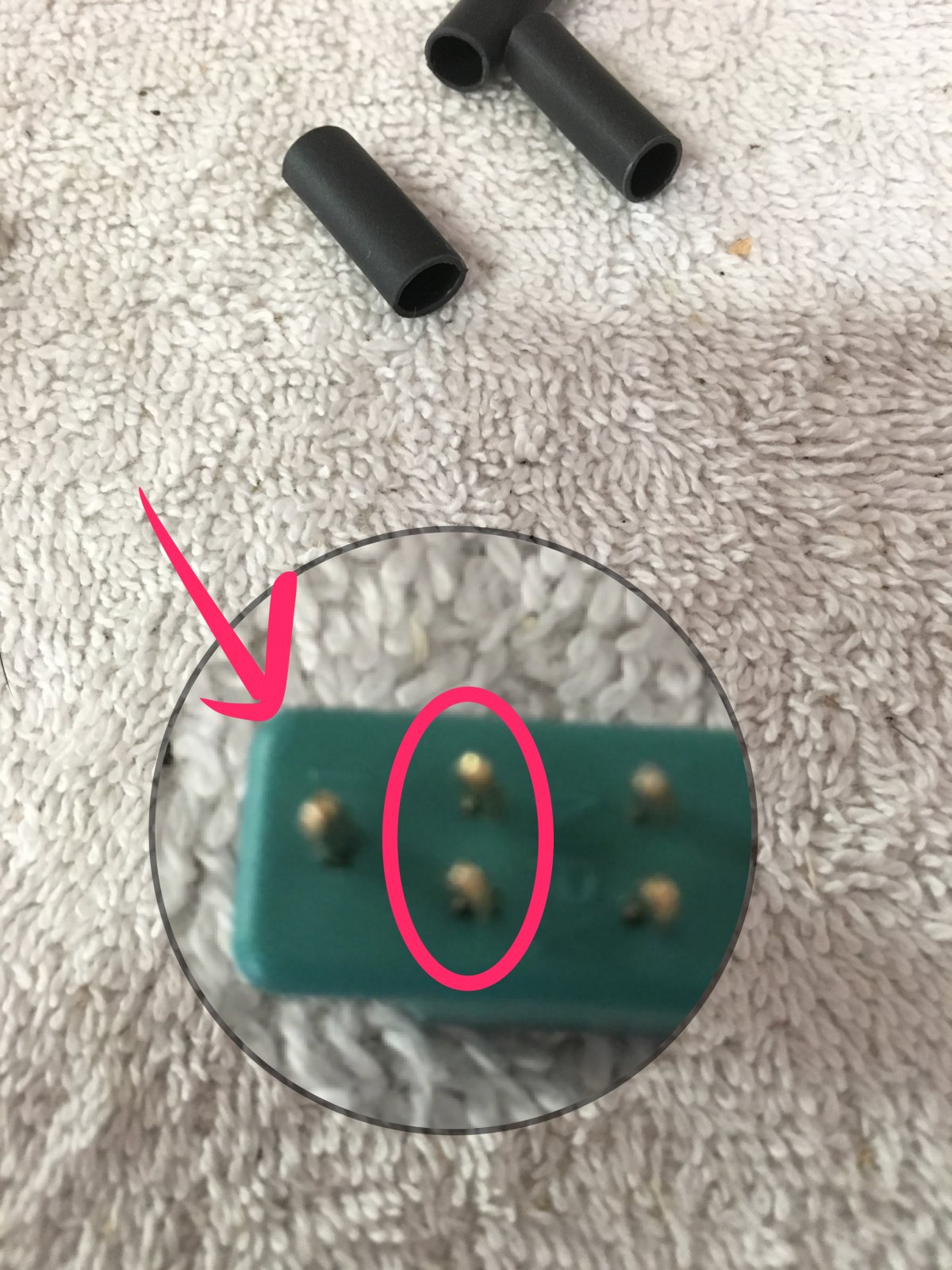

Thanks guys, I'm taking the opportunity to go through my 35% and do some updating. Needs a carb kit I think, I'm removing the ignition battery and switch and installing and IBEC, a wheel pant needs a little attention..
I'm looking at mounting the CB200 in the plane and my batteries have EC3 connectors. I need to install the multiplex connectors, I notice there's 3 pins each for + and - do you solder somehow to all 3 pins? Or just hit the center 2 and leave the outside pins or how do I need to do this? I bought their little solder adapter plates but being as the wires stick straight up I'd like to keep them as short as possible.
Hope that makes sense.

Okay what i did is bend the tips together so its around the wir , i used 16 gauge for the battery leads with silver solider and flux . I melted one adapter as i get the pin too hot so i used a low temp silver flux and it works great .

Oh I didn't think of bending the pins, great idea I will try that. I didn't realize the receivers came with the multiplex plug for the battery side so I have 6 extra now, good in case I melt one.

Good to hear you have spares , it might take one practice try . Make sure you the heat shrink is on the wire before solider , personal ooops

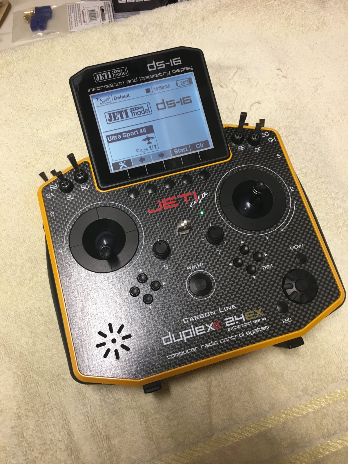

Well after 12 long days I finally got my hands on a Jeti. Initial impressions are DAMN, this thing is nice. Surprisingly comfortable in my hands, it is heavy, heavier than my 12x was for sure. Build quality looks second to none. I was kind of suprised on the yellow color however. I was expecting like a Ducati or Ferrari shade of yellow, it's labeled "Sunburst Yellow" on the website but the box it came in is labeled "Dark Yellow" which is kind of a cub yellow but it looks really nice, I really like it.
I updated the firmware in the TX and the R7 RX, easy no problems. Then I setup my first model, I was a little concerned reading through the manuals that it was going to be complicated, but it was pretty easy. As you guys said once you setup a model it all makes sense and it does.
Due to the weight I may try the neck strap, I've only tried one once before and didn't like it. This felt pretty comfortable so I'm going to give it a try again. If not I'm sure it will be fine to hold it old school style.
So far I like it!

Flew the Jeti today, flew great no issues. I didn't notice the weight at all, didn't think about it once so I guess I won't be using the neck strap. Did have an issue with the timer, didn't realize I needed to tell it to beep when the time expires! Got that fixed and flew maybe 7 flights today, very happy with it. On to setup the next plane!
