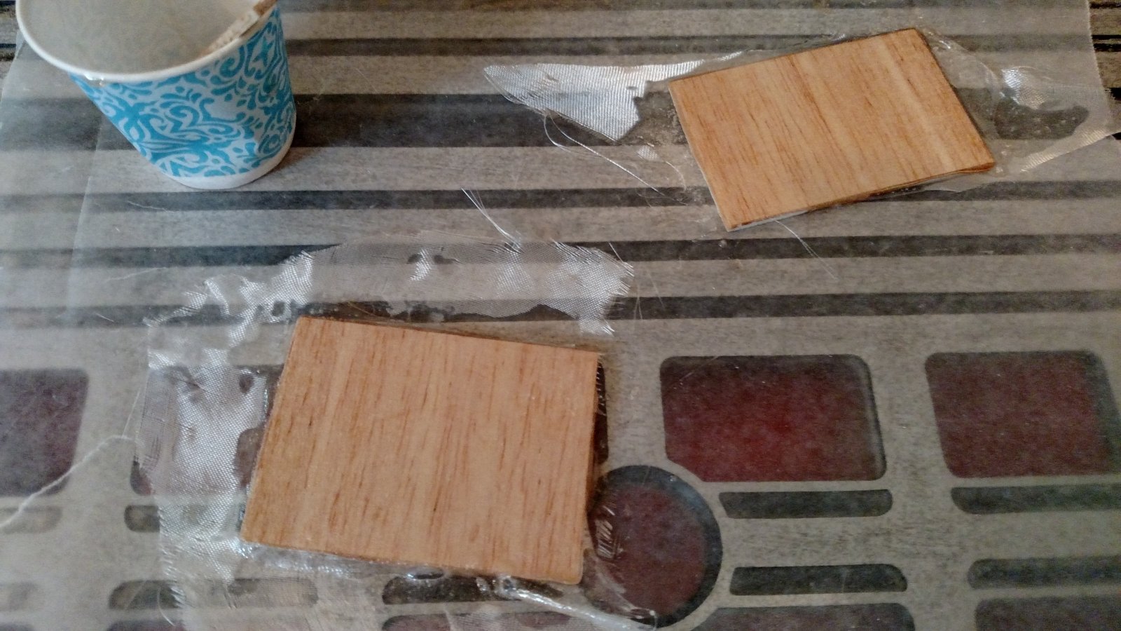

Control linkages are mostly complete. Trying my hand at fiberglassing now. These are potential hatches for the right aileron and outer flap servos. If they turn out okay, I'll use them. If not, I'll remake them and try again.
Bipeguy03
Biggest trick to glassing is getting enough resin on to fill the weave, without it being to thick which adds a ton on weight.
I always have a bunch of credit card blanks on hand, and use them to spread the resin. They also help scrape off access resin, so your finished job is smooth, even and light!
Patto
This was my first attempt at glassing EVER. I was able to sand it down to fairly smooth. I will experiment with priming it and see what happens.
As usual, I really appreciate the advice!
