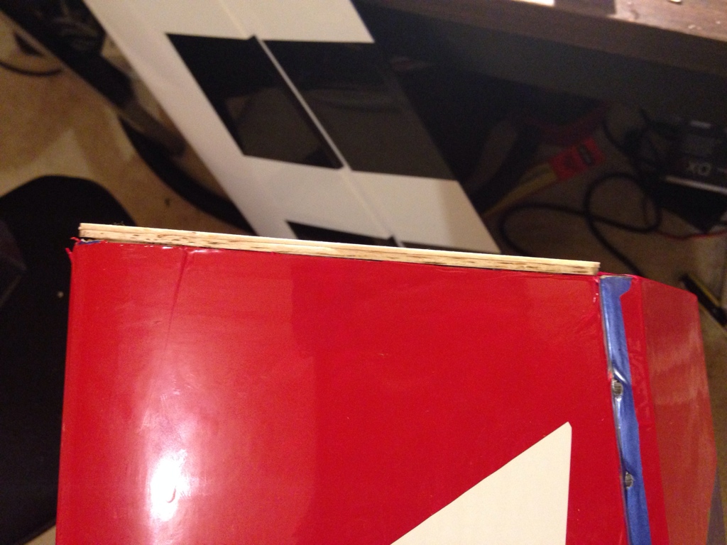

They are already made, so not much to show. I put a piece of 1/8" ply on the wing tips with blind nuts on the back to bolt them on to. With this method, they can be added to any plane with flat tips.

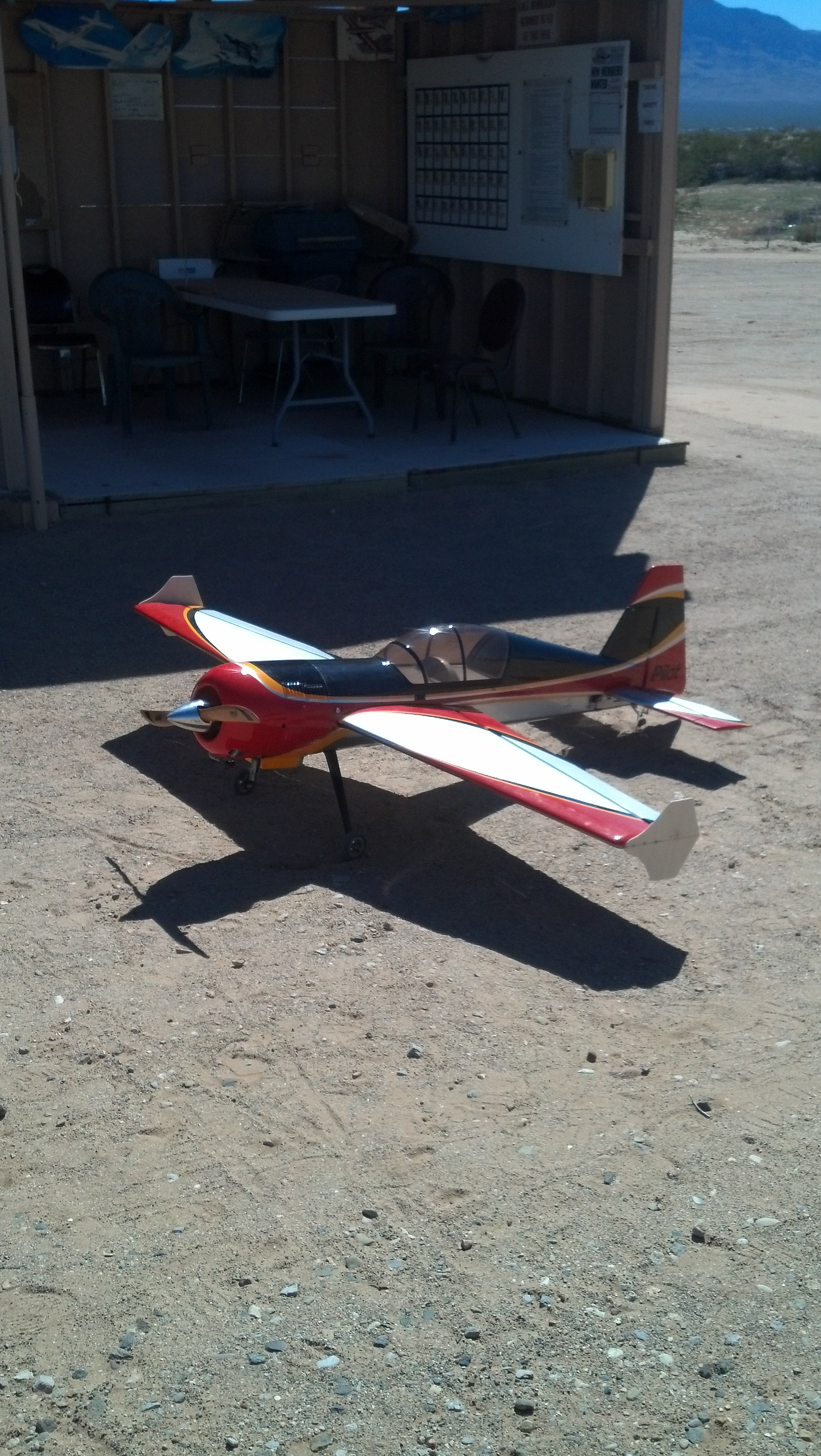

Jace
Well I tired of waiting and just made my own :cool:

3dNater
3DRCF Regional Ambassador
They look nice [MENTION=2979]jace[/MENTION], good job! :D Now throw some black paint on them ;)

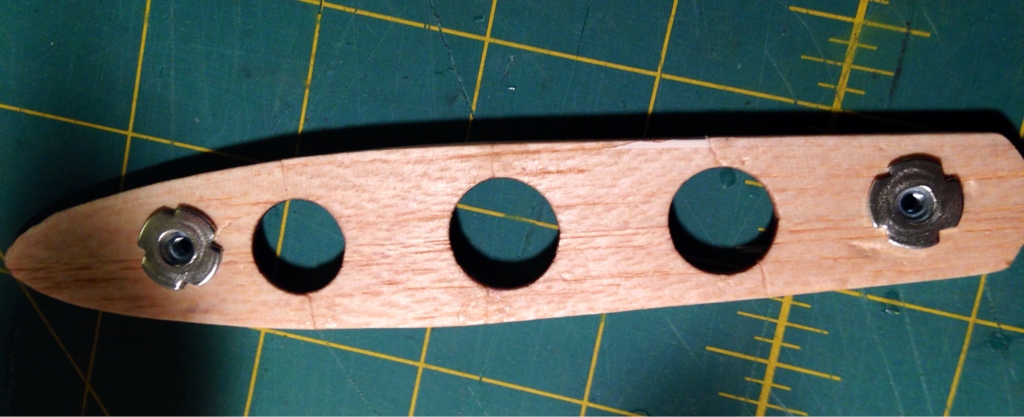

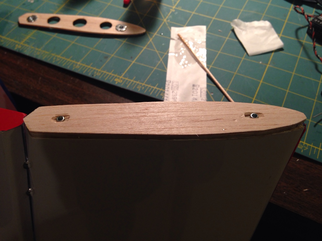

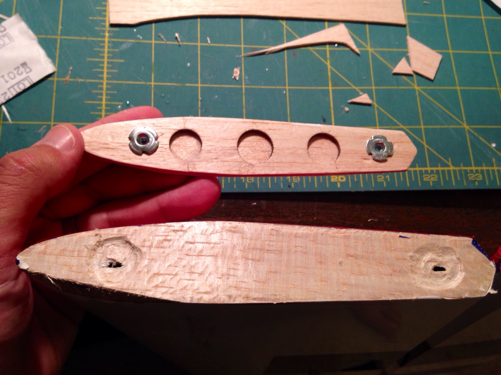

Kinda made my own SFGs last night... Got the 74" edge prototype I owned previously back, and figured id add what it had been missing, SFGs...

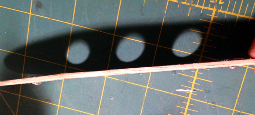

First, I acquired the current 74" SFGs and spacers, then went about adding blind nuts to the spacers, and making the spacers a little thicker to accommodate the blind nut.

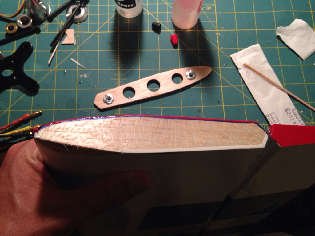

ImageUploadedByTapatalk1397067644.241224.jpgImageUploadedByTapatalk1397067658.695674.jpg
Then I prepared and mounted them to the wingtips with epoxy.
ImageUploadedByTapatalk1397067704.597145.jpgImageUploadedByTapatalk1397067714.785092.jpgImageUploadedByTapatalk1397067725.427492.jpgImageUploadedByTapatalk1397067801.064610.jpg

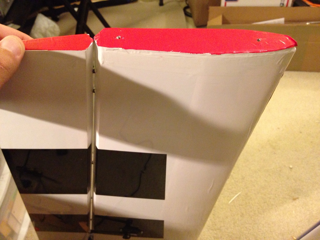

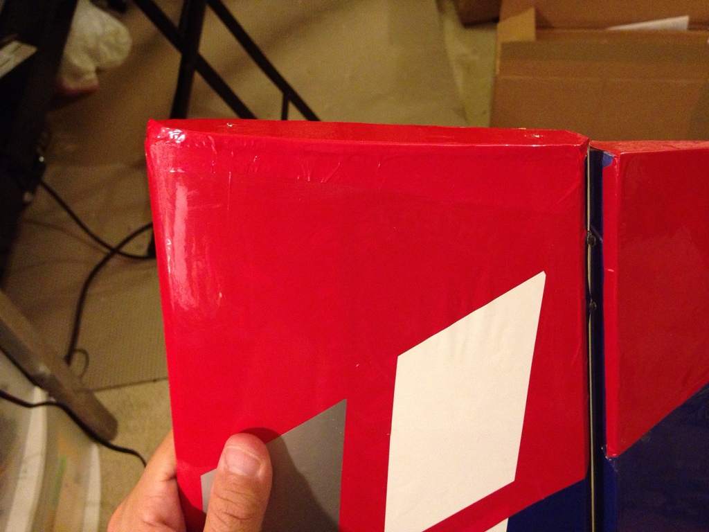

Next, I added some covering, white on the bottom, and overlapping red on the top.
ImageUploadedByTapatalk1397067774.223358.jpgImageUploadedByTapatalk1397067789.335082.jpg

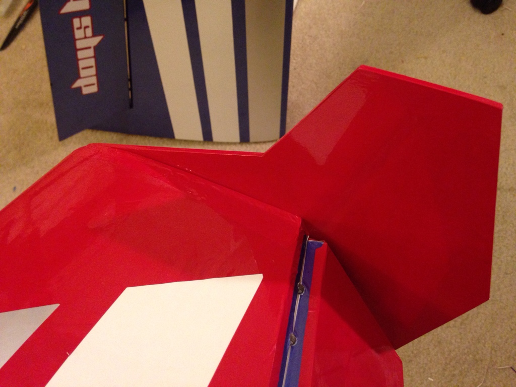

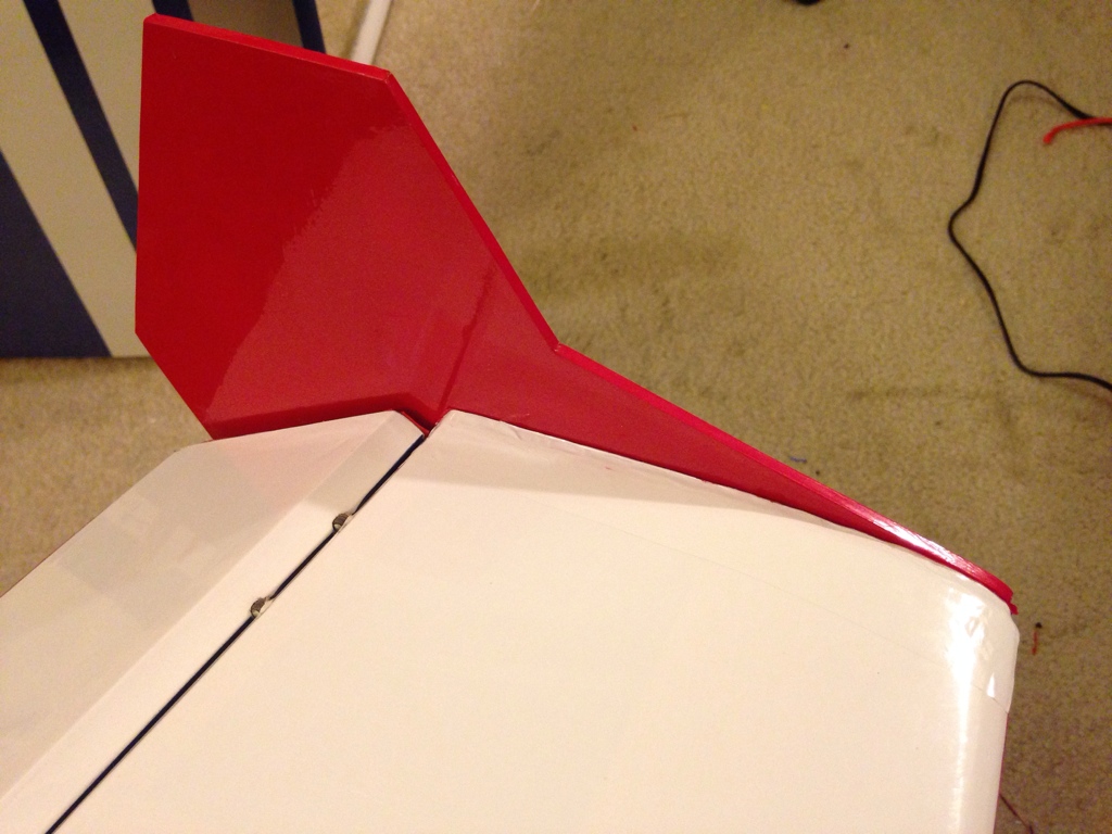

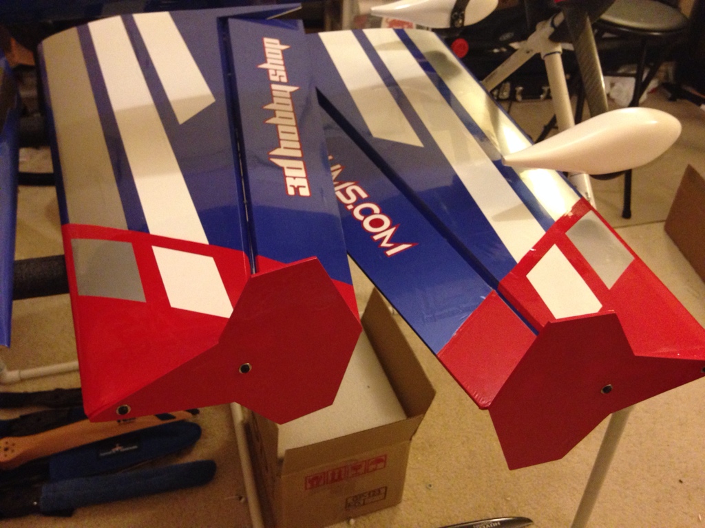

Finally, I installed the SFGs:
ImageUploadedByTapatalk1397067852.830607.jpgImageUploadedByTapatalk1397067861.250693.jpgImageUploadedByTapatalk1397067881.168312.jpg
Not the perfect and pretty install, but sturdy, functional, and the wrinkles won't be visible when I'm flying :)
