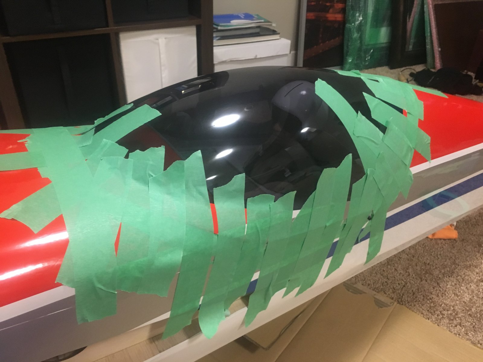

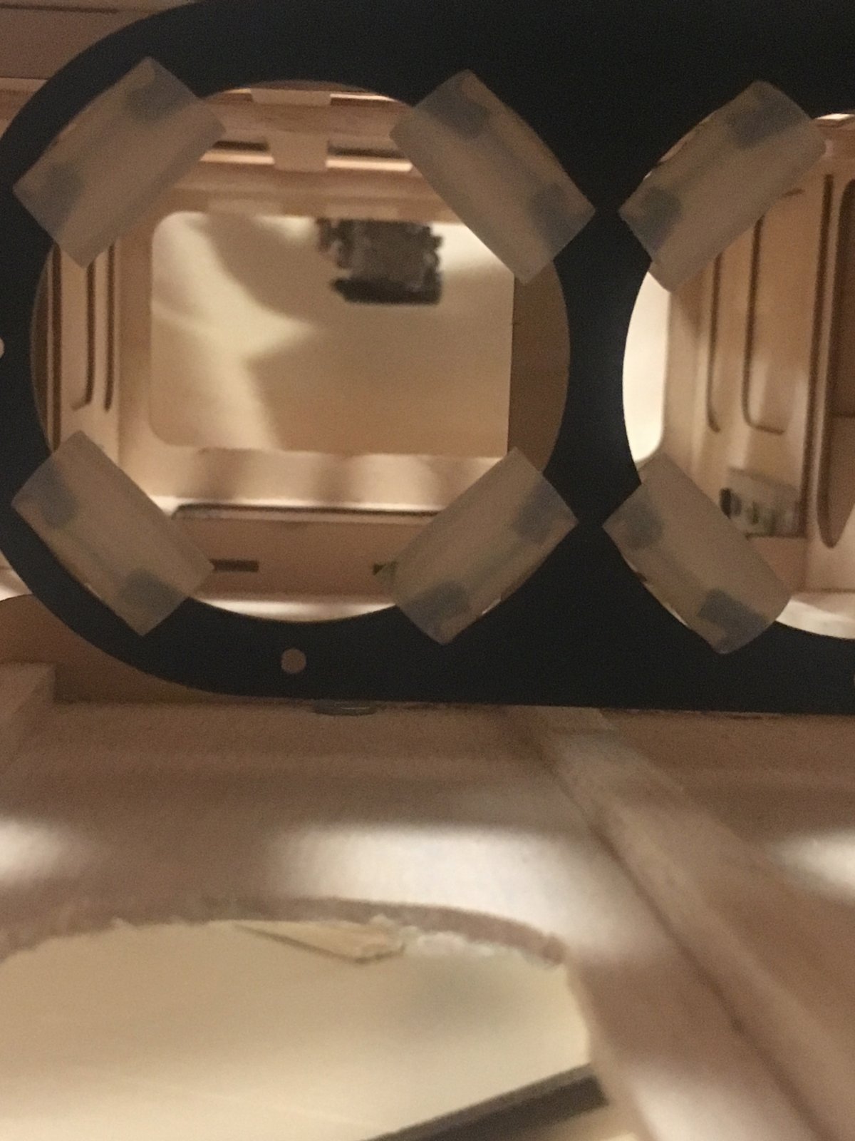

Here's some fresh pictures of my PAU Extra , all taped down waiting for the Goop to cure .
Rusty 73

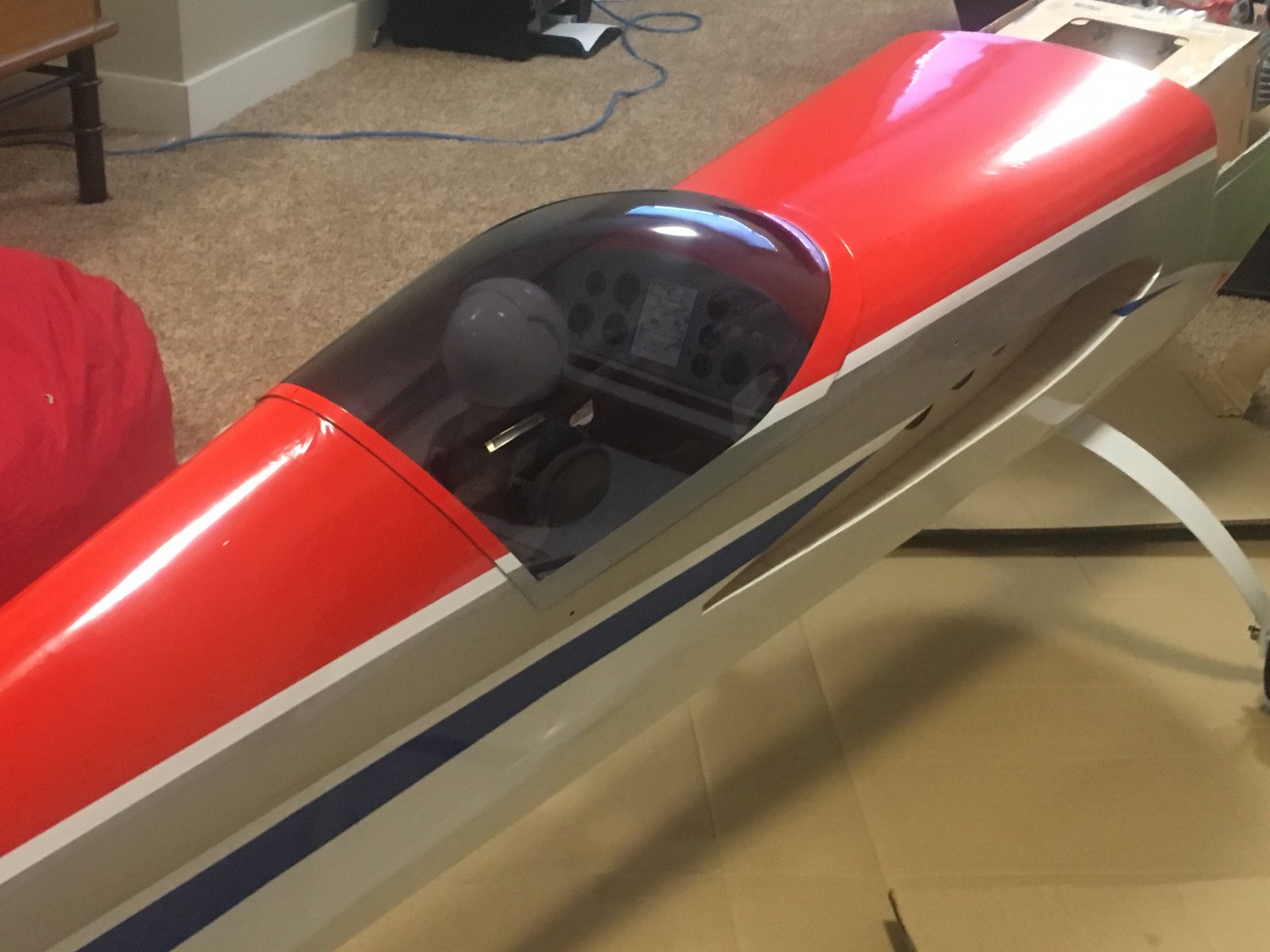

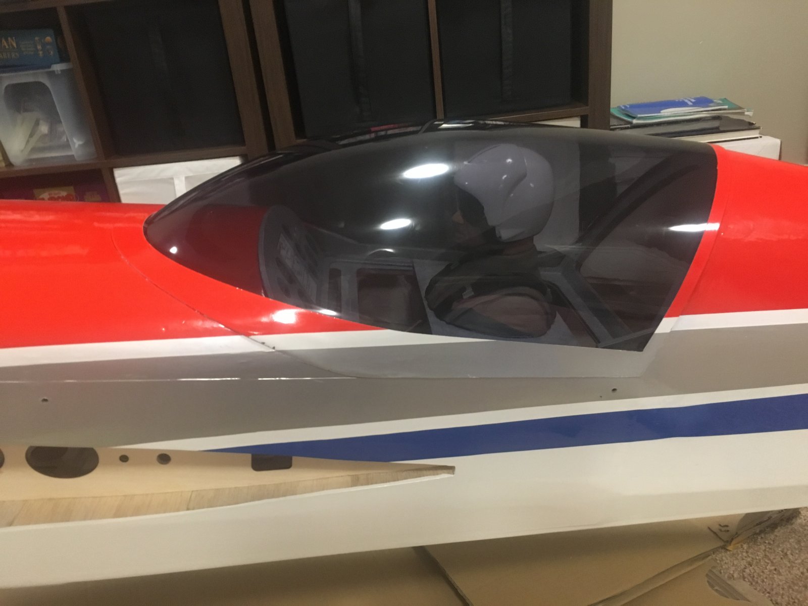

With the bandages/ tape and then removed , notice how the paint lines of the right side don't line up . This plane came from the first batch of Extra's that was launched last March .
Rusty 73
This side the paint lines just about lined up , I guess these are the problems with the first batch of airframes .

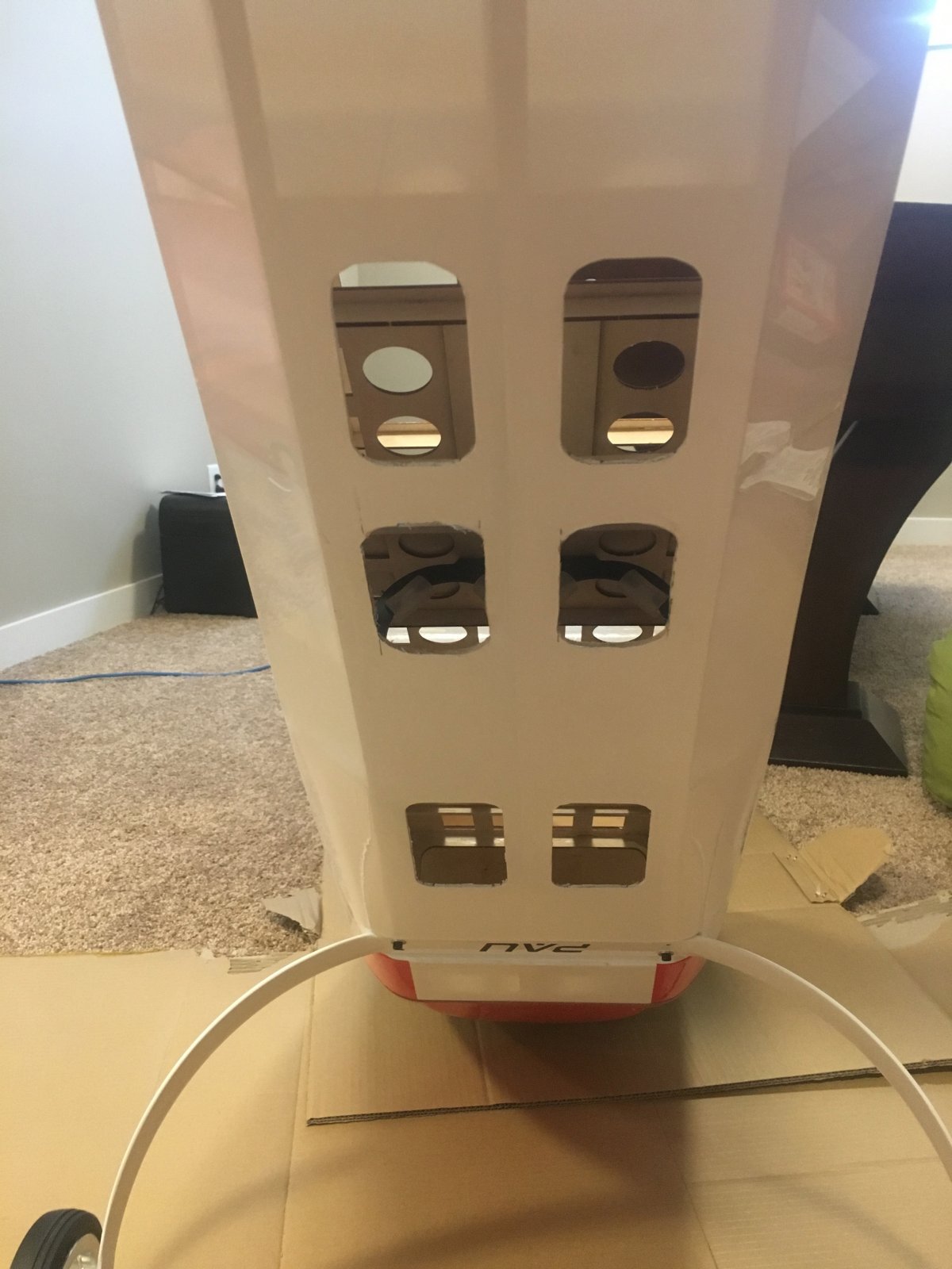

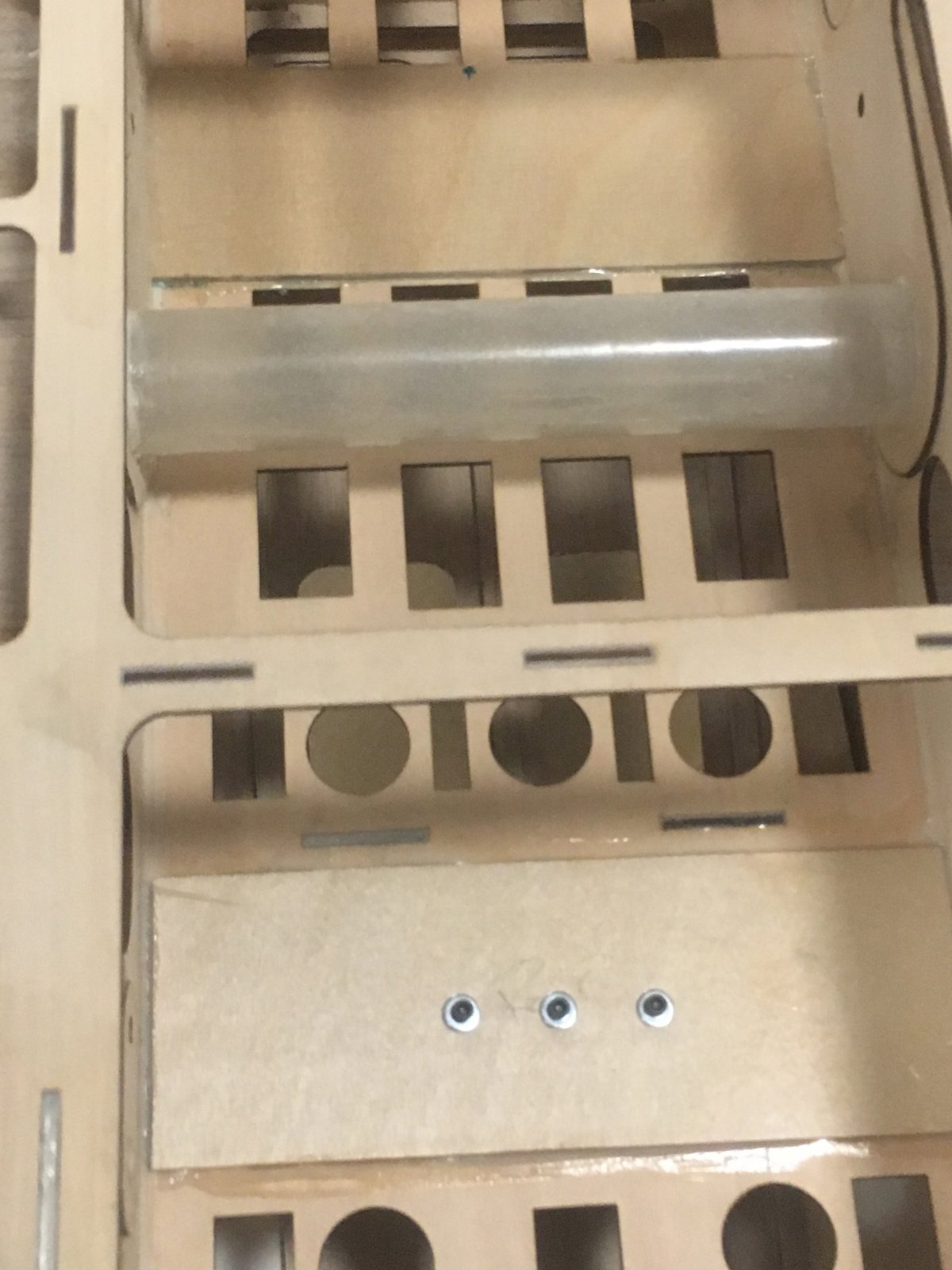

This is the rear mount for the pipe , used some 3/16 plywood for reinforcement and used 6/32 bolts with locking washers to support the bracket.
Rusty 73

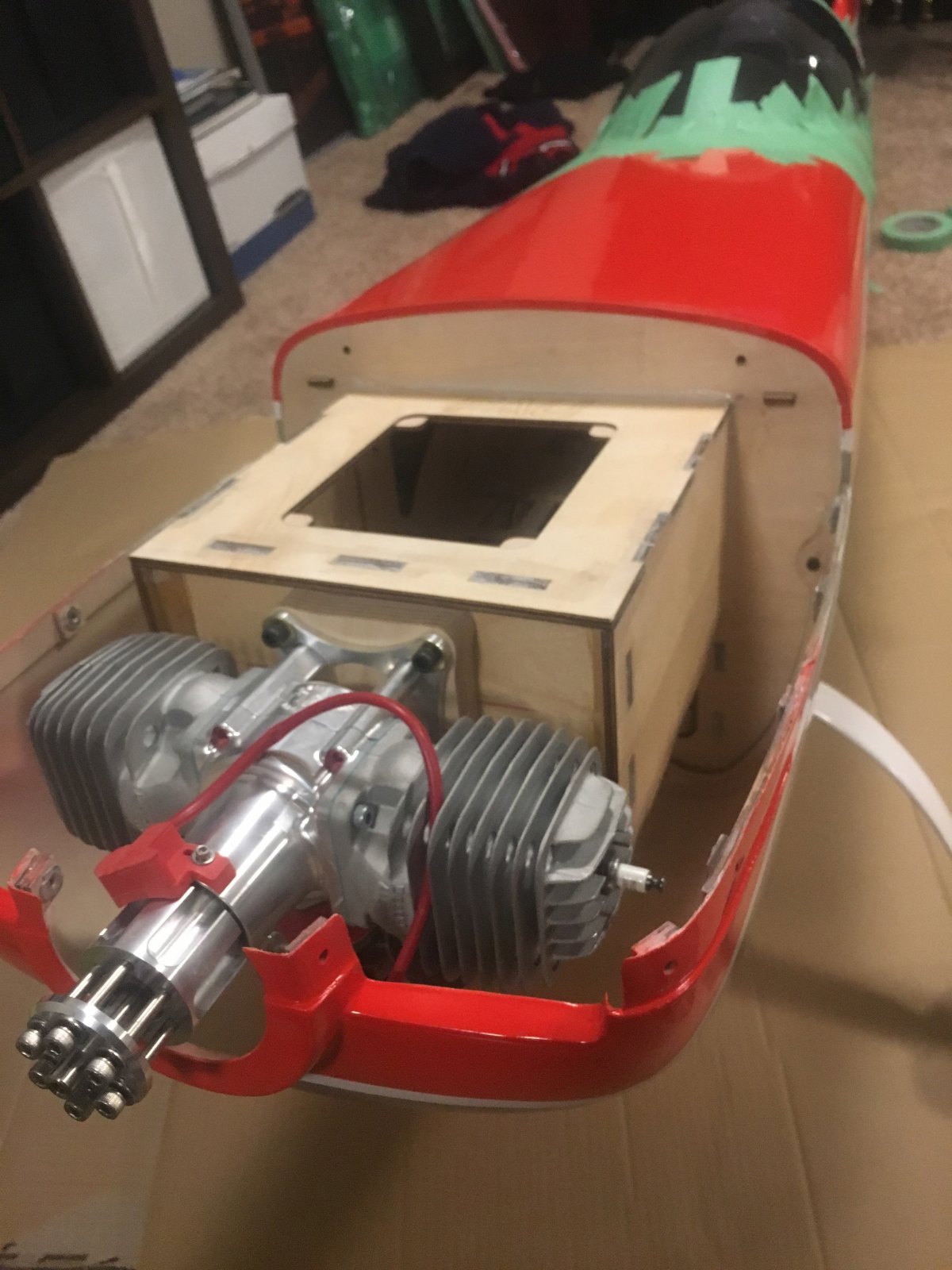

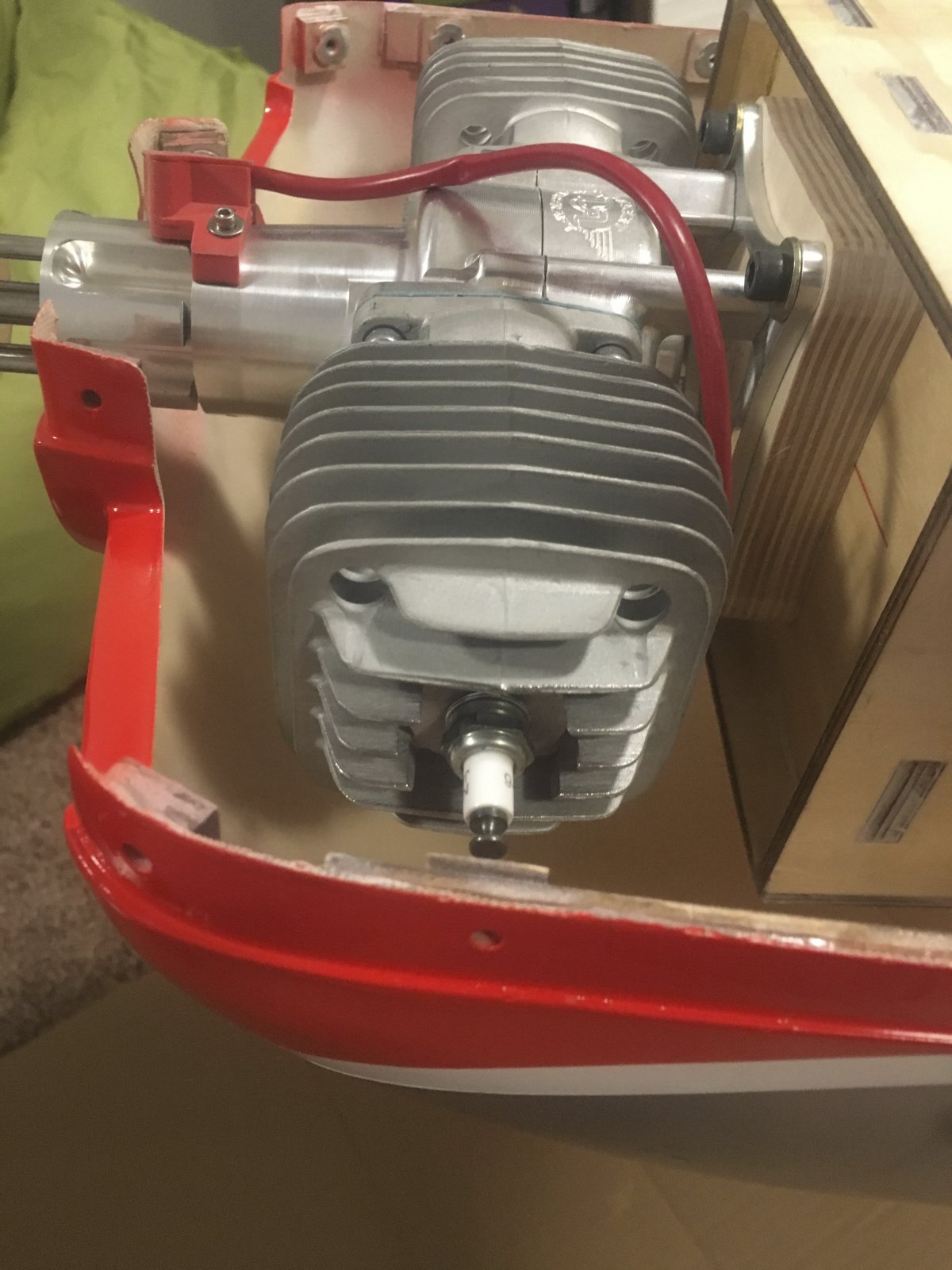

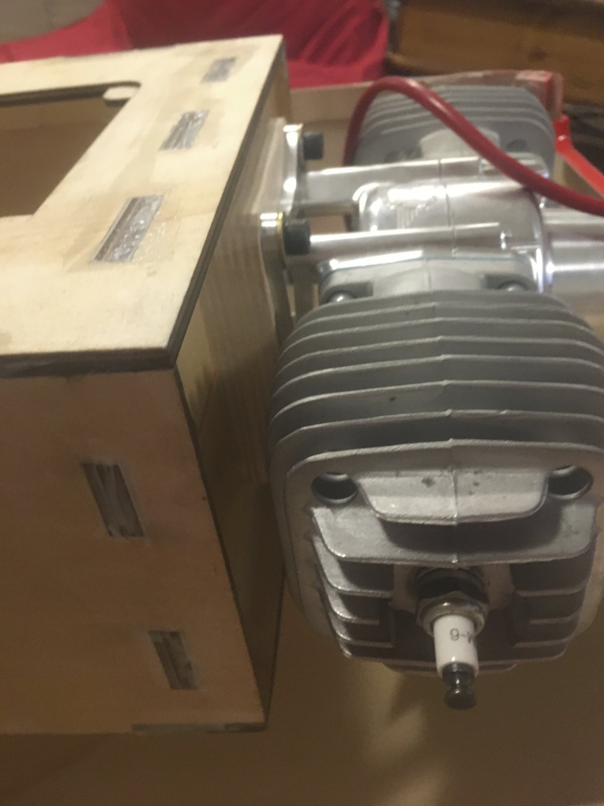

Here's picture of the engine with a plywood mount 0.80" , Herve suggest a nose weight from white rose of 6 ounces to offset the tail heaviness of this plane so I'm loading up the front with as much weight as possible to reduce have to run a weight on the engine .
Noticed the holes in the middle are for the exit of the pipes.
Very Nice Russell, I like the idea of making the add on weight functional. Sorry about that first fuse, what a bummer, but nice that Herve took care of you!

After adding baffling into the cowl along with the plywood mount , it should reduce the amount of balance weight that i will have to add.
