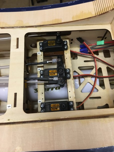

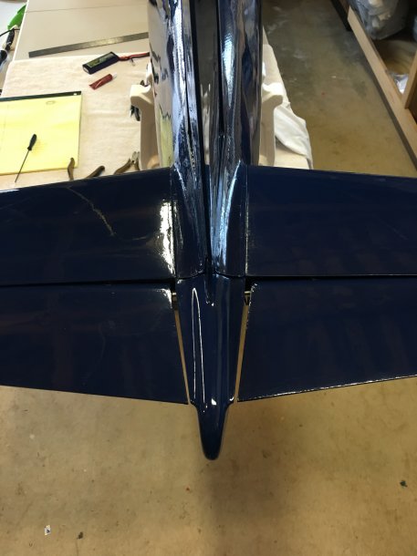

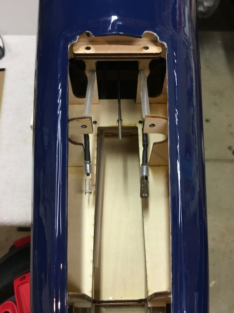

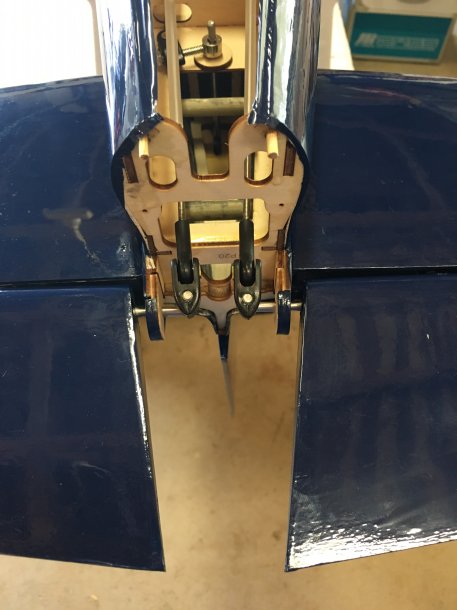

Elevators hinged, pushrods and linkages installed. Even the pushrods are heavy, the ones for the elevators are 45" long! Had to run to the LHS and buy some less heavy duty servo arms, the ones I bought were too big to clear the side of the fuse. 10 bucks and the problem was solved. Set the throws for the elevators and fit the tail cone. The tail cone has a slot for a tail hook. I saw on one of the threads that H9 was thinking about making a tail hook for it. I think that would be pretty cool.

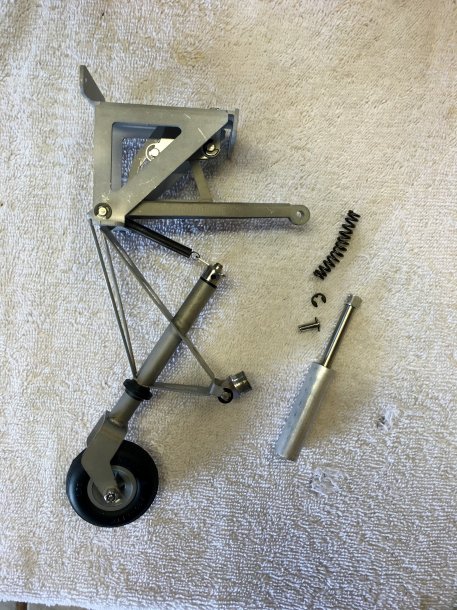

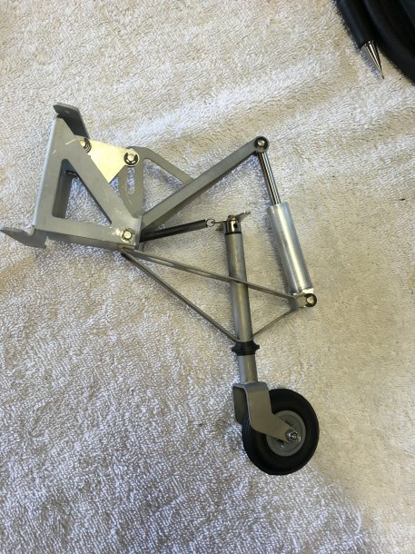

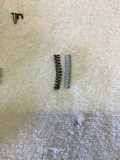

I started looking at the tailwheel... It has a spring-shock doo-hicky that is SUPER stiff. I heard H9 doesn't loc-tite anything on it and people have been dropping their tail wheels in flight. I disassembled the shock and the spring in there was total junk. Looks like it was too long so they bent it to fit it in there and it was so stiff you could hardly compress it by hand. I ran down to OSH and for $1.80 I got a spring that's about half as stiff (still stiff enough) and actually fits. Put it all back together with loc-tite and it seems to function much better now.

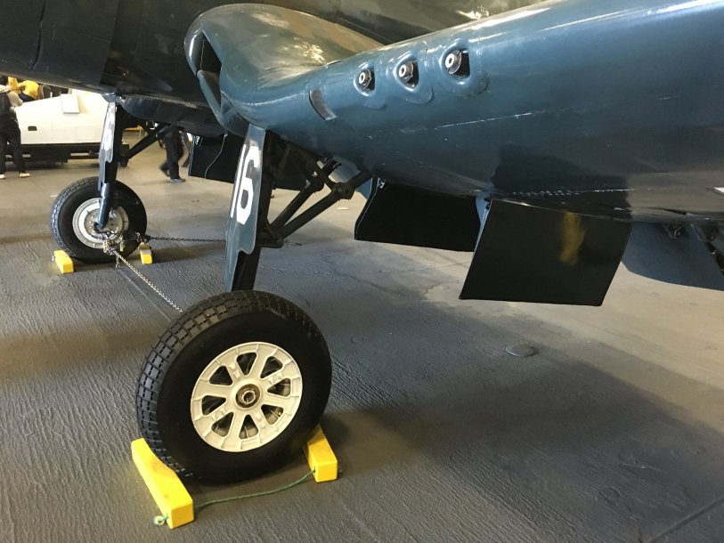

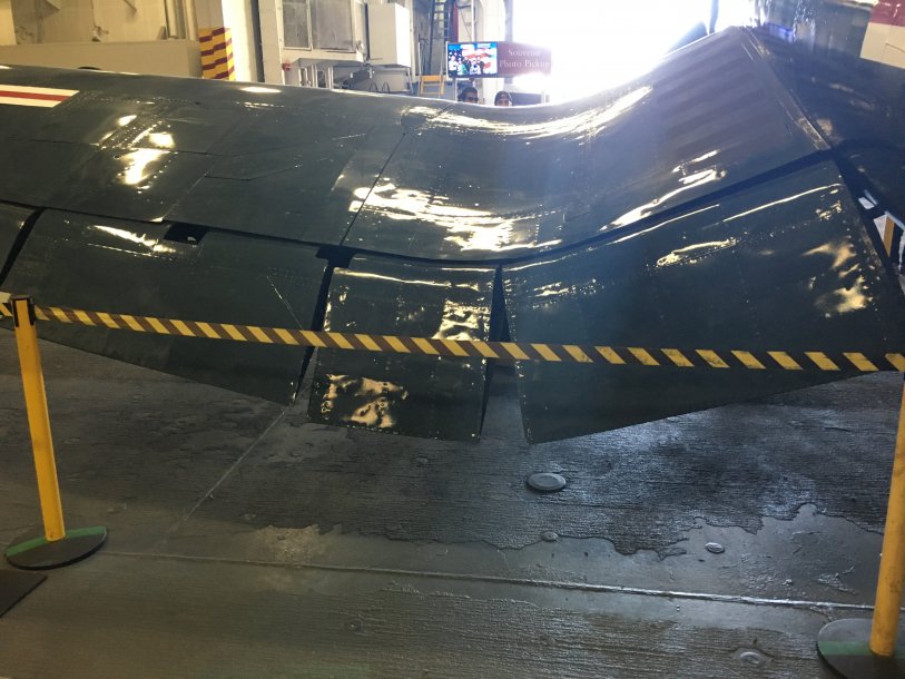

A couple of weeks ago when I was in San Diego for work I ended up with most of Friday free before my plane left at 5:00. So I decided to go to the USS Midway museum. I was in the Navy so the actual ship wasn't anything new, I was there to see the planes. There was a Corsair, here are the pics I took.
There's been some debate on if Corsairs were shiny on the Corsair threads. They were apparently delivered shiny and weathered quickly to be dull. This one was shiny, I'm going to leave mine shiny.

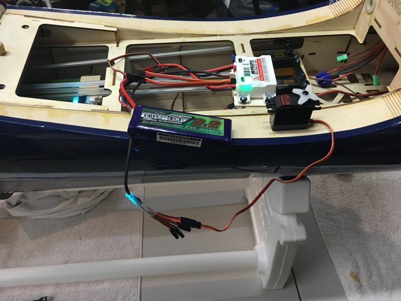

Spent the evening figuring out how to program the xbus gear door servos. I need to mount the Xport Duo soon and once I do the connections for the xbus input, xbus output and switch are going to be difficult to get to. So... I figured now would be the time to program the xbus 4 servo converter cable for the 4 gear door servos in case I go that route. It was actually really simple and worked exactly how I thought it would. The Xport Duo is a very flexible device.

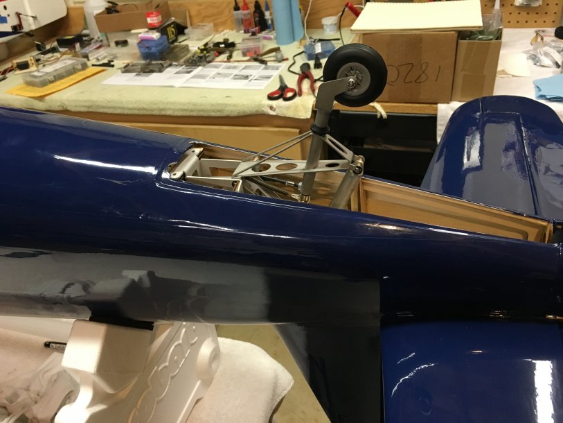

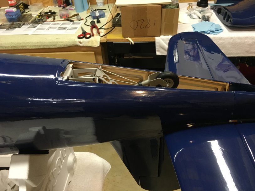

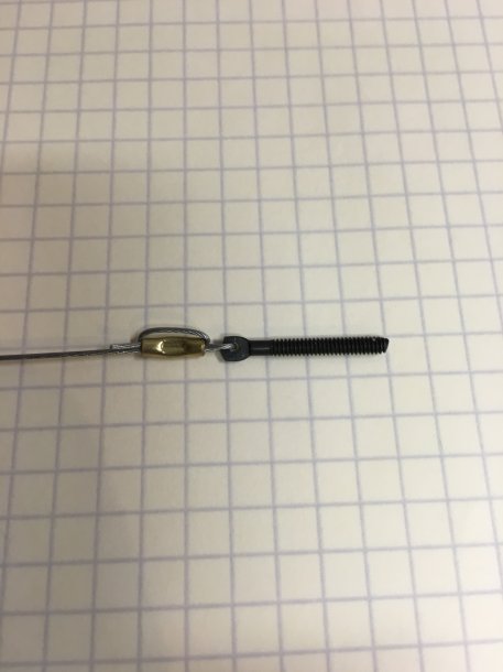

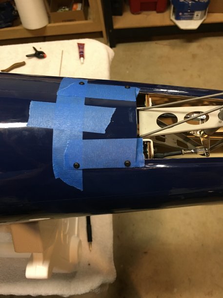

Took a run at the tailwheel installation tonight. The steering is setup with a set of pull-pull cables and then the retract mechanism is pushrod actuated off a pneumatic cylinder. I started making up the ends of the cables on the tailwheel side first. Just following the instructions. The heat shrink they give you is way too big, I had some the right size. Ran the cables and pushrod through the fuse. Then temporarily installed the tailwheel unit, it fits pretty tight but no prob. Hooked up the cables and threaded the rod in. Then went to thread the rod onto the air cylinder, no go. I look at it and it's threaded for 2-56 not 4-40! After checking what I ordered from Horizon was right, I'll be calling them tomorrow and see if they will send me the right one.

I installed the six bolts for the tailwheel installation to make it permanent. I made up the servo end of the pull-pull cables for the tailwheel steering and installed the small hatch covering the forward part of the tailwheel retract. The retract mechanism and the steering work very well.

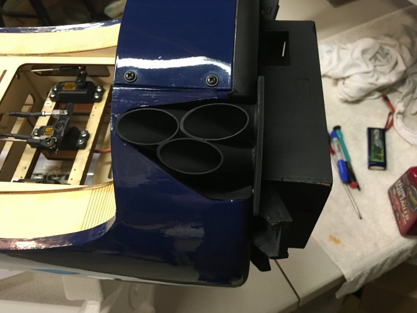

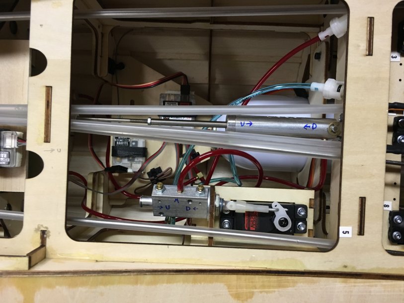

Got a few more parts off the bench and into the plane tonight. I usually try to do a nice clean install. This plane, even though it's a 60cc has just a ton of stuff in a really small space. The air cylinder from Horizon came in today. Same part number as I ordered before except this one fits 4-40 packaging and everything was the same. Looks like it was a Robart error putting the wrong part in the bag. Got it all installed and the pushrod adjusted. Then I permanently installed the retract air valve and servo assembly. Finished up all the pneumatic lines on the fuselage side and installed the dummy scale exhaust, which looks really cool IMO.
