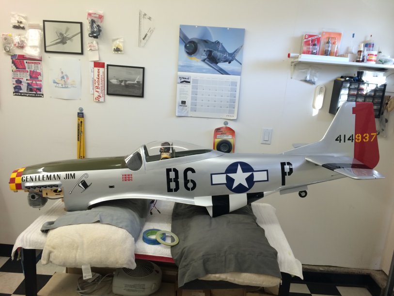

Speaking of the 60cc Mustang, he sent me a motivational pic today.. That thing looks AWESOME! Need to get some bench pillows for the Corsair LOL!

My friend Andy flies the stang with a DA60. He had to recover the plane. He used chrome and made it look like the red tails of Tuskegee. Sharp looking bird.
Plane fly's awesome when he can keep the engine running. He dropped a DLE 55 for the 60 when he recovered it. I think he may have junk in the carb.

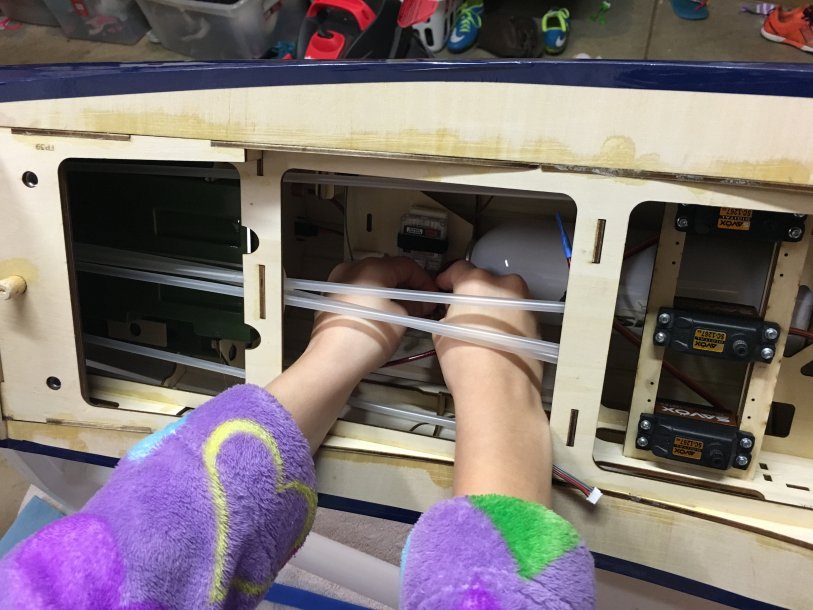

Got some help from some little 6 year old hands tonight. Way easier to reach in and start the zip ties. Got 2 out of 3 satellite receivers mounted and the main part of the infinity receiver. Made up the pushrod for the air valve and set the throws on the retract servo. Patched one of the two known areas of covering that need to be patched. I've been trying to spend an hour a day on it.

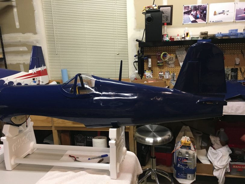

Got the last satellite receiver mounted tonight. The DMSS receivers have the 6" wire with the antenna at the tip so I had to figure out how to mount them. They are all mounted and as neat as I could make them. Next up is the rudder installation, again it has a bunch of rub marks from being in the plastic bags. I waxed it a couple times and got most of it out. One area it went through the covering. I trial fit it, screwed the antenna in and set the solid canopy on it to get an idea of how it's going to look.

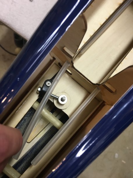

Installed the rudder tonight. Glued in the rudder hinges and setup the linkage and pushrod. All the linkages for the plane are internal except for the ailerons. This tail area is going to be really busy. The elevator pushrod linkages, rudder, tailwheel retract and tailwheel steering cables all go back there. The recommeded high rate throws are 2 - 5/32" on high rate... Pretty exact there Hangar 9, I set mine to 2 -1/2"...on all rates.

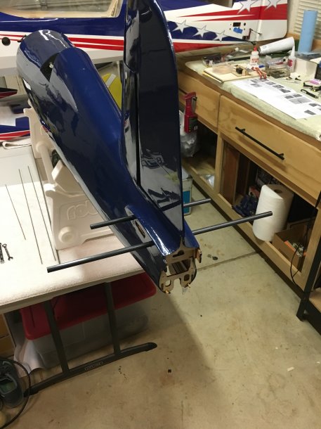

Next up is the stabs/elevators... I trial fit the tubes tonight, they have you epoxy the tubes in and then epoxy the stabs onto the tubes/fuse... I figured this would be a good place to stop tonight.

Stab tubes and stabs glued on today, good news is they fit really nice and tight, no gaps. Started making up the battery lead extensions. Going to work on getting the elevators hinged and installed the rest of tonight/tomorrow. The parts box and number of pieces on the shelf for the plane are getting noticeably smaller now. It's starting to look like a Corsair!
