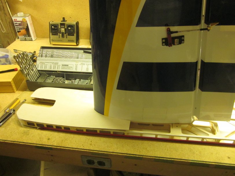

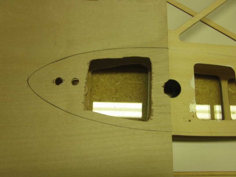

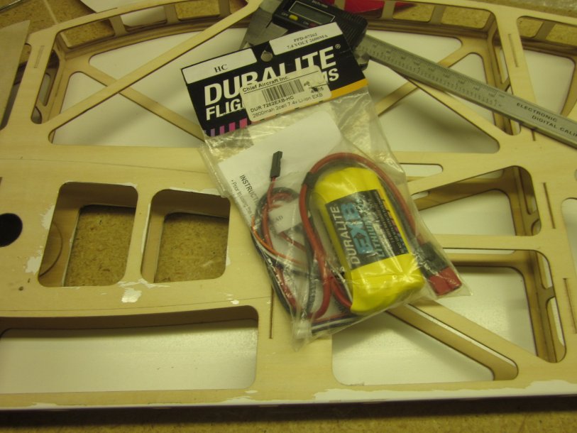

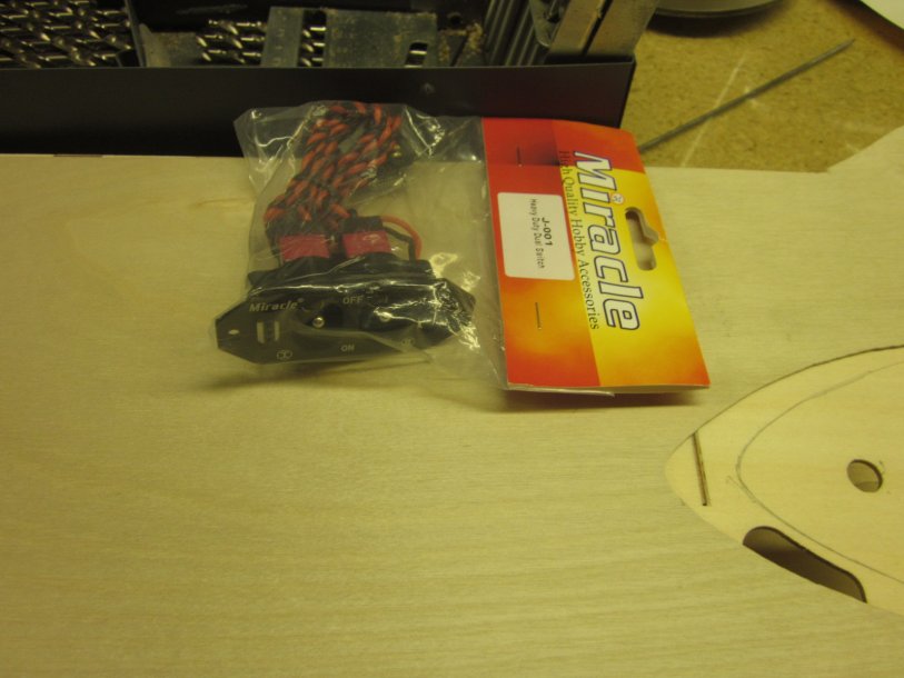

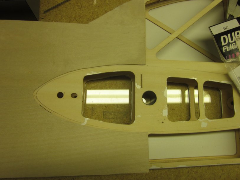

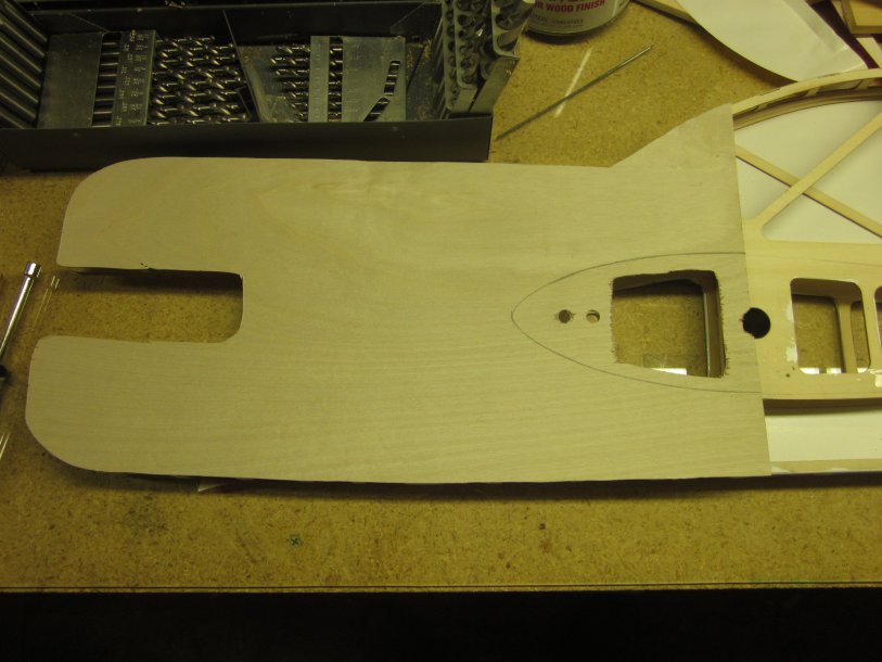

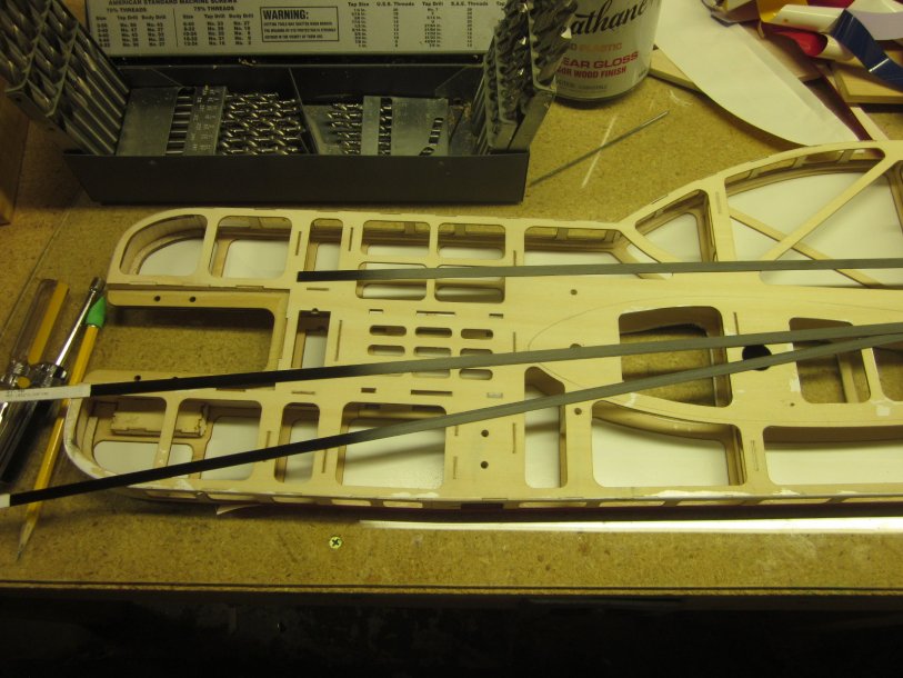

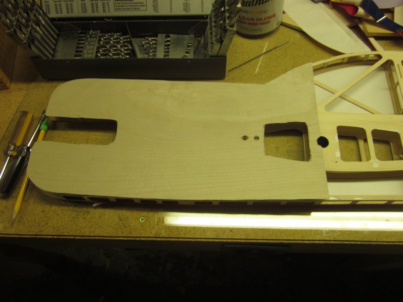

Here is the RED-WING 20cc YAK with the Aero-Works Scheme, I am going to do. I have installed the aileron servos, using 1 1/2 SWB 4/40 arms. I have also stripped one side of the fuse to install carbon fiber reinforcement. I have made the front fuse doublers, they will be(Swiss) cheese caked to save weight. I also tri stock critical area's of this older Yak. that I know are week. I am going to use a Single Duralite 2600 battery set up and a Miracle HD Dual Switch(J-001) RED from Red-Wing RC I install the battery last in the fuse to achieve the CG I want. More to come

what do you mean by "cheese caked" to save weight?
@Bartman Drill holes in the solid front 1/32 lite ply doublers. When done they will look like a thin slice of swiss cheese. will include photo of front doublers when I have them completed and ready to glue in place
