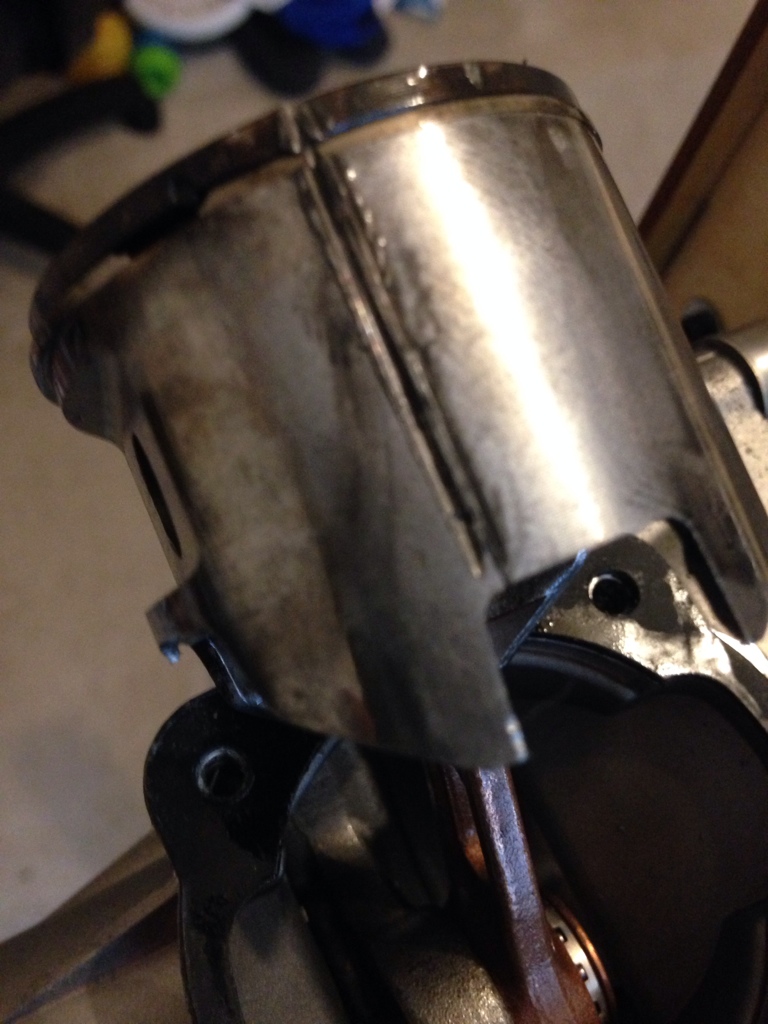

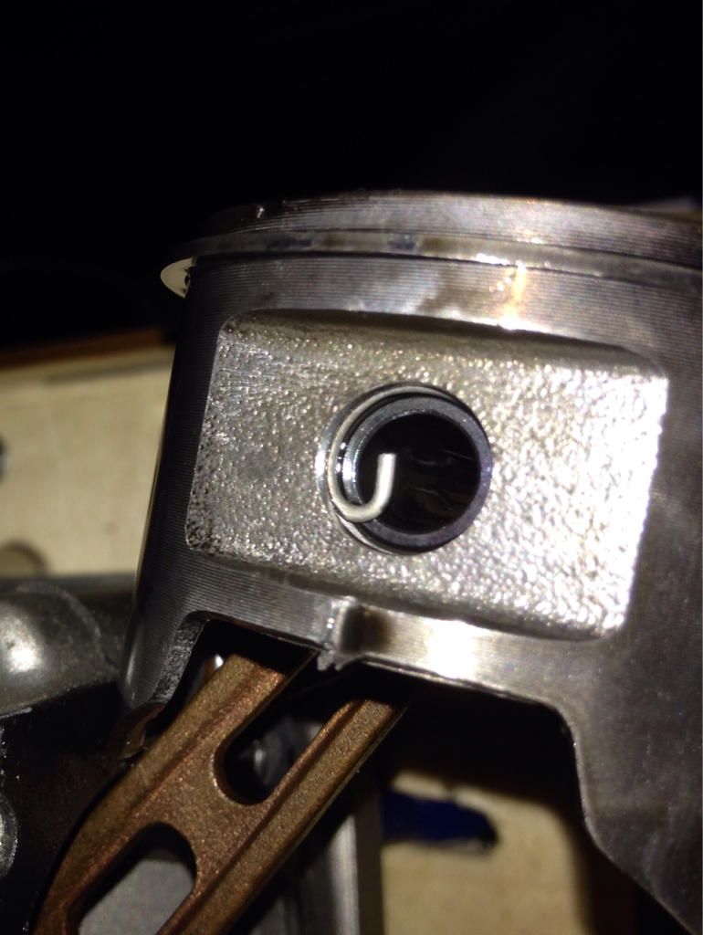

Found the reason for my deadstick the other day...
ImageUploadedByTapatalk1405349040.911021.jpgImageUploadedByTapatalk1405349049.711611.jpgImageUploadedByTapatalk1405349060.555246.jpg
Really bummed as this was a perfectly broken in and running engine
Already have the spare parts thanks to [MENTION=2452]Limitless Aero[/MENTION], so I should have it ready to run this weekend.

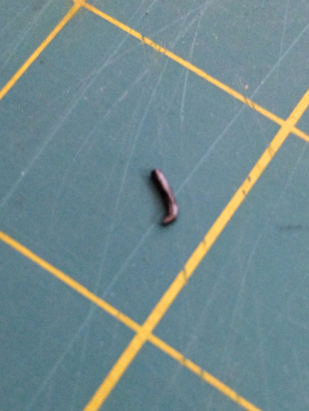

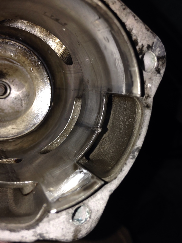

It's either a foreign object that entered the motor, or a piece of a failed piston clip, I'll know more this evening when I can look closer.
Well, as sad as I am to say it, I'm going to call this one an internal failure.

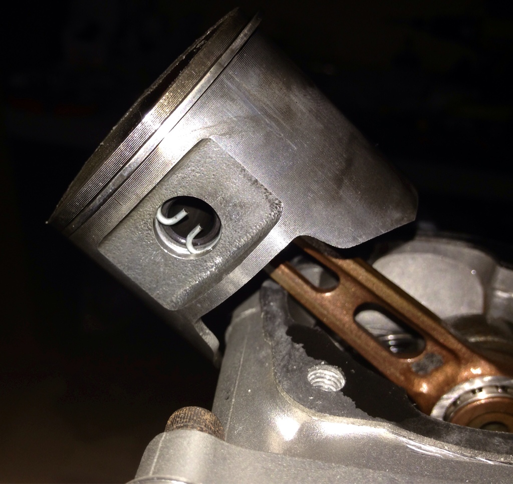

Complete piston clip on right side:
Failed piston clip on left side:ImageUploadedByTapatalk1405380992.224357.jpg
As you can see, a small portion of the piston clip broke off and caused the damage inside that made the engine seize in flight.

It happened to one other 61 in Canada as far as I know. So not a common failure, but we actually redesigned the clip to make sure it can't happen because the machine bent it a little wrong or something.
