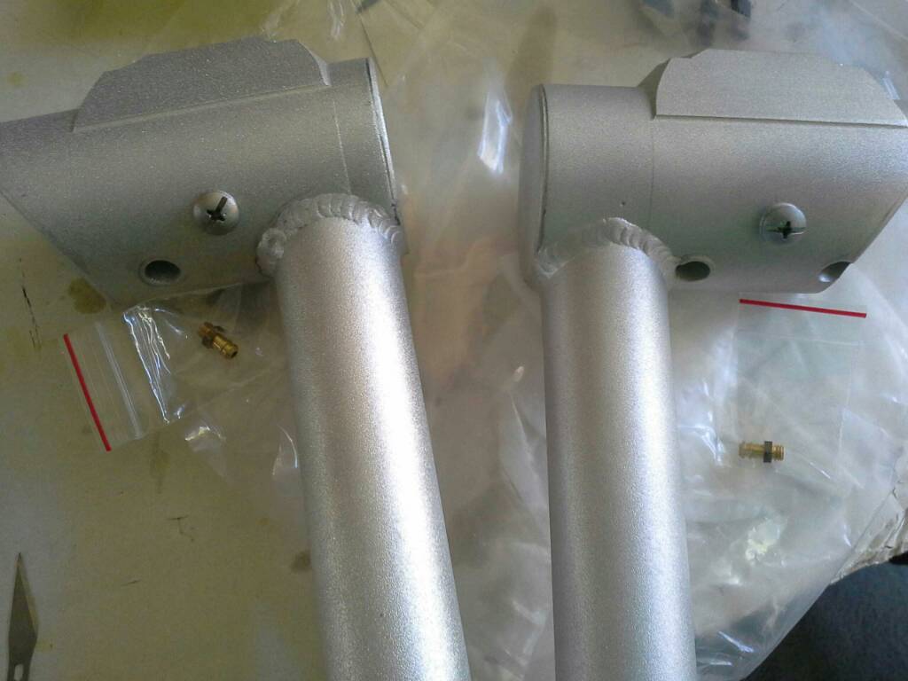

Looks like the mufflers come ready for smoooooke. Just replace the screw with the nipple :)

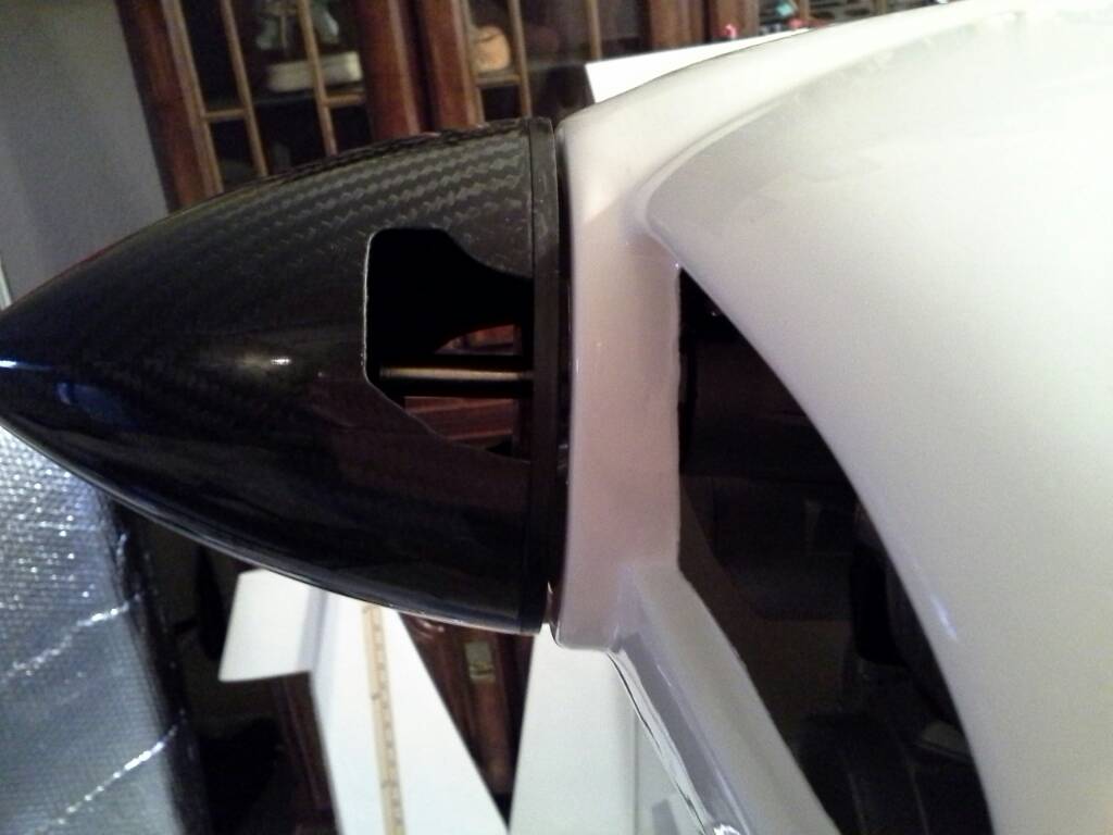

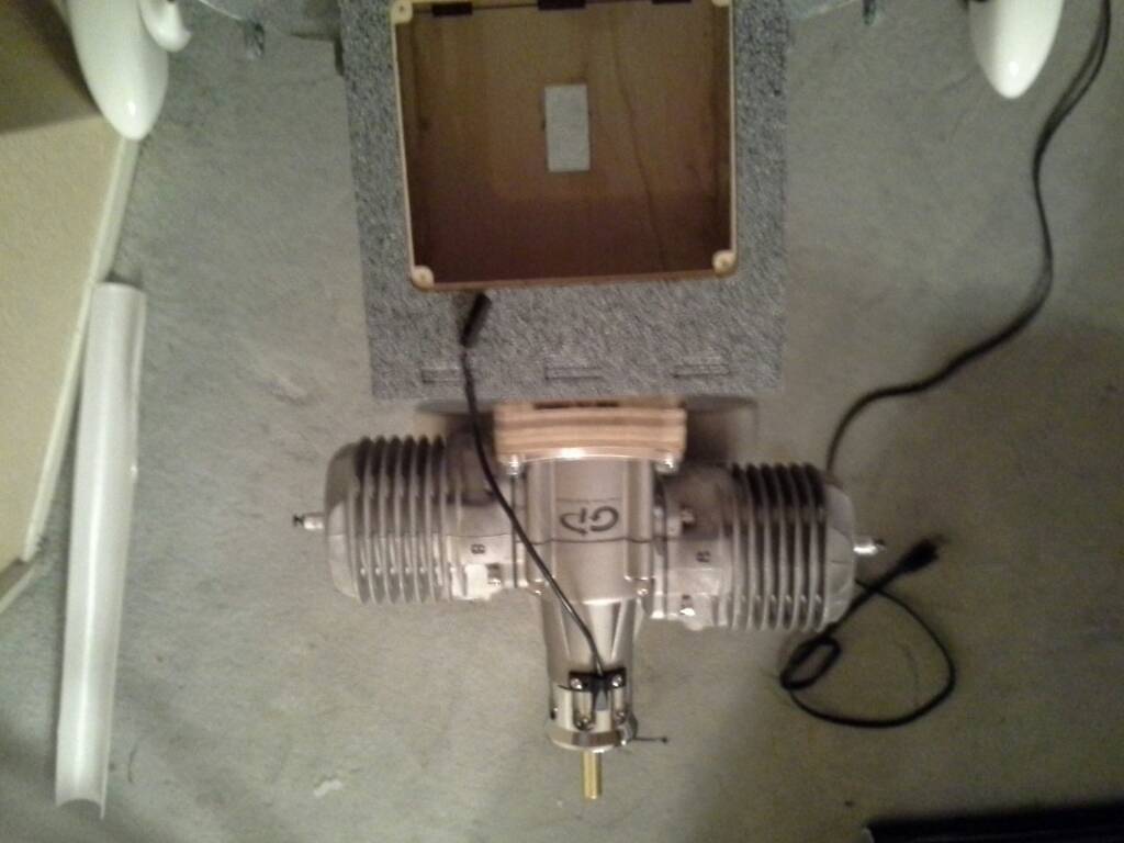

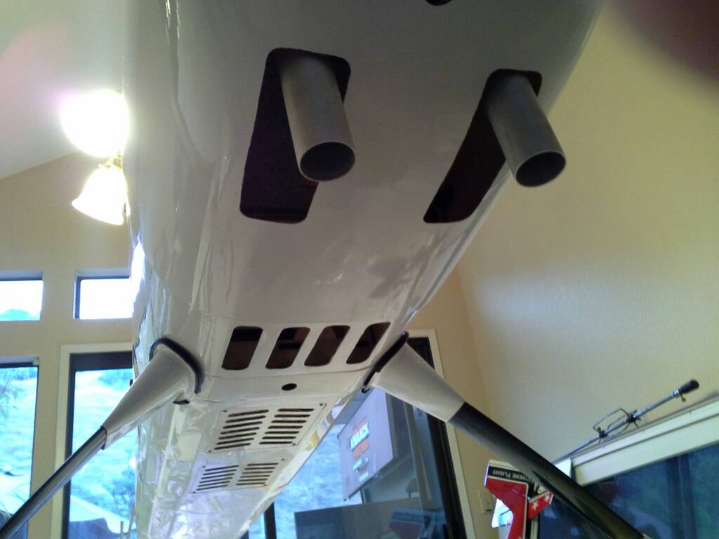

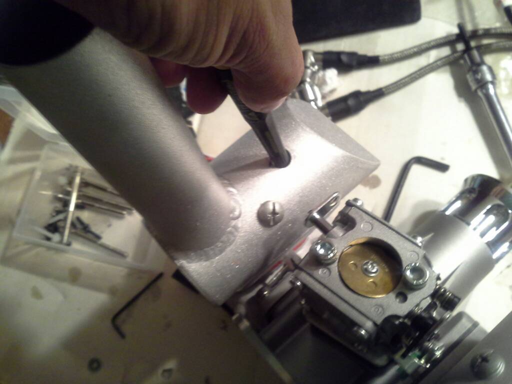

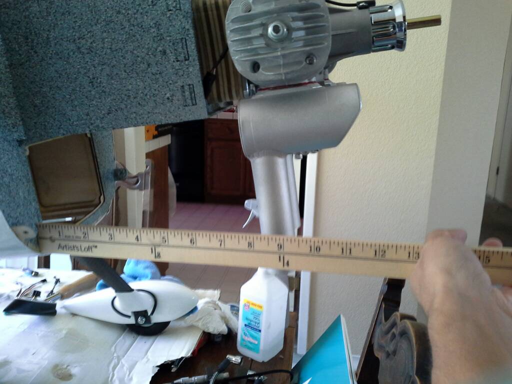

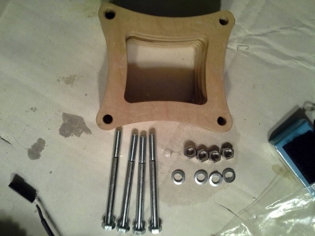

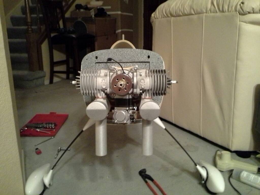

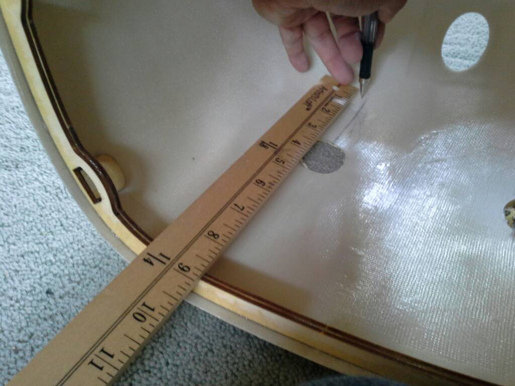

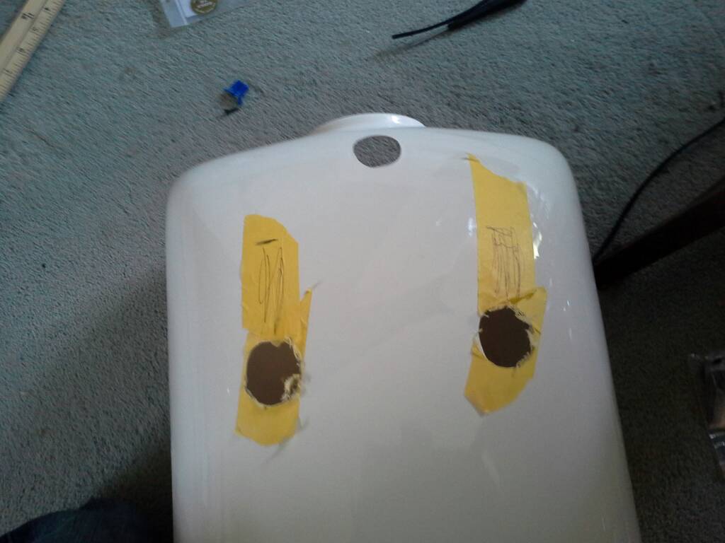

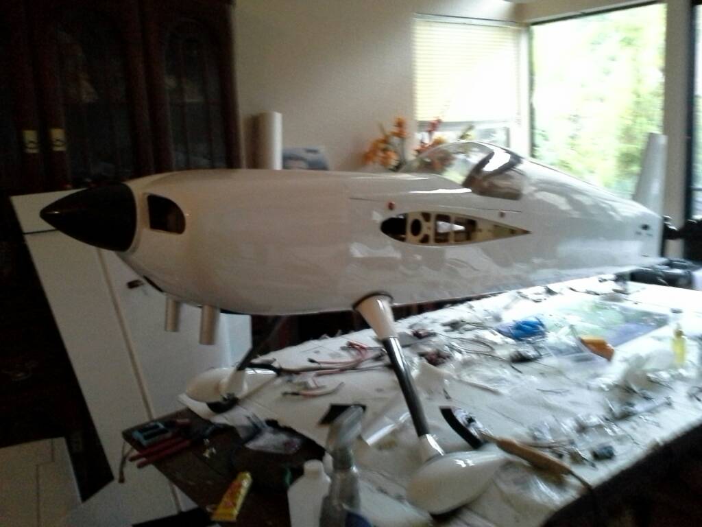

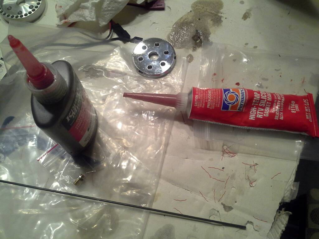

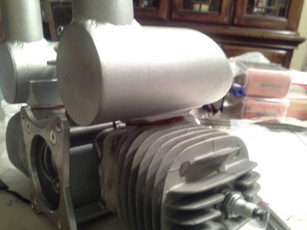

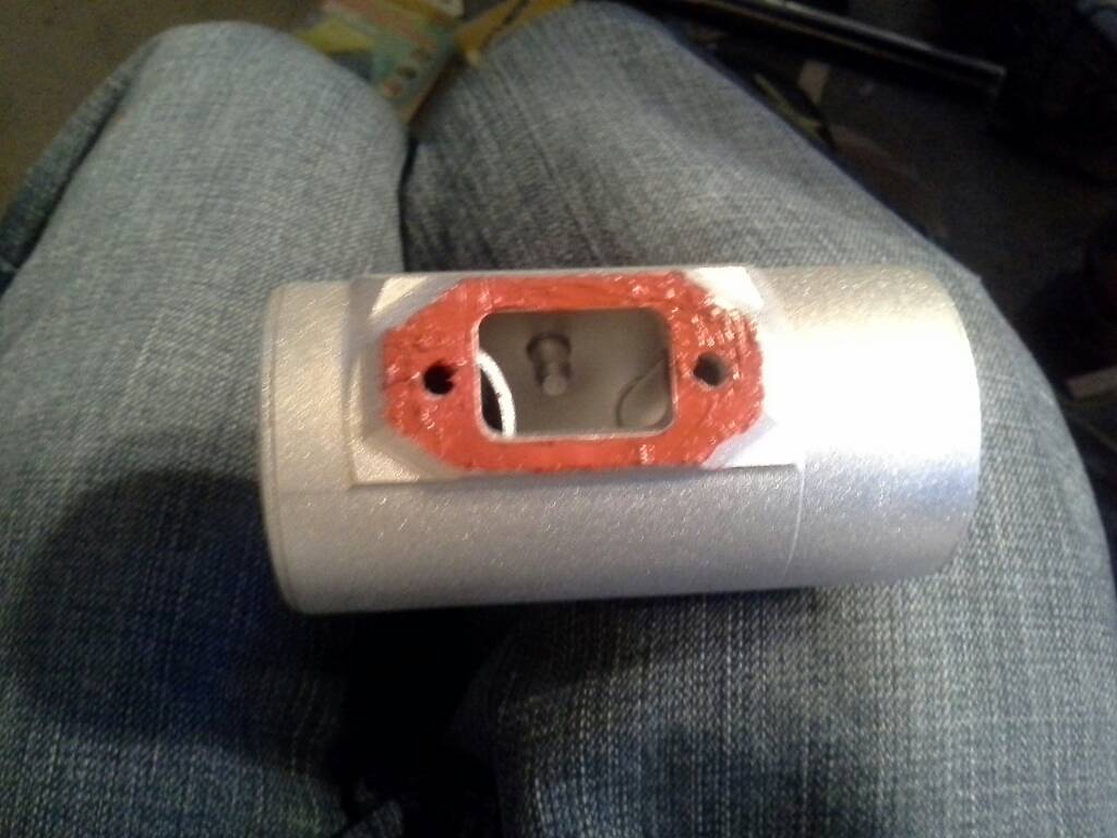

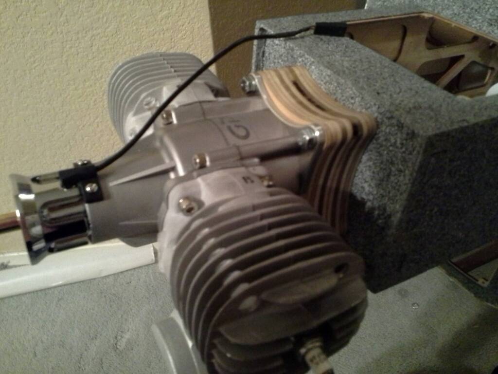

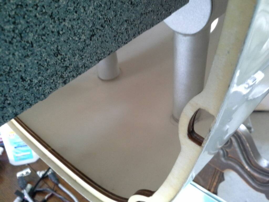

Got my GP-123 mounted up to my 120cc EG Slick. I used high temp red loctite on the muffler bolts and red rtv for the gasket to ensure a good seal. I used a wood mount from VitalRC for the standoff and a couple washers to get the right spacing. Got some M6 hardware, plenty of blue loctite, and mounted it up.
