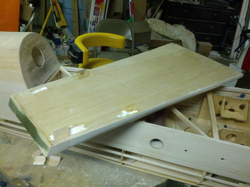

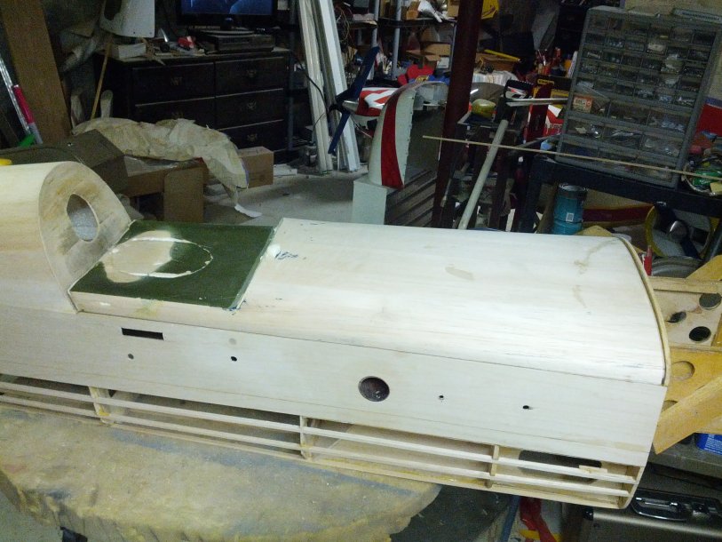

Thanks for the kinds remarks guys. Its been a fun project. Been working on the hatch. Used gorrilla glue on the hold downs and 6x32 bolts.

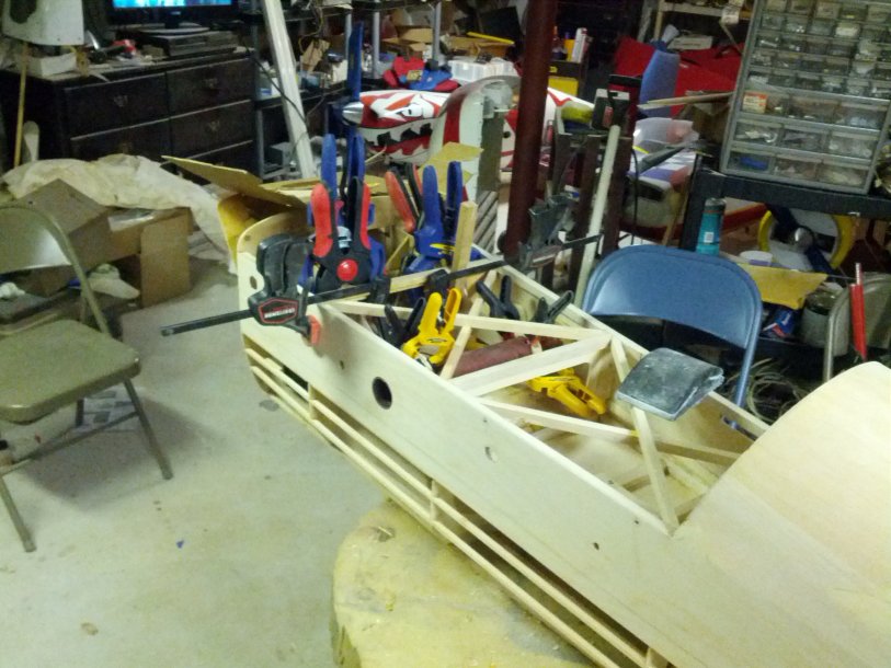

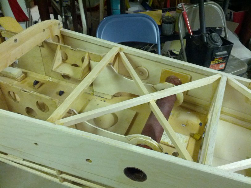

Been a while but I have been busy! On newer planes the motor box is connected to the wingtube so I added a 1/8th " plywood connection.
