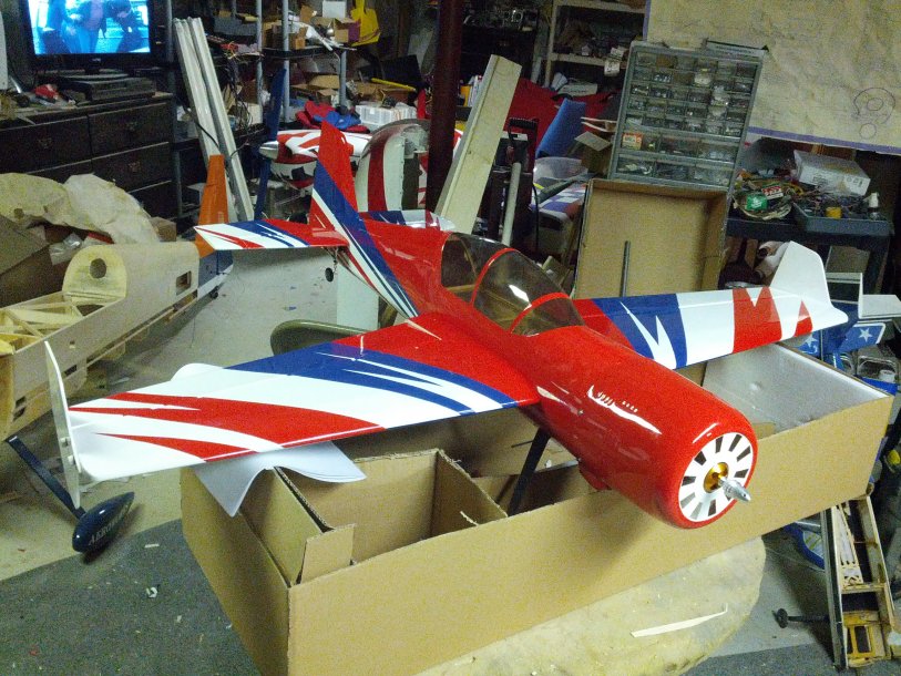

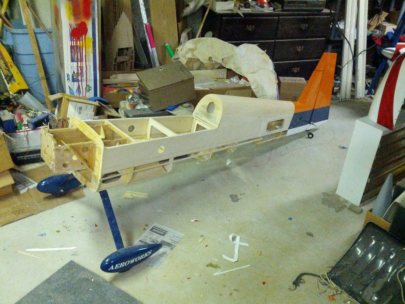

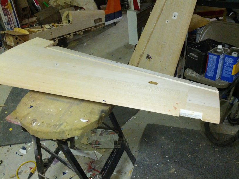

Here's some pics.from today. Got her on her feet! Started the wings.

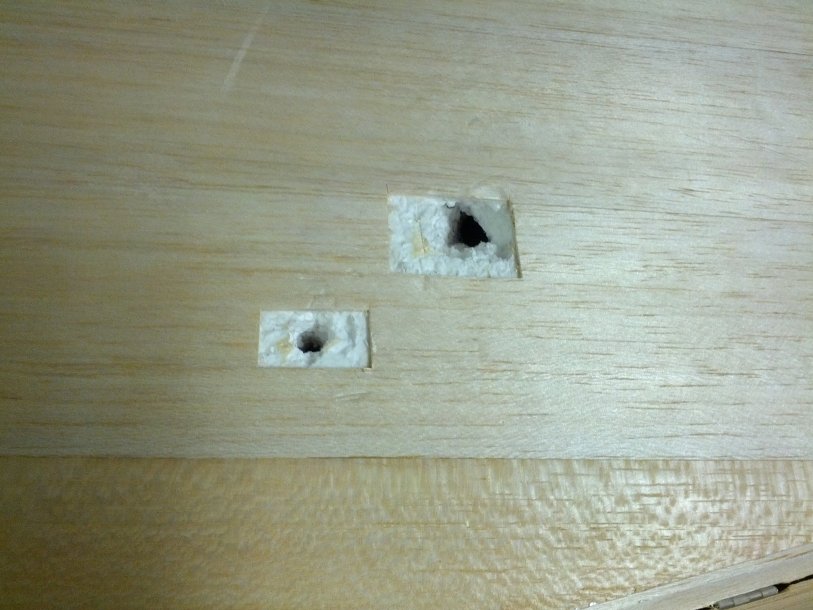

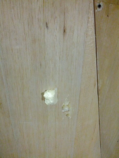

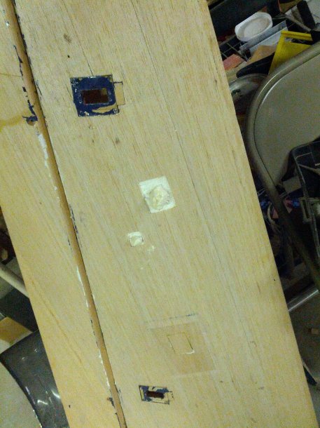

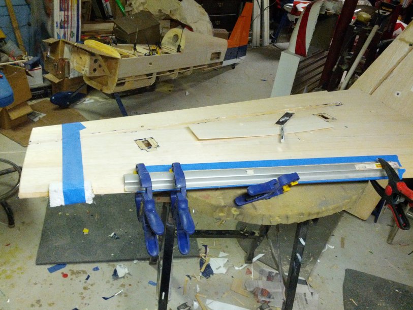

Got some more done on the wings last night. To fill the holes I use great stuff foam insulation.once it dries you just need to.sand it down to the old foam and sheet it.

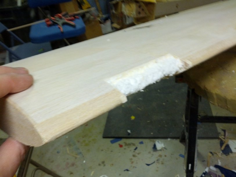

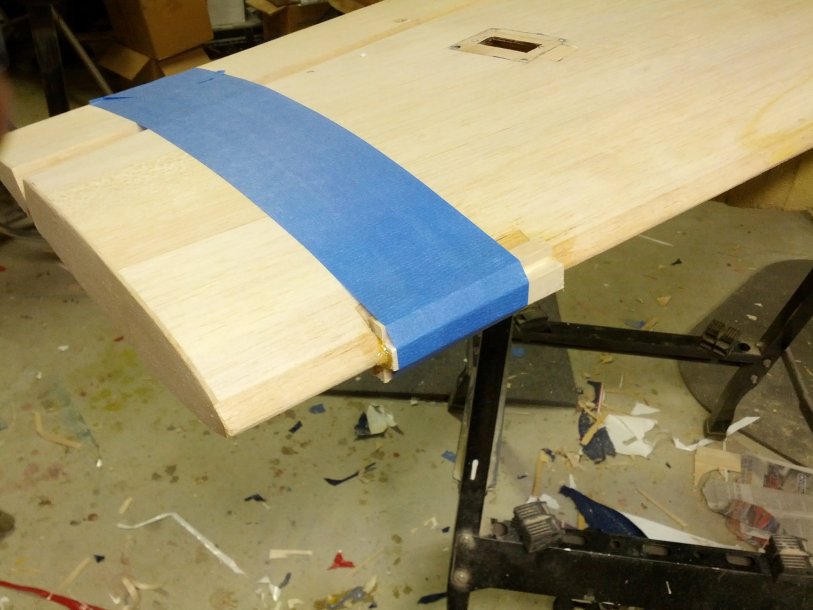

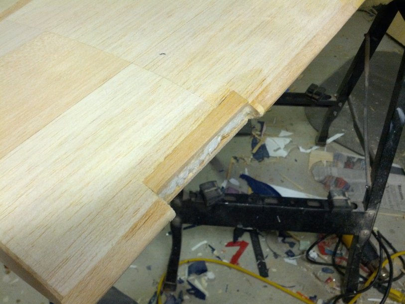

Here are some details of the leading edge repair. I use gorilla glue to glue the foam and wood.
