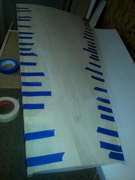

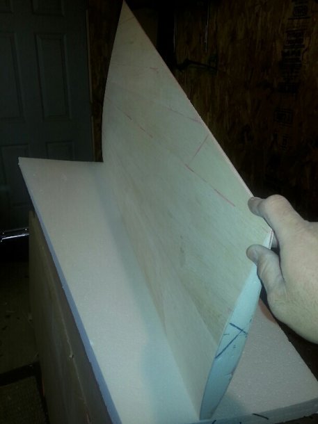

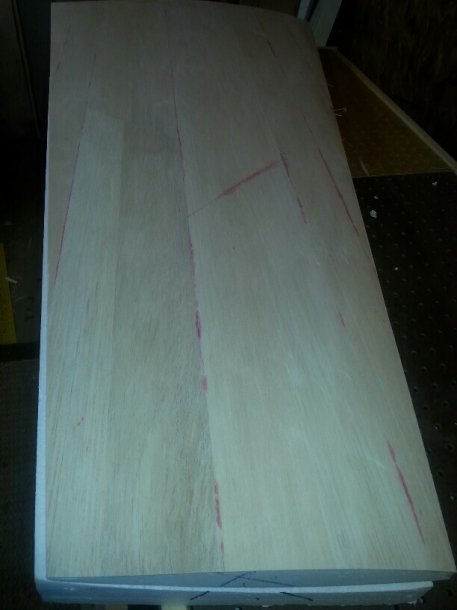

One wing sheeted and the leading and trailing edges glued on. If you build one of these make sure you have a few rolls of masking tape. I think I have used more masking tape on the plane than I have in my entire lifetime.
Haha so true. I went through a few rolls of tape and a complete roll of wax paper. Looking at yours make me want to do another one, I already miss the building and with one done now I know how to really do it better and faster.
Looks good:)

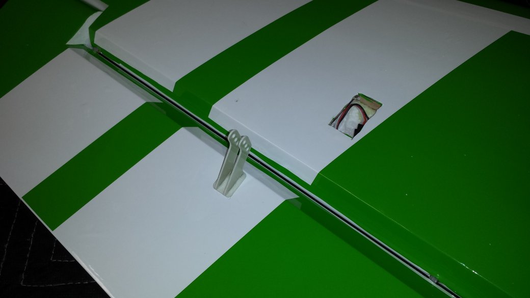

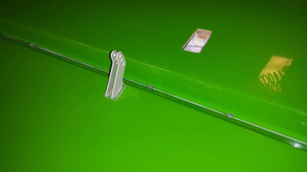

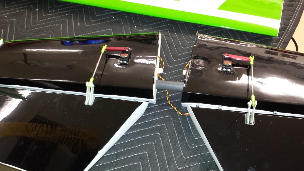

I installed the control horns. I used Pilot RC ones as I have dozens of them and they work very well for me. I like the three position adjustment. First I glued the Robart hinges with gorilla glue. I used 5 on each elevator, 6 on the rudder and 9 on the ailerons. For some reason I did not order enough pushrods for the ailerons. Thankfully a good friend had a some and he was looking for an excuse to go for a ride on his ne Harley anyhow so he dropped them by and I finished the ailerons tonight.
