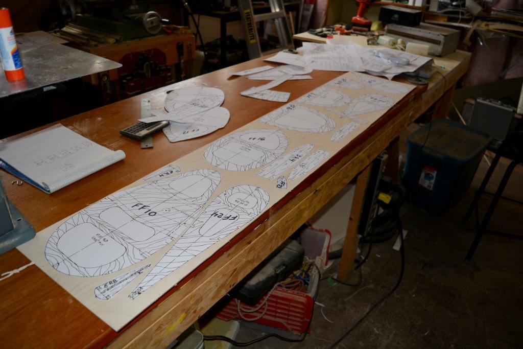

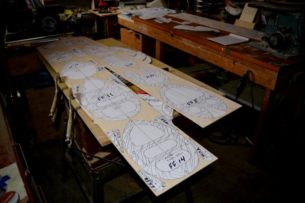

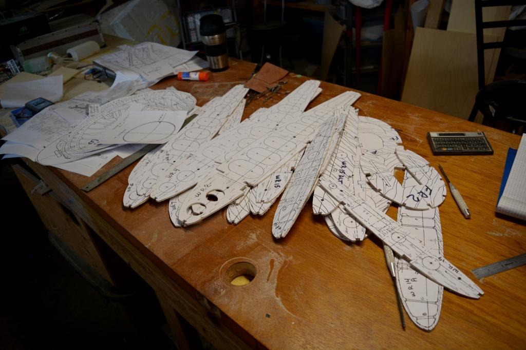

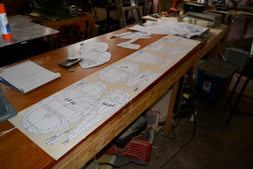

and more wood cutting and more to be cut, now I understand why so many people buy ARF's o_O

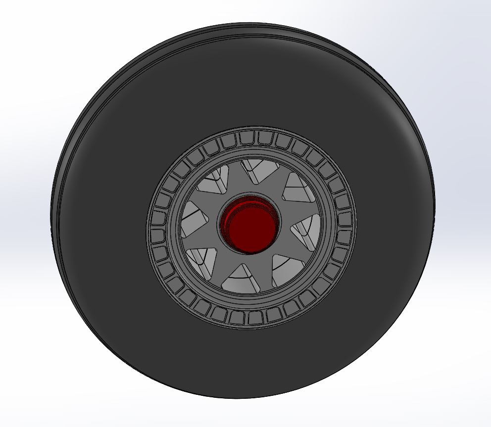

finished designing the main wheel, which will be in two parts, the front part as you see here, but the back side half, will have to wait until the brake system comes in , in a few days to assess, how I will proceed with the rear half, it has to fit and its Hydraulic from the same pump as the retracts, flaps, tail hook.
