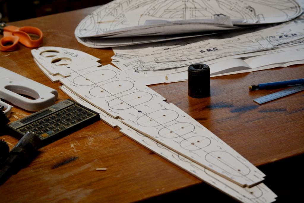

    Having some time in the shop before flying season arrives , which will be testing both the Laser and the Dalotel and also finishing the design and fabrication of a single stick for a friend

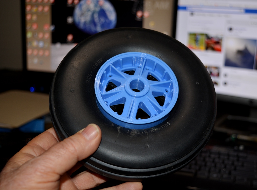

    designed and printed the nose wheel of the Tigercat, this is only a proof of concept, once please , it will be CNC in Titanium which is lighter then aluminum

    BalsaDust Moderator
    Nice work. Amazing what we can do wit h3D printers.
  7. Looks great, bet it will look even better in titanium!
  8. Snoopy1
    Snoopy1 640cc Uber Pimp
    6,635
    9,019
    Canada
    Titanium is very difficult to get. I was trying to get some titanium rods to make some threaded rod to mount a motor and was not able to find any. Where were you able to buy it.
    How big is the wheel you are holding.
  9. Forgues-Research
    Forgues-Research 150cc
    1,430
    2,132
    I mistakenly said it was going to be Titanium sorry but I meant Magnesium which is lighter then aluminum and a bit stronger,

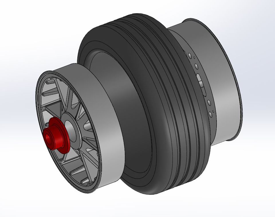

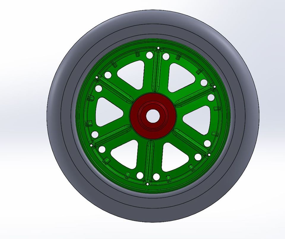

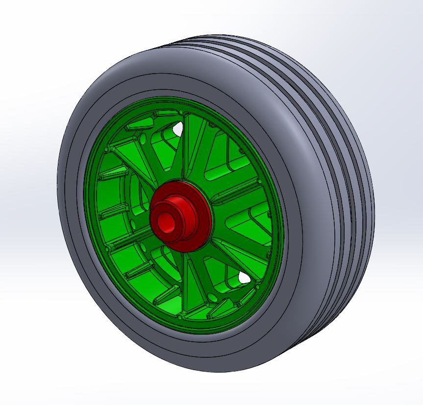

    designing the wheels, or should I say revising the drawings, to get a 6 inch outside dia of the whole wheel, the rim was enlarged and to keep the tire at the proper outside dia, I reduced the interior dia to give a more scale tire profile.
    The different colors, is simply to help with the drawings, the red part is the wheel bearing retainer 1.jpg 2.jpg 89341054_10158439604712139_3743527202096939008_o.jpg
