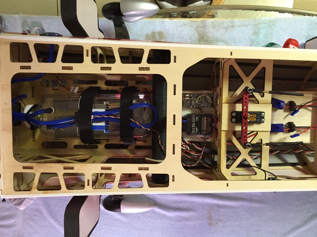

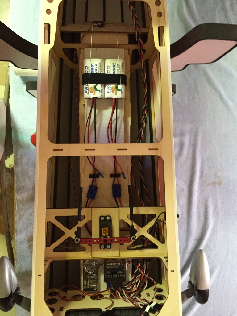

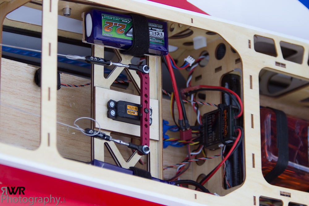

I mounted my Rx with both Velcro, and a zip tie. Here is a pic.

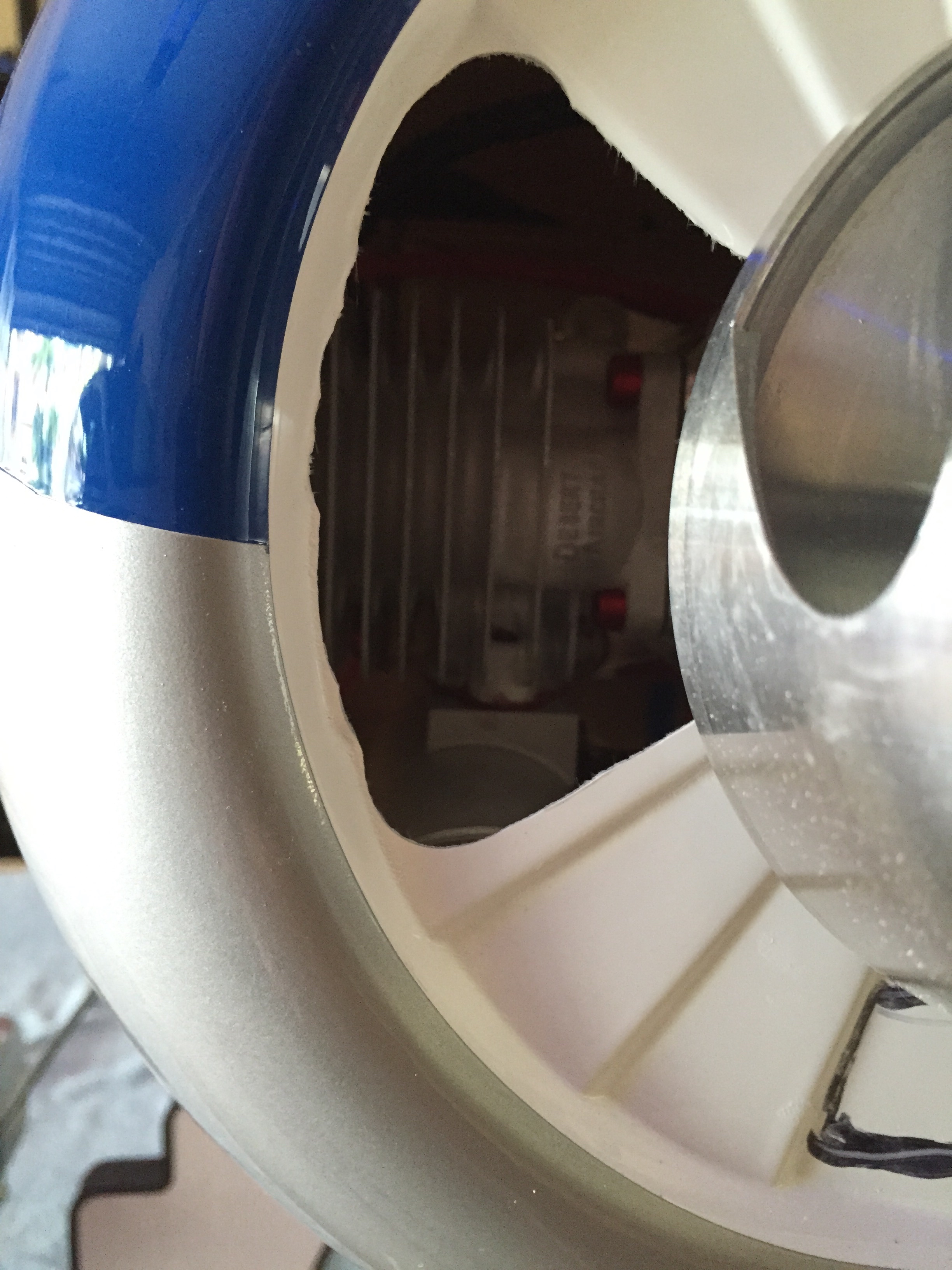

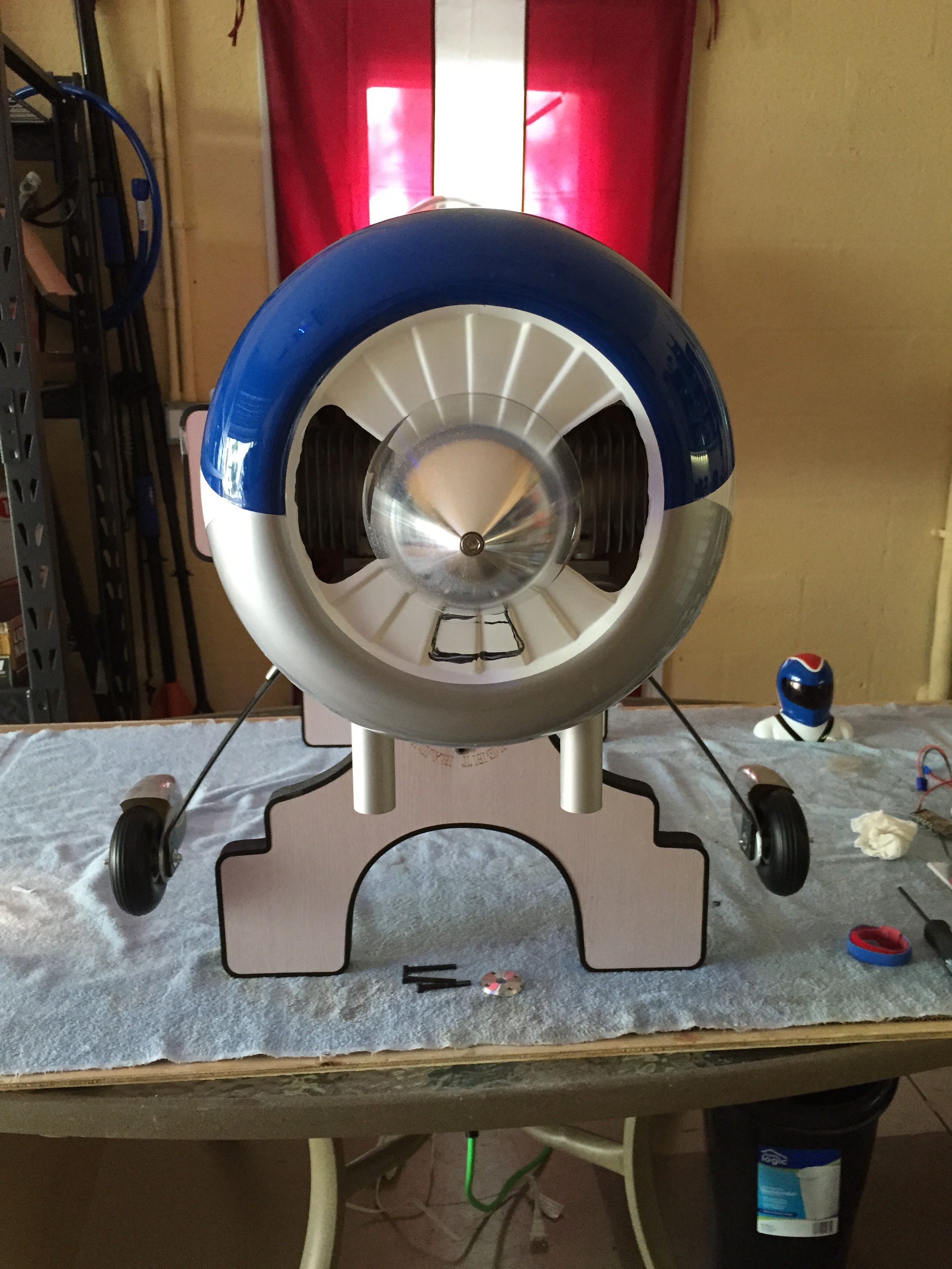

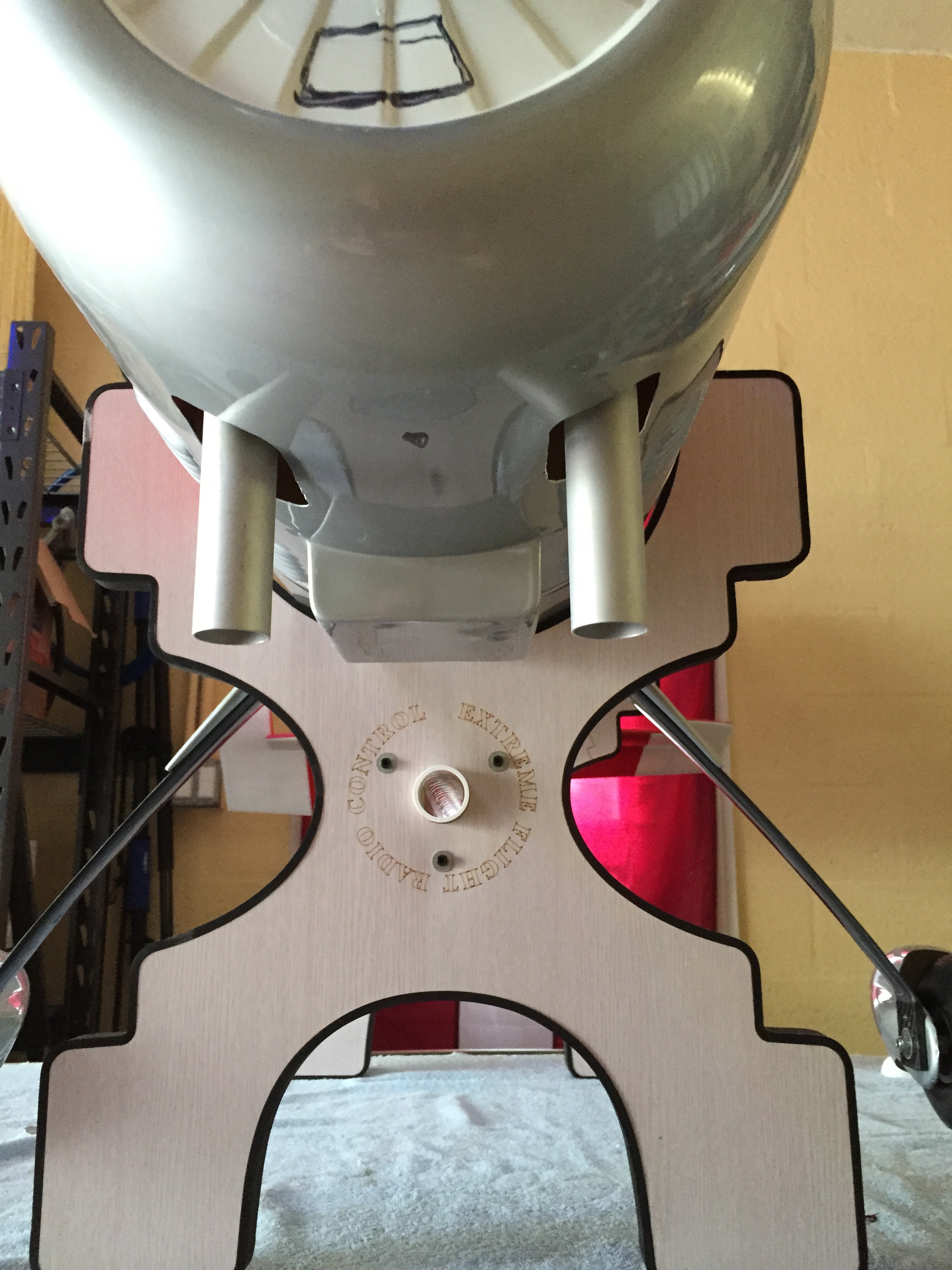

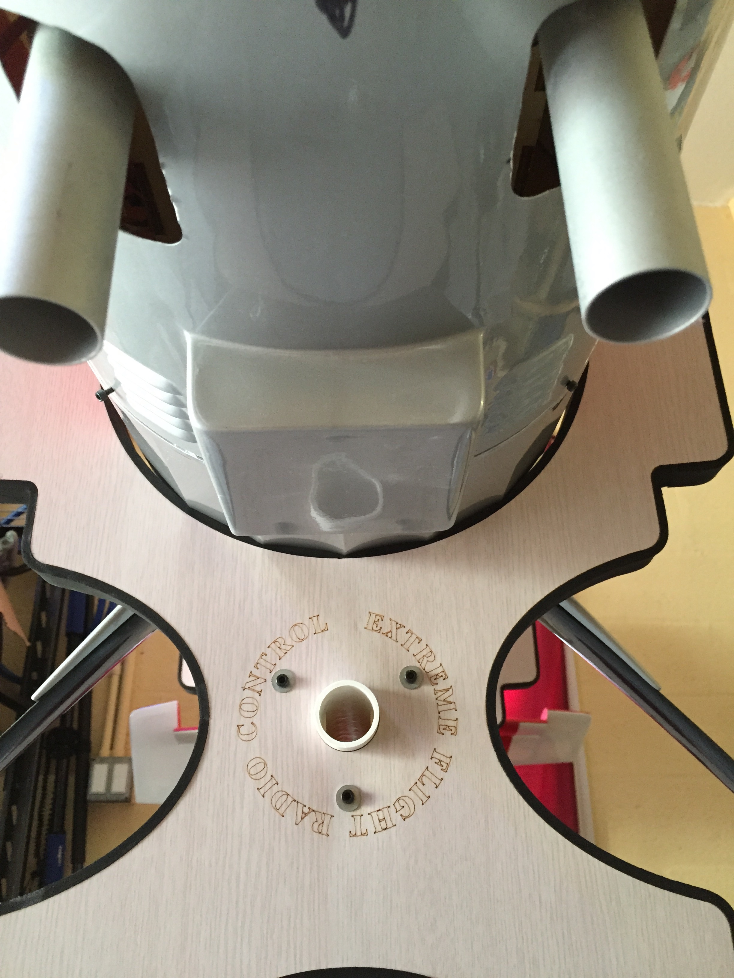

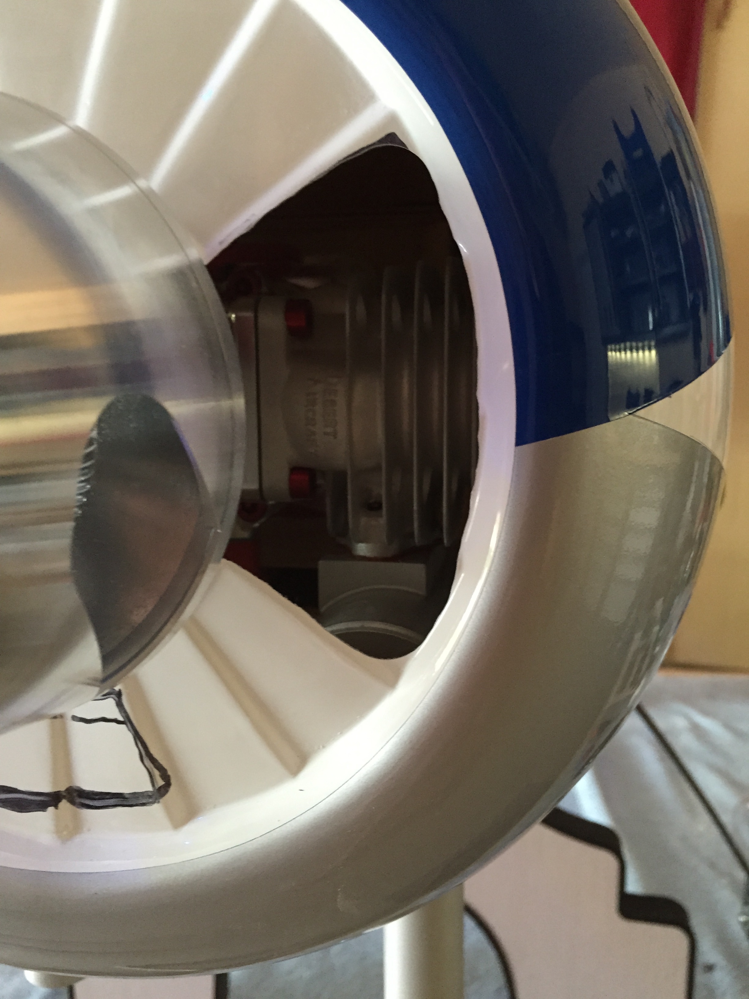

Airflow questions for you guys....
After making my draft cuts in the cowl, there are a few things I have to figure out:
- there doesn't seem to be enough air for the carb. Should I cut a small hole between the mufflers and under the carb to feed it fresh air; or cut a small hole in the fake louvers up front; or neither?
- there doesn't seem to be anywhere for the outbound air to flow. My thought is to cut out one of the last sections of the tunnel to let air flow out that way, but what do you think?
- do I have enough airflow over the cylinders?
BTW - I haven't cleaned up my cuts yet so they look a bit rough. Let me know what you think.
Dan
