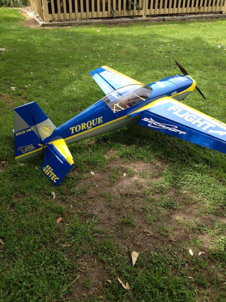

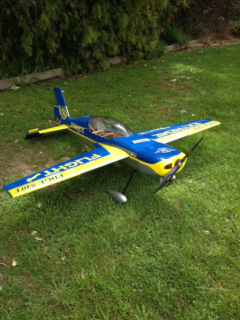

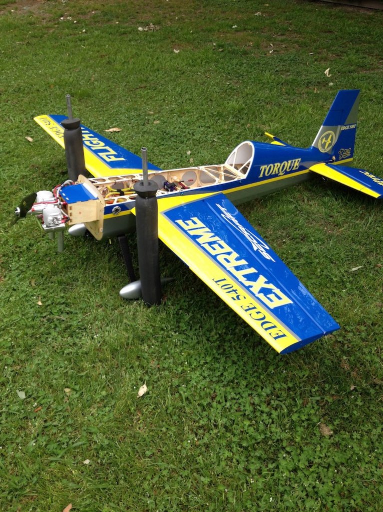

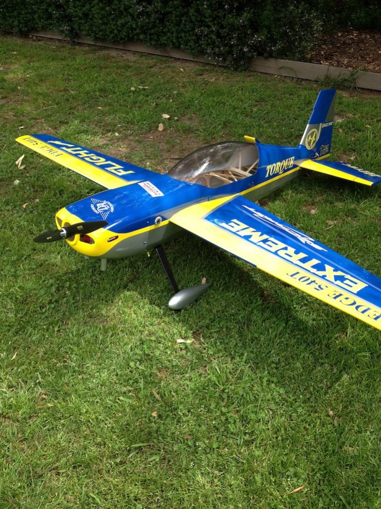

DA70 on the edge
haven't flown it guys, but a few pics and a video of the first start once its cooked from Vimeo.

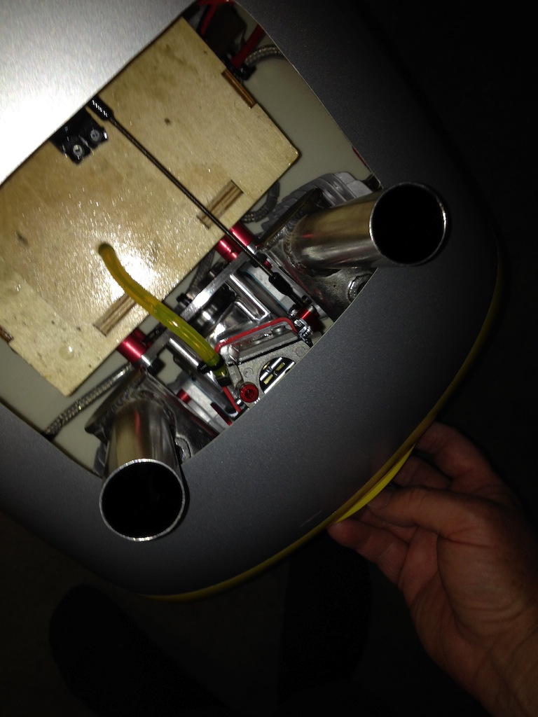

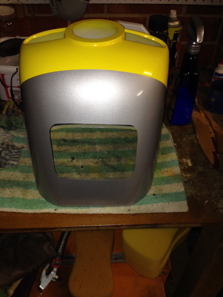

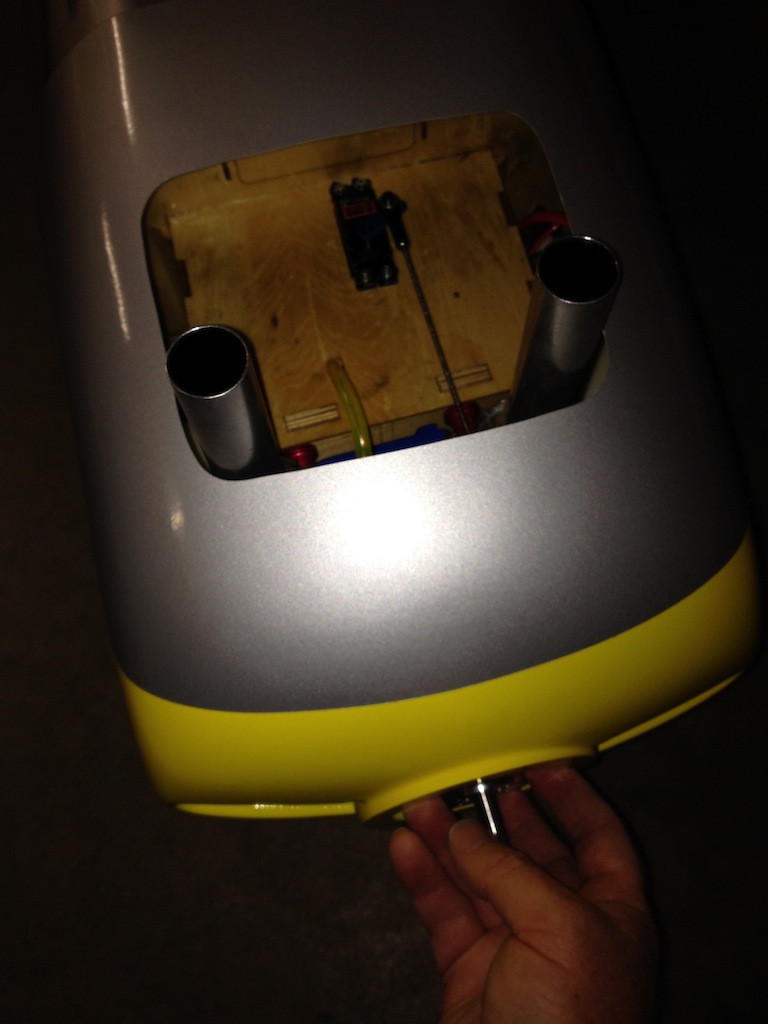

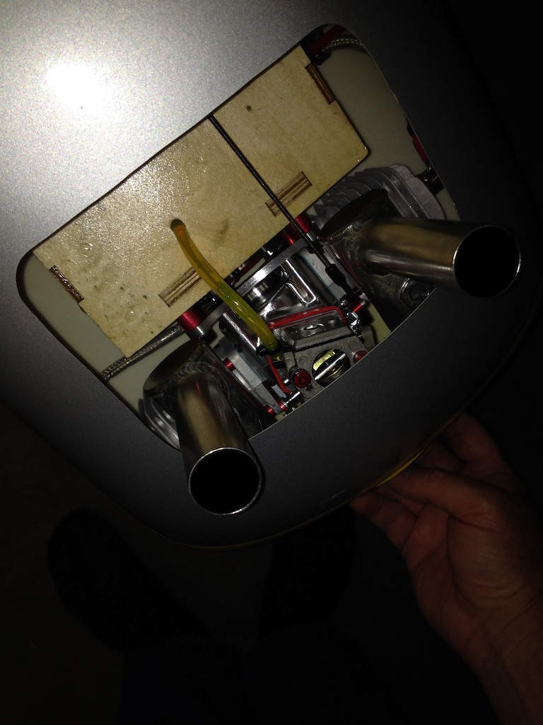

Sounds to me like the cowl might have some pressurization issues? Do you have a good air exit and such?
Bigroger
I think so.
See pics.
But no hole for the carby.
gyro
GSN Contributor
I think so.
See pics.
Hey Rog!
On cowls with really large openings like that, I've seen people put a little lip on the forward edge of the opening, as this helps create something of a vacuum effect to pull air entering through the front of the cowl out of the bottom/back
