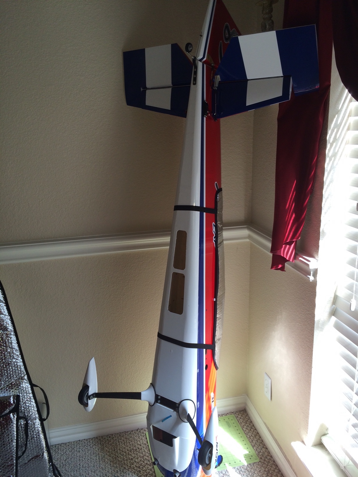

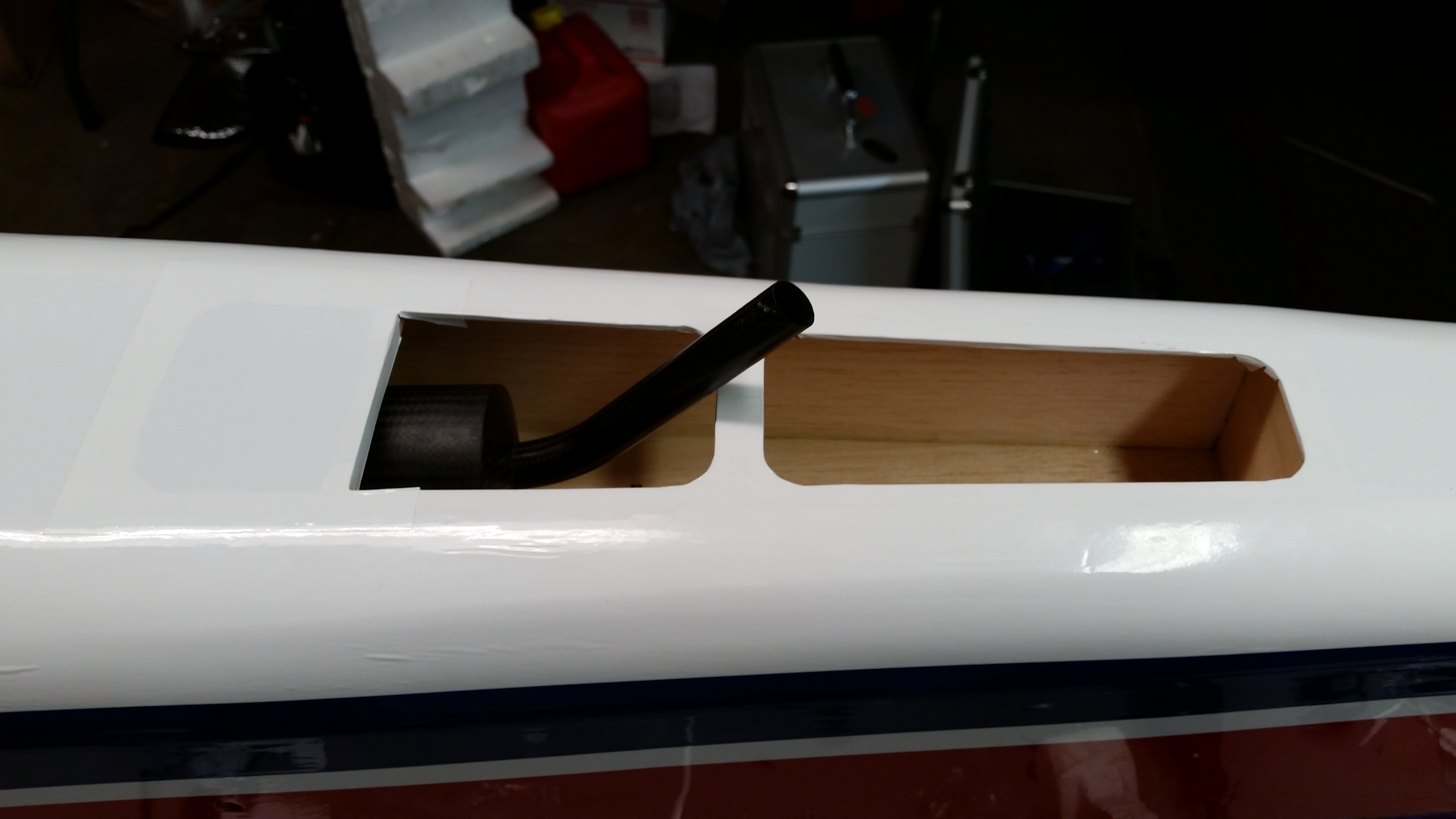

There is a boxed tunnel that runs a good length of the fuse. It's boxed off so no air can get in the fuse. I think I will make a plate there and use the diagonal crosses. Basislly all I need to do is measure the two round cowl opening, and double the surface area as an exit. That seems simple enough.
Ohio AV8TOR
Just Do It

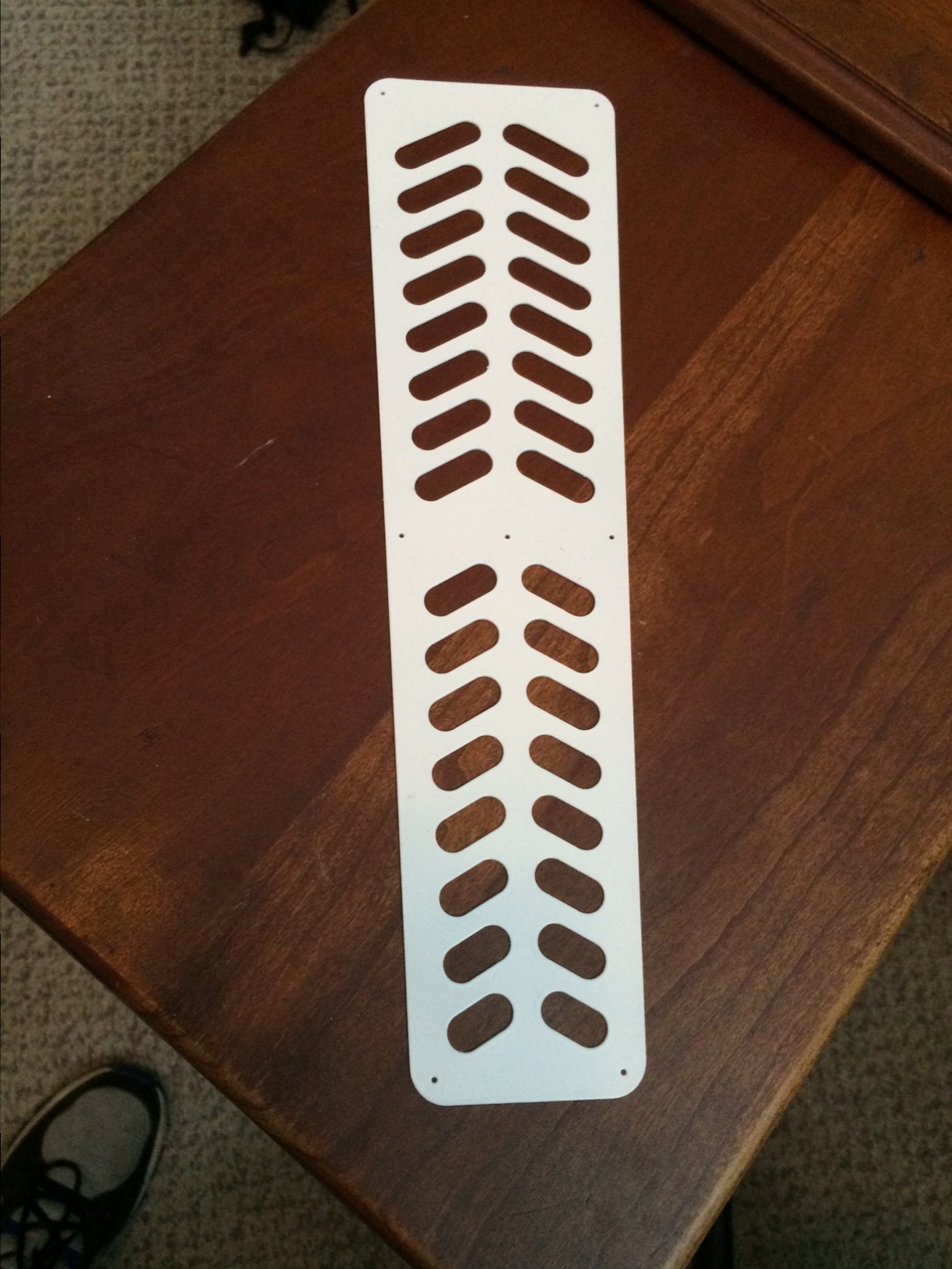

AK here is the bottom of my plane. If you do the math on the 3 inlets you will see that more is needed than just that lower cowl opening. I am going to wait until my VVRC40 is brok in and I have made this cover that I might put on over.

That cover is BA. Nice job! What did you make it out of, is that balsa sheeting with covering? That motor fits so much more nicely.
