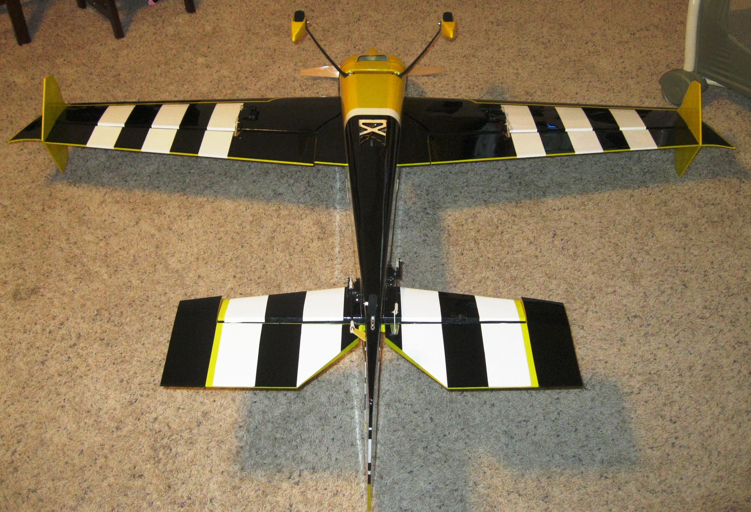

So I loved the look of checkers on planes until I got my MXS. Then I found at least for my eyes the pattern just blended in. I actually removed the checkers on my MXS and replaced them with stripes. I added stripes to the stab as well. Much easier to see.

So I slide ever so slightly under a corner a single edge blade just enough to grab with a tweezer and pulled back some. O also used a monokote heat gun but some experimenting with heat is in order. Just a little makes it come right off, too much heat and the covering color separates from the adhesive side. I started plucking the corner edge with my nail but it ends up putting a slight wrinkle from being stretched down. One word of warning, where the white ends on the ailerons you need to ever so gently take an xacto and make a trim line to cut because the white runs under the top color. It's not hard just tedious but the reward is great.
Here is the result on mine. I also added one strip on each stab as well.

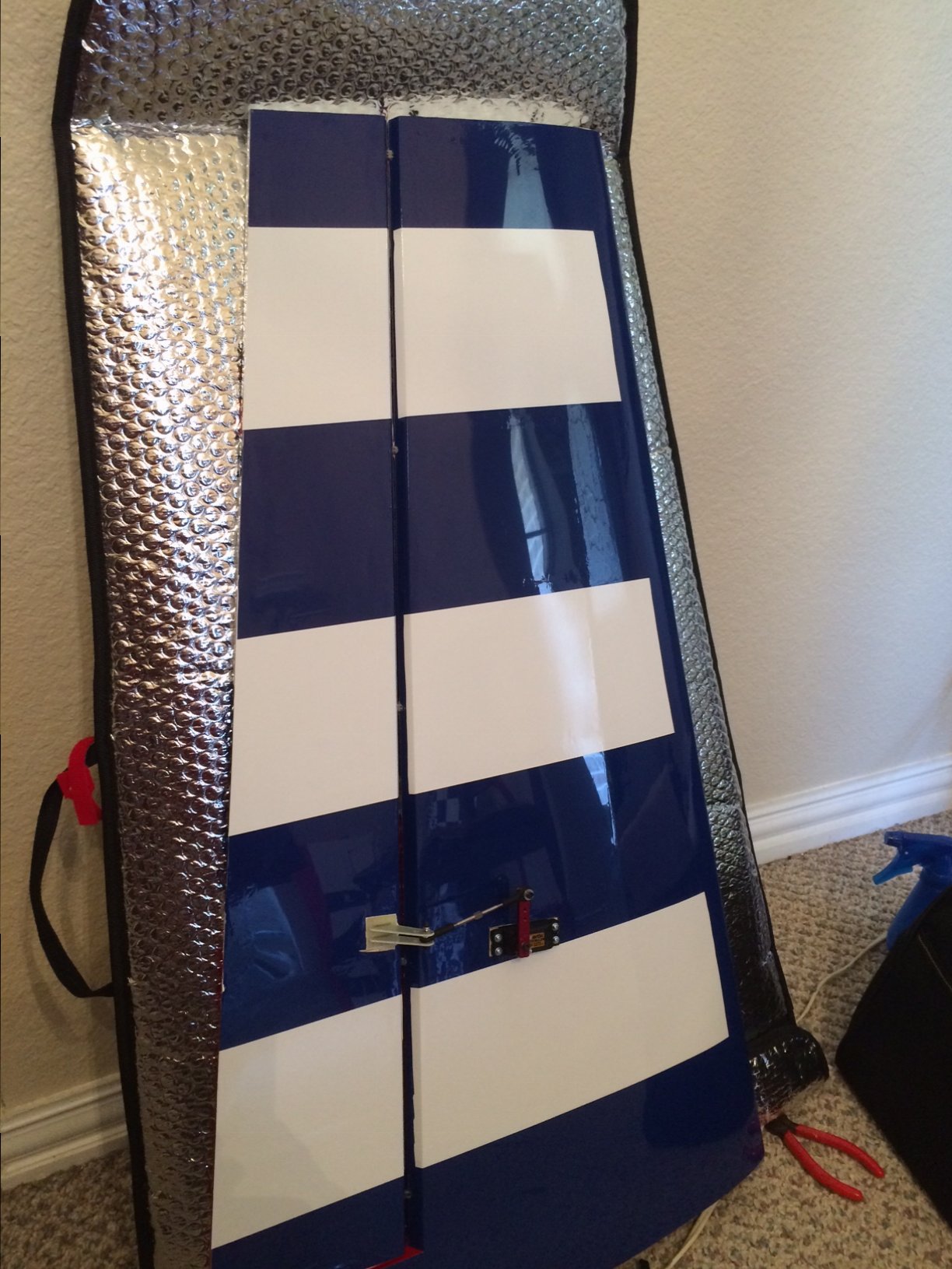

I wish we lived closer so I could get schooled. Was there any glue residue from the checkers? If so, what do I need to remove it? I like the stripes, but I lice the long rectangle checker look from the bigger EF, and a Hangar 9 35% extra. I have lots of work ahead so it seems. ;?

There was no residue of adhesive other than the first that I heated too much, then a clean rag with lacquer thinner cleaned right off.
