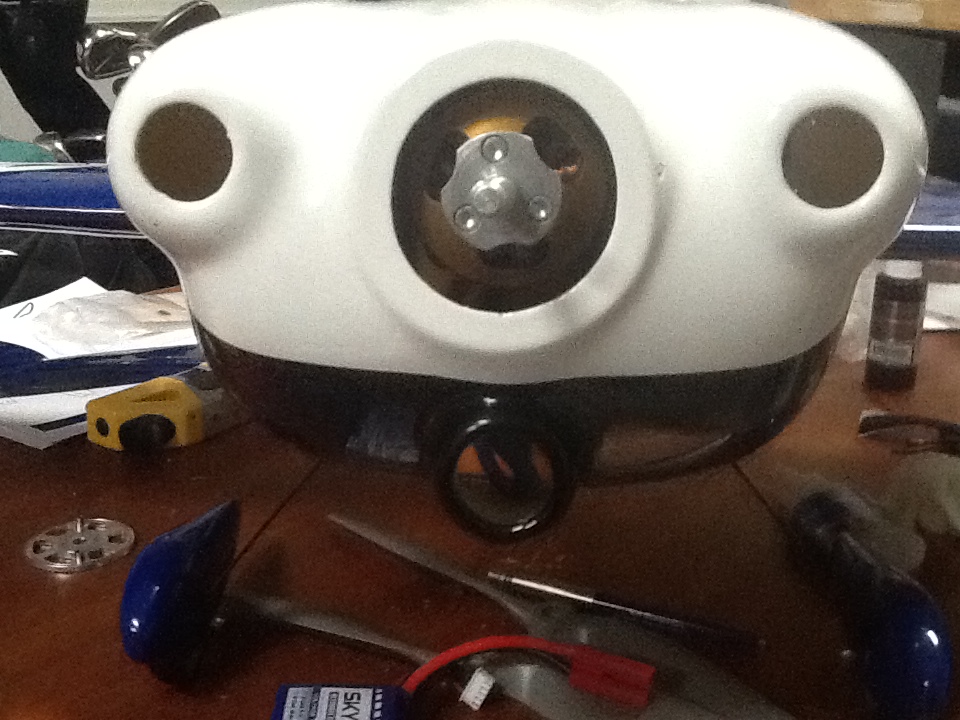

I got this airplane a few months ago, and absolutely love this airplane. The build was very straight forward. The only complaint I have is that the motor mount accommodates the recommended torque motor, and that motor only. I can't afford that, and I had a spare motor laying around, so I had to shorten the motor mount quite a bit. Other than that, I love it!

One thing from above that I disagree with is about the motor options. I ran both a SunnySky from BuddyRc and a Motrolfly from SubsonicPlanes..... And they both fit with no firewall mods. Didn't even have to make new holes, they mounted fine to the stock blind nuts.
I once had to mod a motorbox...it was on a Sebart Sebach, which had a cage mount, and I moved it back so I could mount a Motrolfly on it.
I'd be interested to see how you did your modification.
3dcarter
I just cut it right in the middle, about 3/4" total cut out. I then glued it back in place and fiberglassed the bejesus out of it. Still a great flying plane though, and my dog loves to chase it around
SnowDog
Do you have any issues with cooling of the motor? Since the middle hole will be covered by a spinner, the two outside holes would seem to channel air "around" the motor...what kind of motor temps are you seeing?
3dcarter
[MENTION=2]SnowDog[/MENTION] the plane actually comes with some baffles that go right behind those two holes and direct air over the motor. Nice feature by extreme flight.
SnowDog
@SnowDog the plane actually comes with some baffles that go right behind those two holes and direct air over the motor. Nice feature by extreme flight.
wow - now that is awesome, I did not know that! that is an excellent feature! thanks for letting me know!
