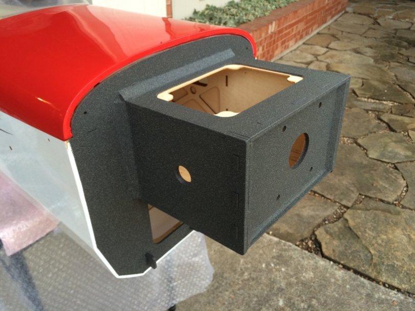

Not much but I was able to start the assembly of my Extra this evening. Drilled the mounting holes for my GP123 and then painted the motor box area. Probably won't get much more done this weekend as the weather is going to be nice for flying.

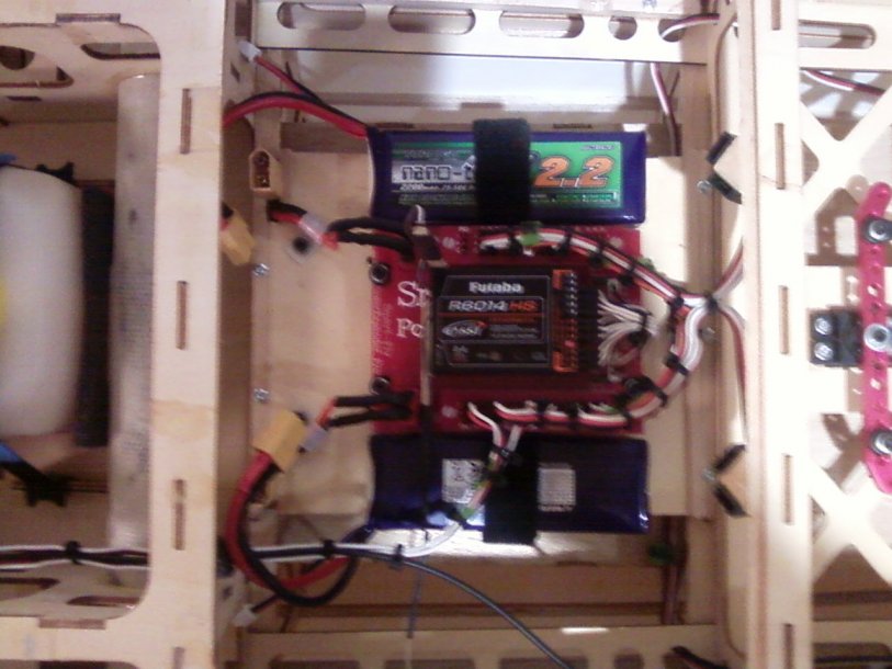

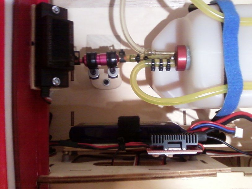

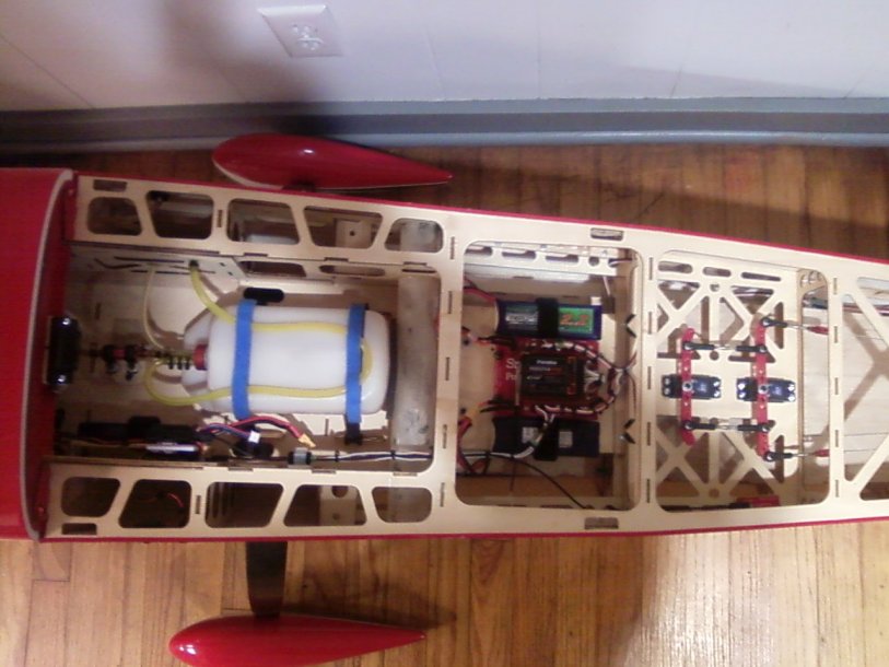

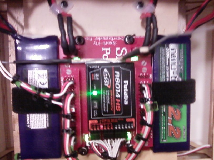

Receiver batt's (pig tail in pic with tie downs) are just behind wing tube. Ignition battery where the cowl starts.
Using ProFlow front dump cans.
Did you mean Rex or me? will get better pics.
Did you mean Rex or me? will get a better pics.
I meant you. I'm trying to get an idea where to mount my batts. With your setup I would have thought mounting the batts near the front of the gas tank would be better. I'm thinking right near the wing tube for mine. Stock exhaust. I'll temporarily mount the batts for the first time out. Then tweak them from there. Once I find a good spot I'll permanently mount them.
That's the best thing to do. When I flew it with out the pilot and deck it was slightly nose heavy at the end of the flight and would glide just a little hotter than I like. Where I have it now I can land it with all power off and it slows very quickly for minimal roll out.
Even if you are using in cowl exhaust or cans the rx batteries are ending up in most... either just in front of the wing tube or just behind it.
I opted for lighter little less capacity lipos. At 2200mah x2 and 2200mah on ignition I can get a good four 12 minute flights with all packs still over 1000 mah. I finally weighed mine and with the added weight of the pilot and deck, engine ducting, cans, I am at 28lbs 3oz. Flies exceptionally well but I think some guys are cutting out the pipe tunnel and going minimal and getting it down to 26 lbs or so.
I think you are really going to be surprised and "extremely" happy with it. Best of success to you.
