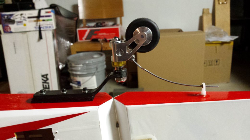

I put a J&J on mine right out of the box. You can just use the bushing that comes with the stock setup no problem. I did a little mod on mine to get a little more distance between the rudder and the ground. I CA'd two balsa plates together and coated them with CA. Then painted it black. I used a polyurethane spacer I had sitting around.
The tiller is the easiest way to go. Also I prefer the better steering control.

My tail wheel assembly is getting a little tired and old so I'm looking for a suitable upgrade. I've checked out J&J and WRE already and man they are nice!! I'm sure there are others as well so if any of you guys have any suggestions of what you're using or have used in the past let me know. Also if you have any pics I'd like to see them.
I think this is what I'll be doing.. Thanks for the pic.
