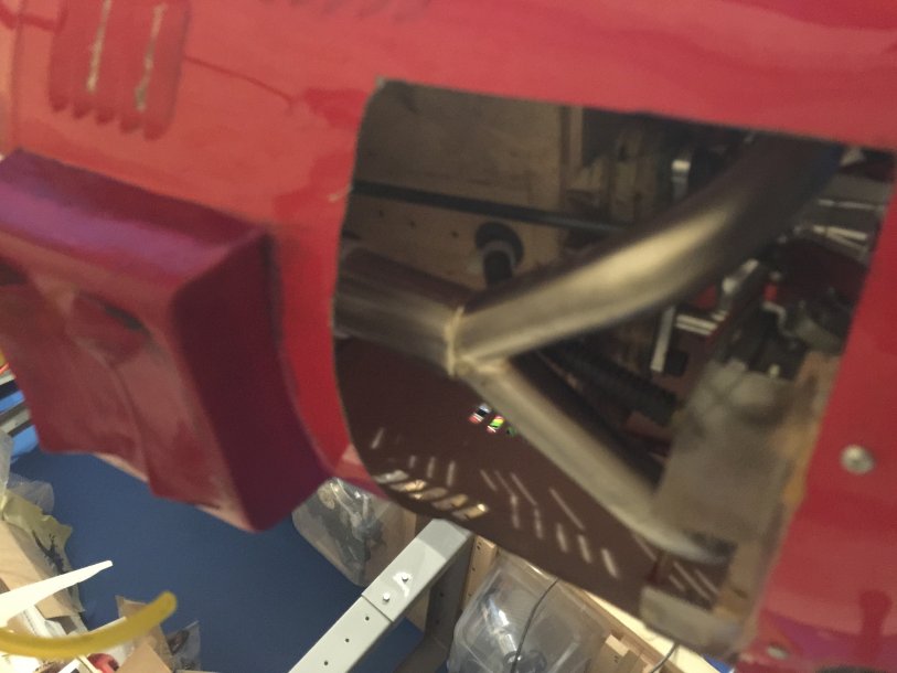

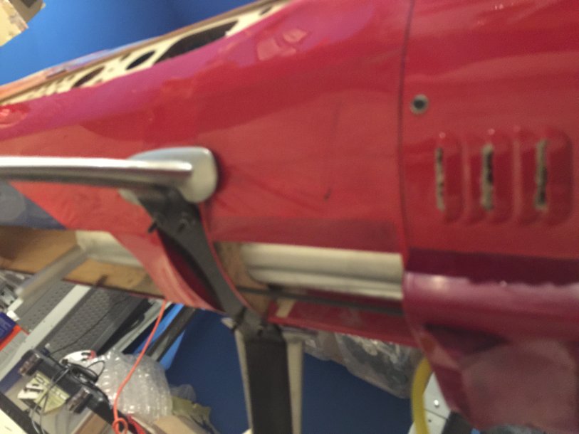

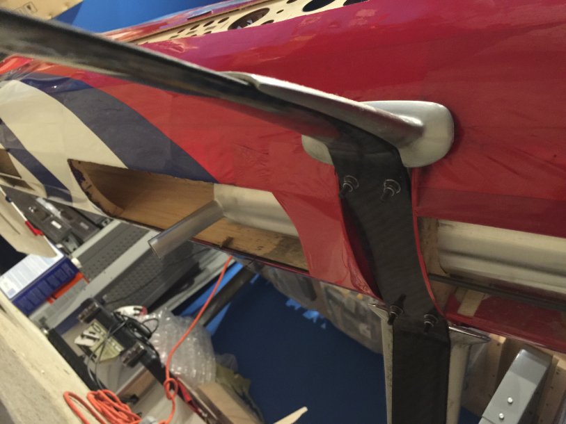

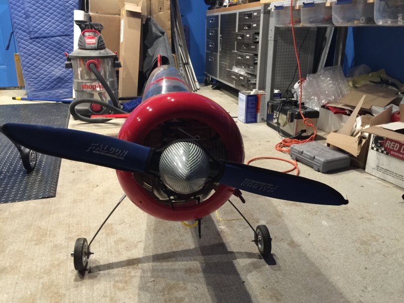

Was able to open the front of the cowl last night, and i also installed the MTW 110 H canister with the 2 in 1 header.
Maybe today i will get to fly it.
I will post telemetry temps...
I was able to get her airborne today, and wow!! she is one quiet bird!!
The 25 x 8 W prop was turning, peak, 7110 rpm.
got temps also, once i get my Tx, i will post those as well!!
