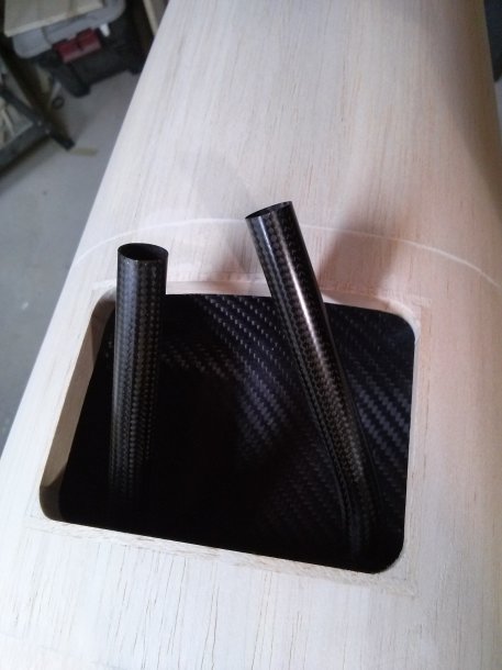

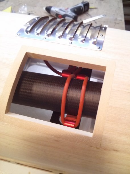

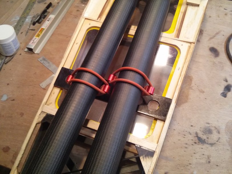

I haven't had my pipes in for more than half of a summer, so longevity is yet to be determined. But I do like their performance and sound. I used TBM's mount. ES only recommended one pipe mount.
I've used the TBM mount and I really like it. The last time I checked they didn't have any of the silicone O-rings, but I found some a McMaster Carr if you ever need any.
