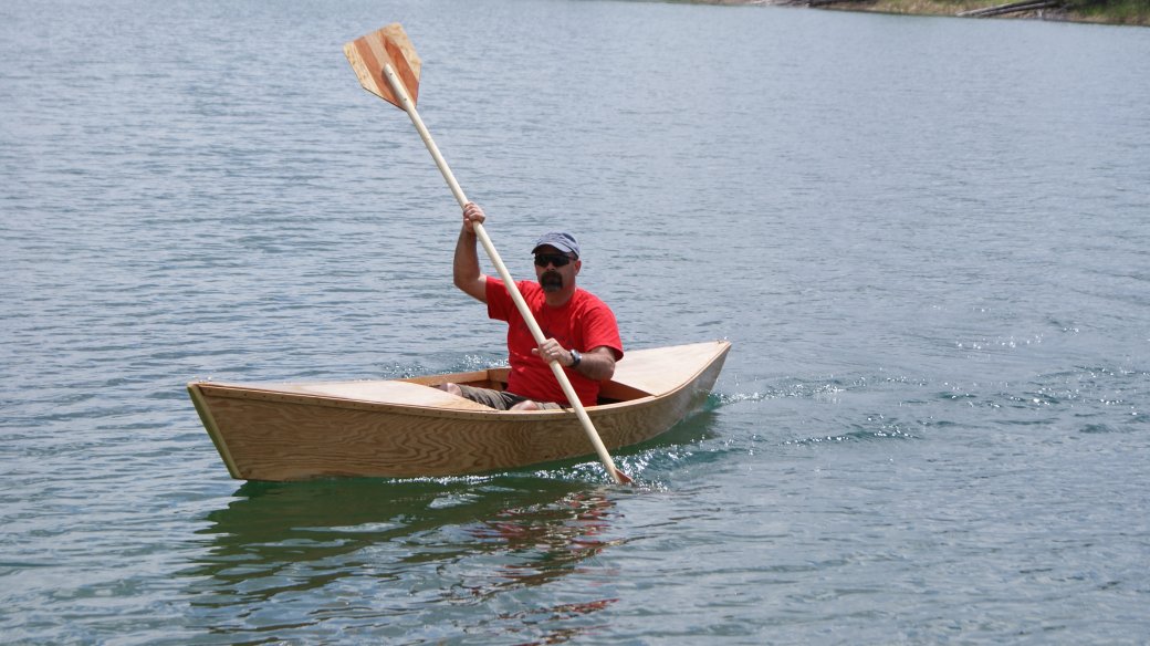

I build wood boats and stand up paddle boards for another hobby and mix up fairly large batches of epoxy for glassing the bottom and "painting" everything else. I use the plastic margarine-type containers and Popsicle sticks for mixing. When I'm done, I let the remaining epoxy harden for a few days, then just flex the bowl and the hardened epoxy pops right out and the bowl is ready to use again.
