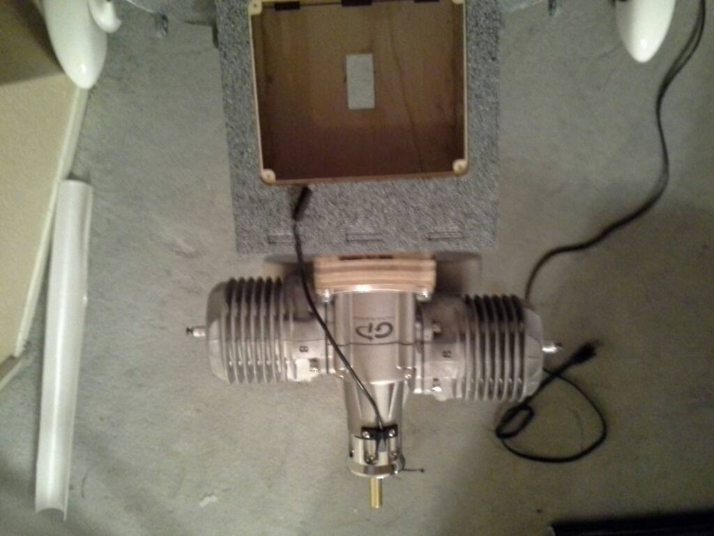

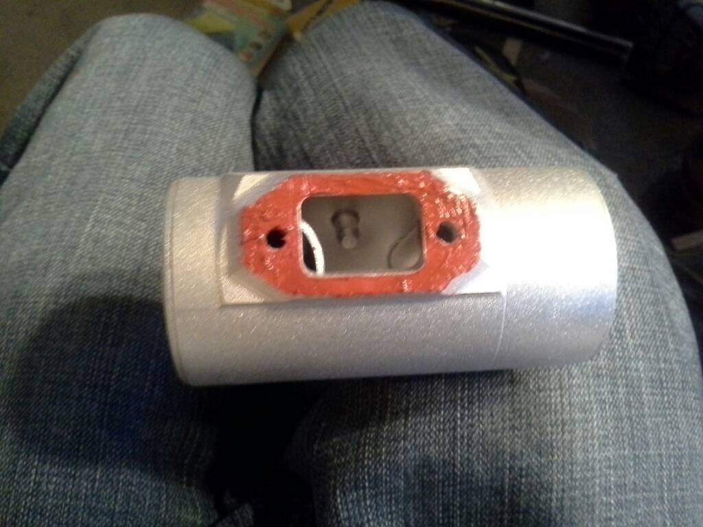

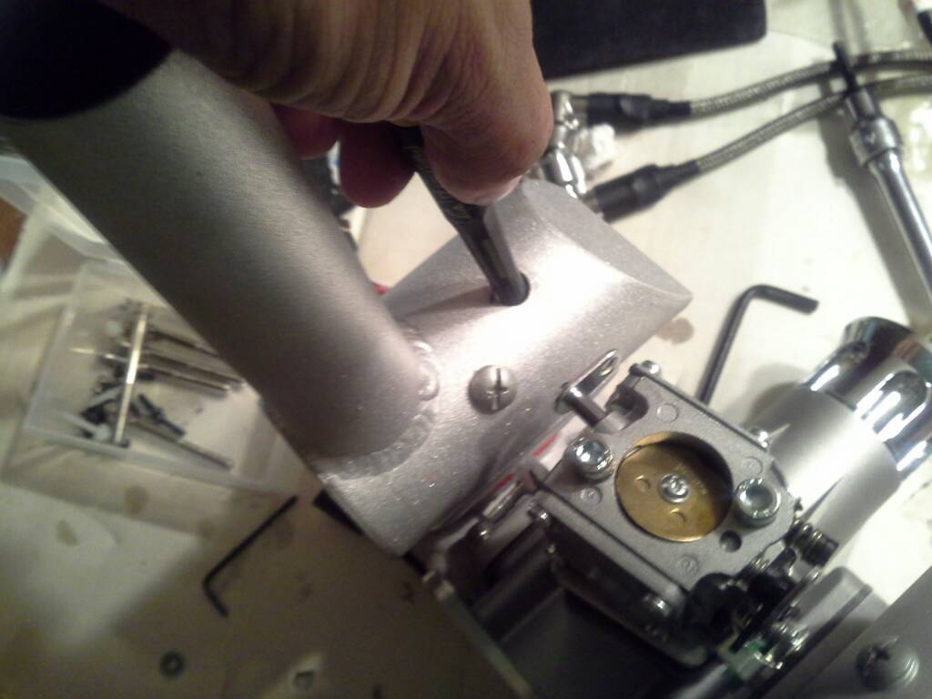

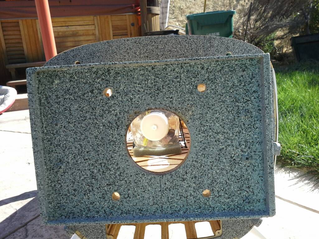

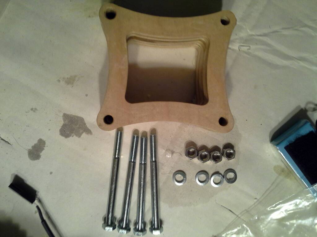

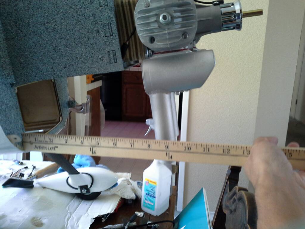

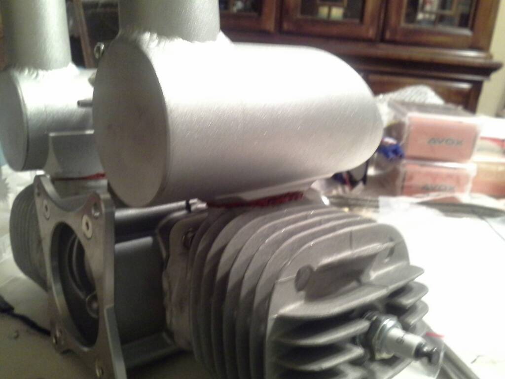

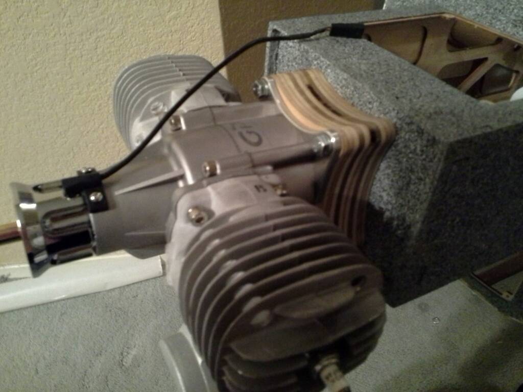

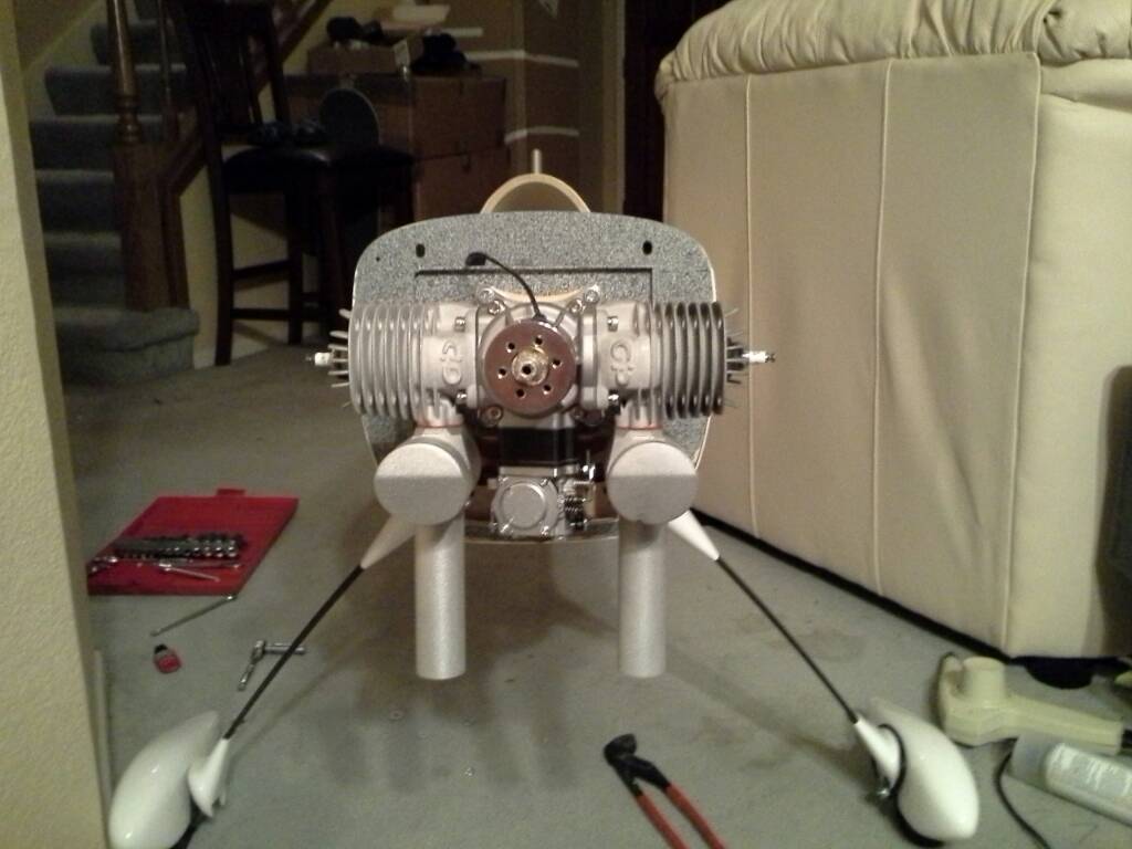

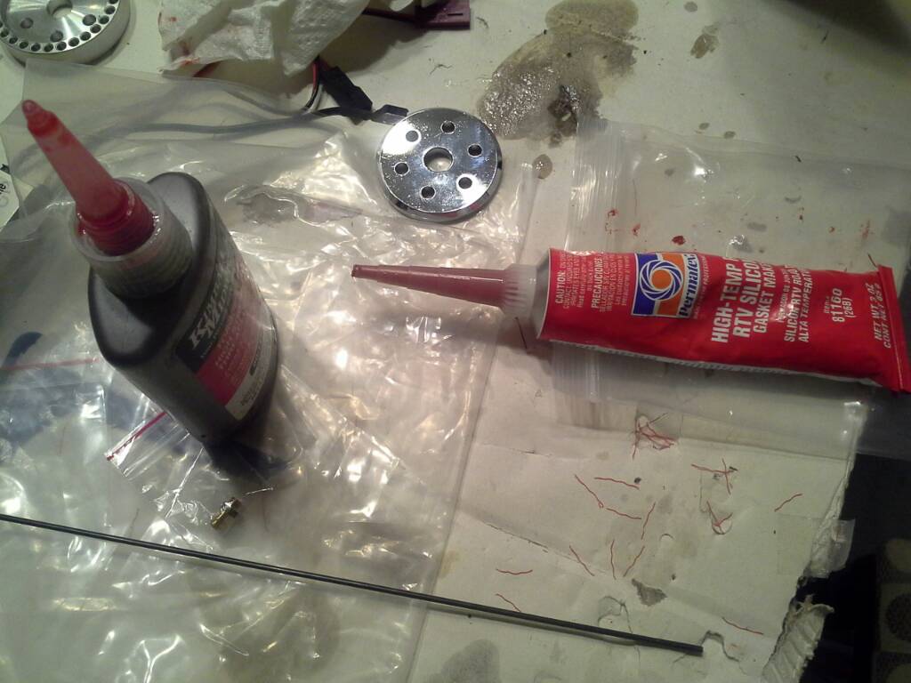

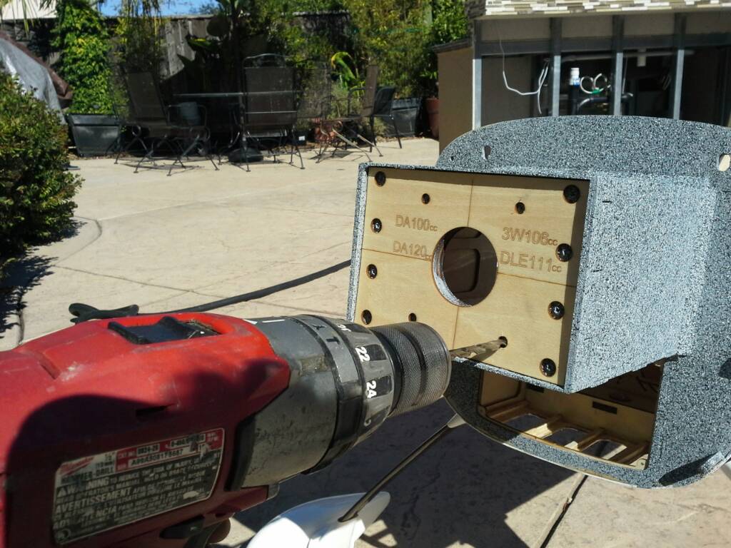

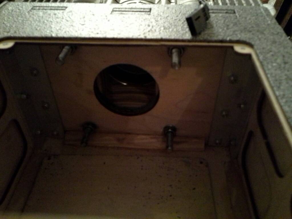

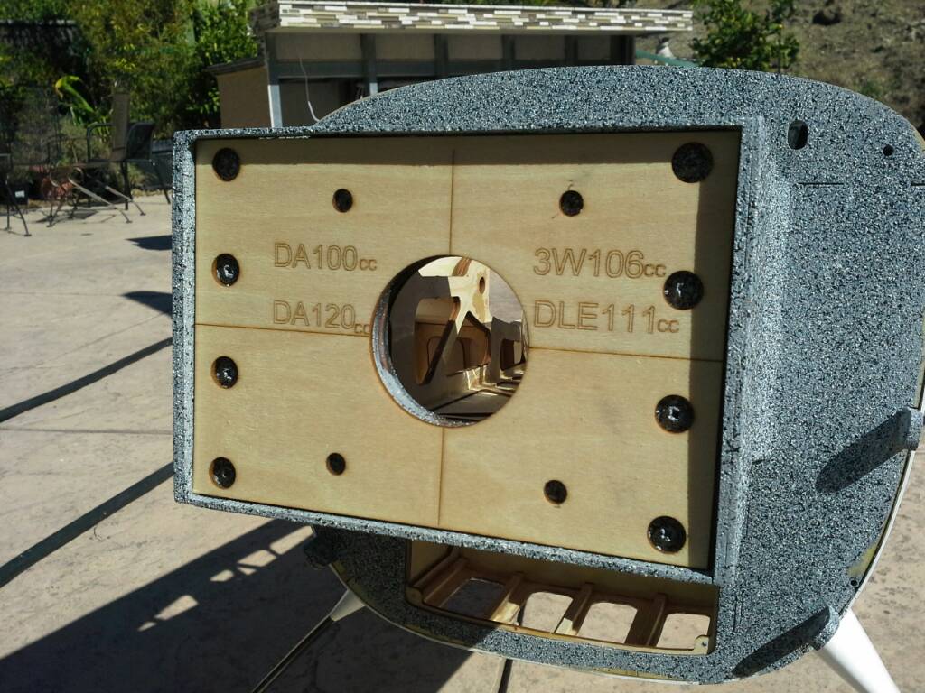

Mounted the GP-123 tonight. It looks great hangin' on the front of the Slick! I'm excited to fire it up but I need to get a prop first. I'll be getting a Falcon CF 29x9. I used high temp loctite on the muffler bolts and red rtv for the gasket. I shouldn't have any issues with loose mufflers. I'm using a wood mount that is available from vital-rc for a standoff. It comes with the DA-100 pattern which is the same as the GP-123. The plane also came with a template to drill the firewall so doing that was as easy as lining up the template and drilling out the holes. I used m6 bolts, nuts, lock washers, and plenty of blue loctite to secure it to the firewall.

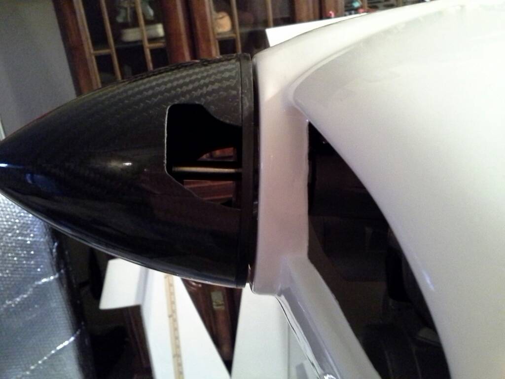

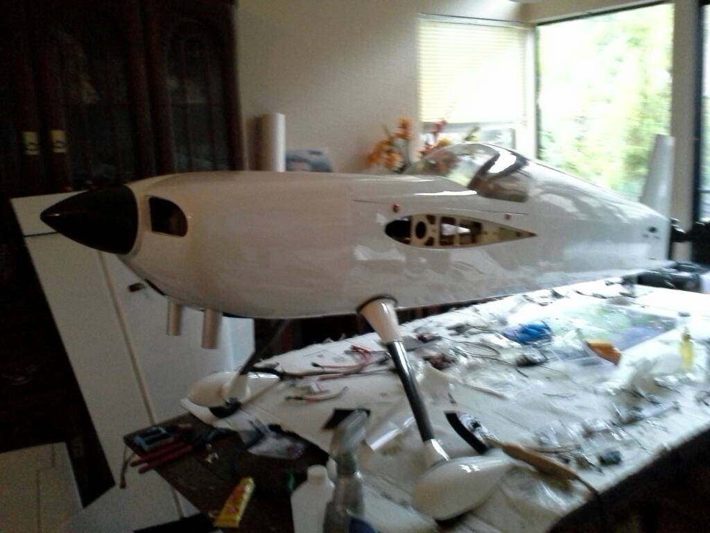

Cowl cut out, just needs final mounting. I'll do that after I get my fuel line, throttle servo, and ignition all mounted.

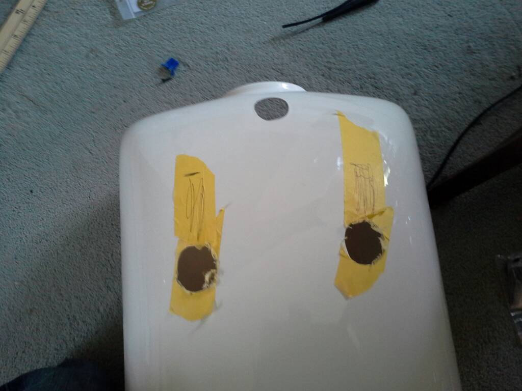

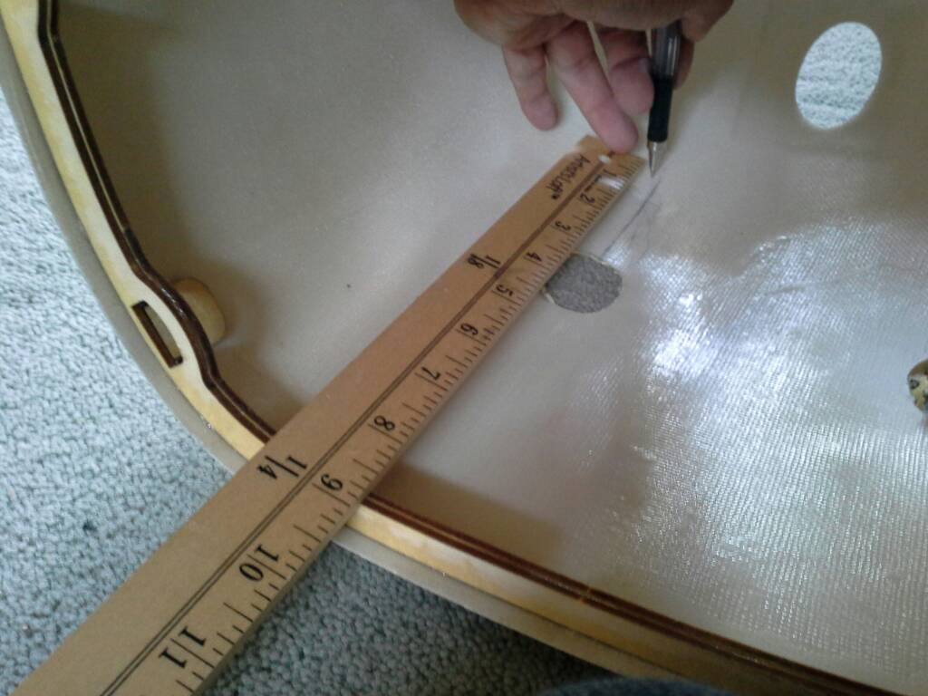

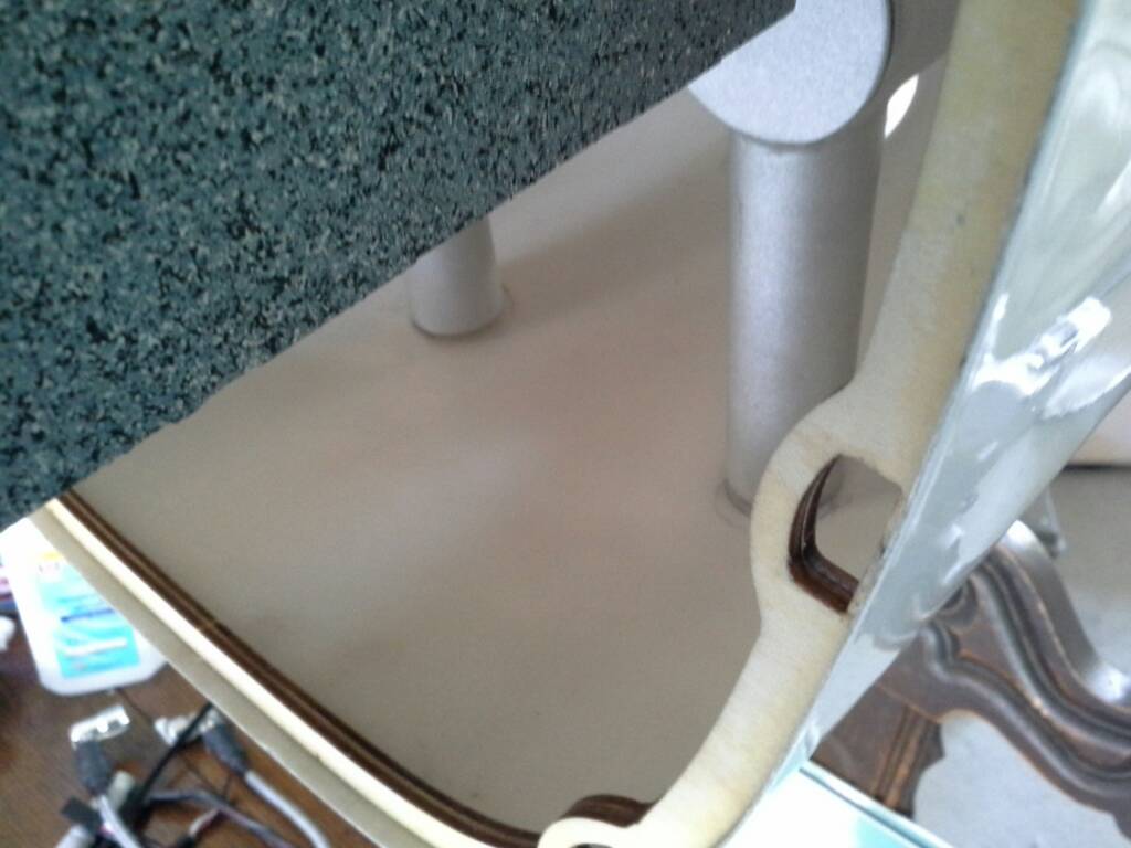

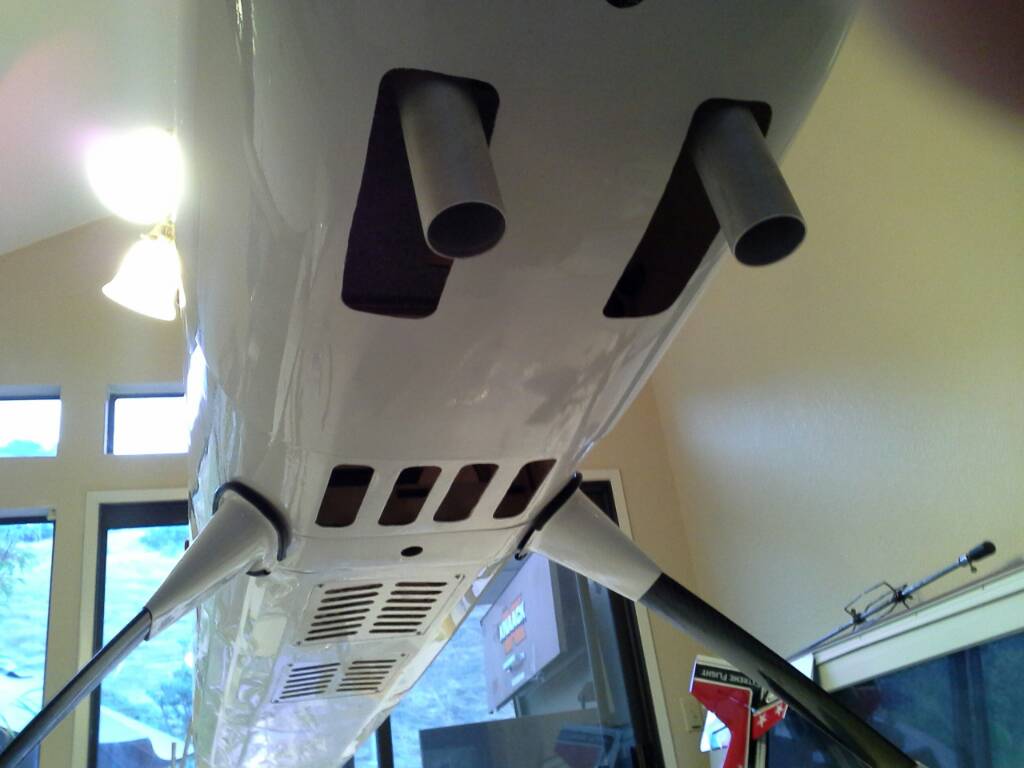

Here are some more pics of the steps I took to mount the cowl.
First I put the cowl on as far as it would go then marked where the mufflers touched the cowl with a pen. Next I measured the distance fro the firewall to the front of the mufflers so I know how far I need to cut to fully seat the cowl. I put masking tape on the cowl to help keep the paint from chipping while I cut it out with my dremel. I cut a little at a time and test fit it A LOT along the way to make sure the cuts were going where they needed to go.
You can see the final results in the above post.

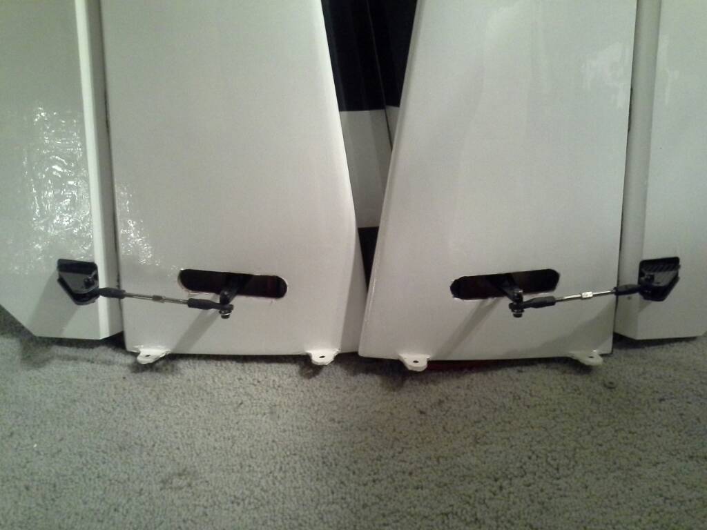

After getting home from work late this evening I decided to set up my elevator linkages. Got them done pretty quick.
Tomorrow I'm going to try to install the aileron control horns and linkages.
