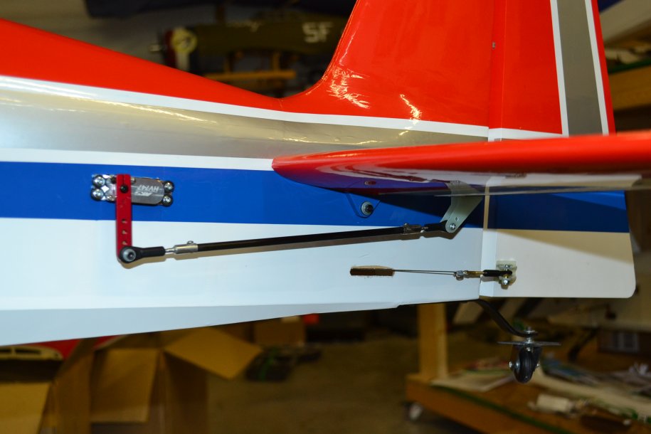

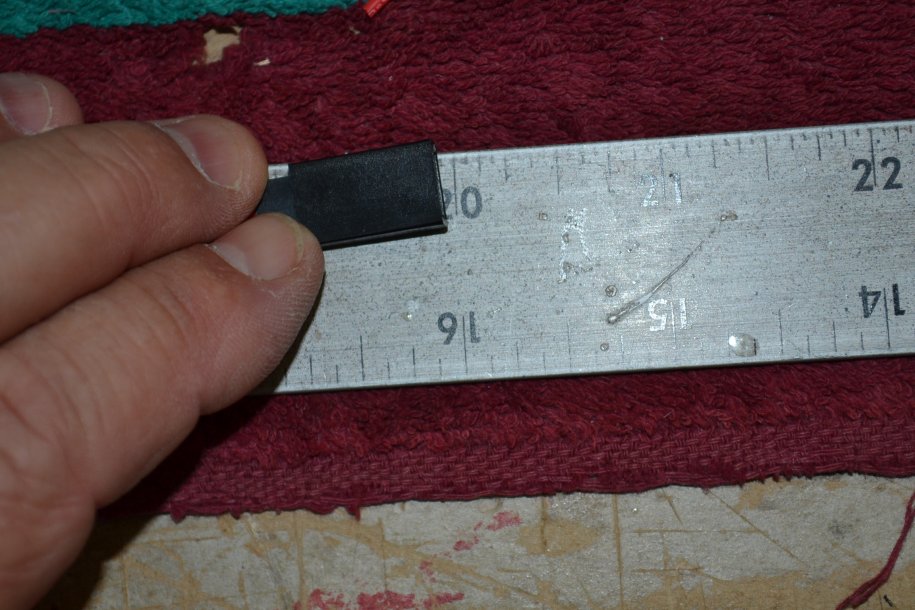

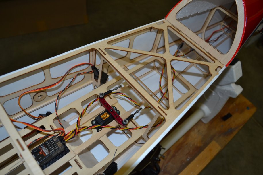

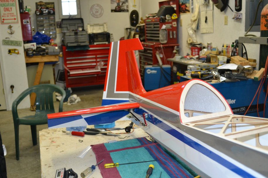

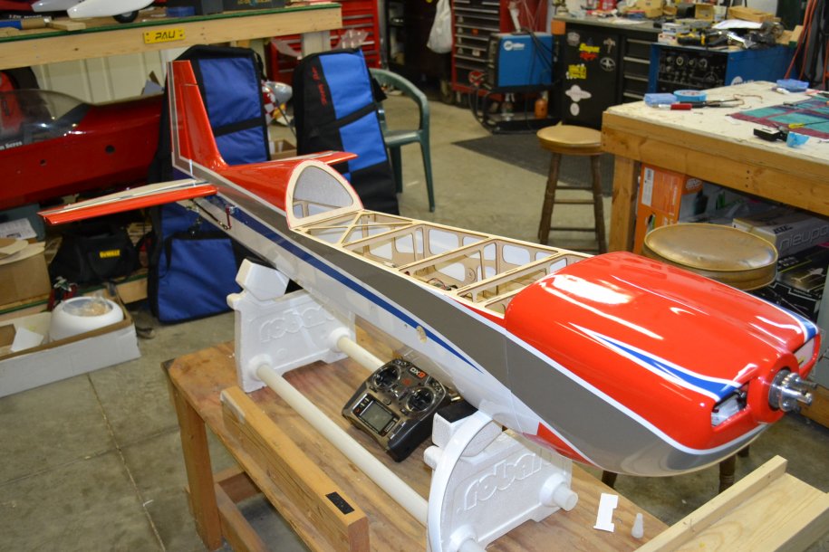

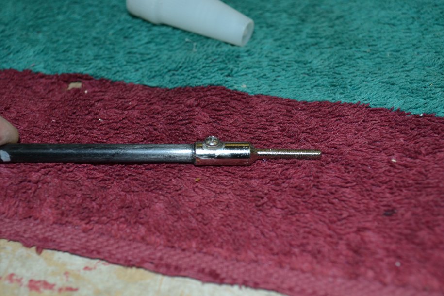

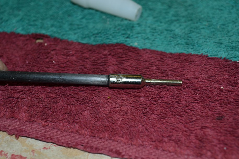

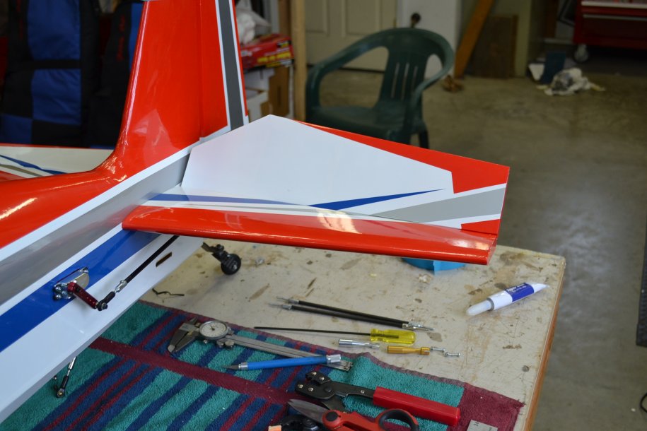

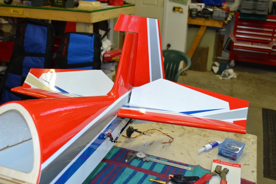

  2. I got all the tape off of the Extra. But put another piece on the counterbalance to hold the ruder in place. Mounted the ruder servo and finished the Elevator push rods. The end caps are glued on with 30 minute epoxy and I have a #2 sheet metal screw to insure that they don't pull apart. The screw went all the way through and I used medium CA to hold the screws in with a dab of kicker to set it off. Then I ground the tip of the screw flush with the end cap.
    This is when I ran out of feel like it.

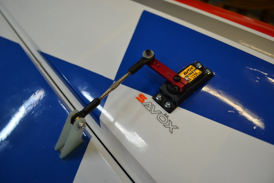

    Nice, I'm all about the MKS now but I will say Savox makes some pretty good servos for the LiFe and A123 users. Like those 1256/1257's and 1232 are really good for this size plane, cheap and light weight too.
  4. I don't feel the need for high voltage. 6 V has plenty of power for me. Everyone wants the latest and greatest. Me I like the old proven stuff. :)

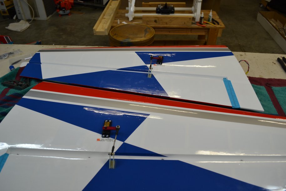

    Im going to us Savox 1230 @ 500 oz torque, reaction .16 @ 6 volts for the elevator on my new 35% PAU and 1231 @ 444 oz of torque , reaction .14 for my ailerons these are plenty qick enough and strong for my type of Flying. The Rudder will get a 1230 servo with 500 oz to provide enough torque there . Im going to use a Jeti Central Box 200 with two A123 LiFE batteries that will provide a voltage to all of the servos . I have never use a Central power box in any aircraft but the advantage of the Jeti box provide an excellent platform for my new 35% PAU.
    I would love to use only one servo per wing but i believe i would get twisting of the Aileron by doing this .:joy:

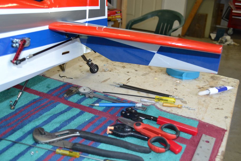

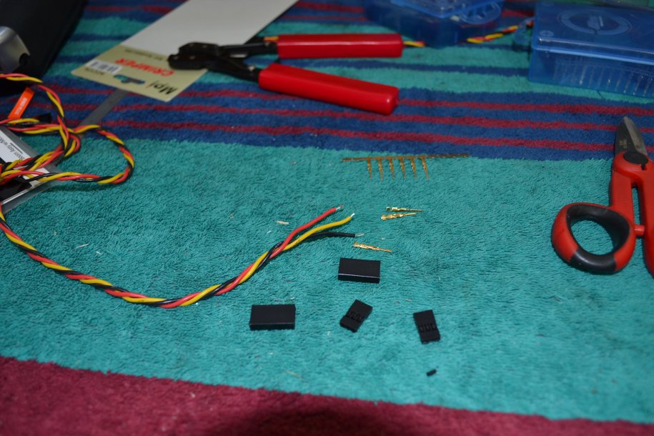

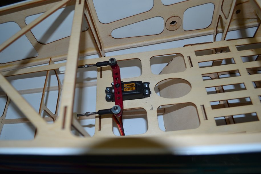

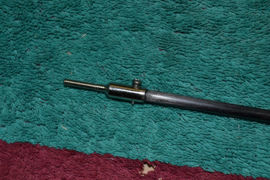

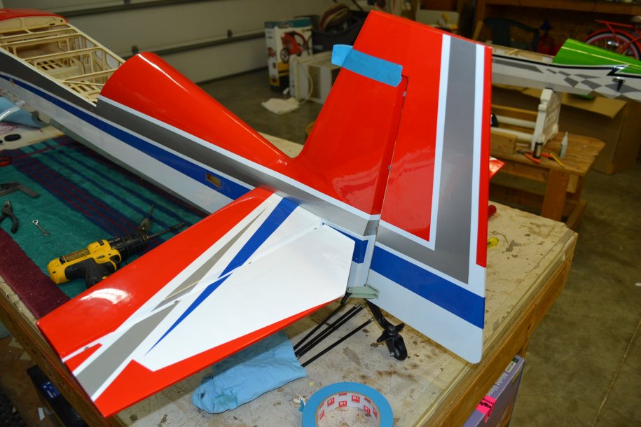

  10. Made up some Elevator Extensions from Taildragger wires and ends. They came out to 20 inches each. This depends on where you mount your Servos. That should be a good ballpark figure.
    made up the pull pull cables same as on the Edge. Mounted the pushrods. I think I got lucky here. I believe they were supposed to be sized first before glueing together. I usually mount the servo arm towards the back so the push rod is as short as possible. Not this time. The rod is to long to do that. They do fit with the arm to the front. smile emoticon Mounted my Receiver and set the max throws... Was going to use Futaba but I loaned the Transmitter out to a friend so I went with Spectrum. I'll put the Futaba in my Camel that I'm building. Don't make the same mistakes on the pushrods that I did. At least you now know how not to do it.
