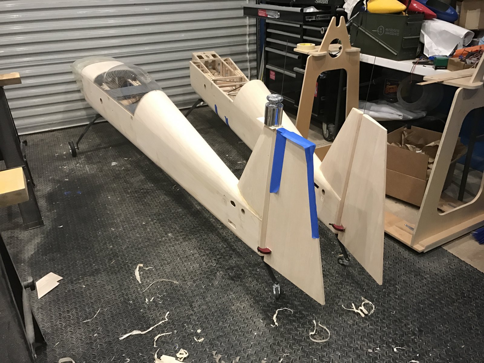

Ok, both rudders are just about done. I only need to sheet the bottom.

Using this method of wire for the hinges i now will be able to remove the rudder so the Fuseage will fit into the eight foot truck box .:attaboy:

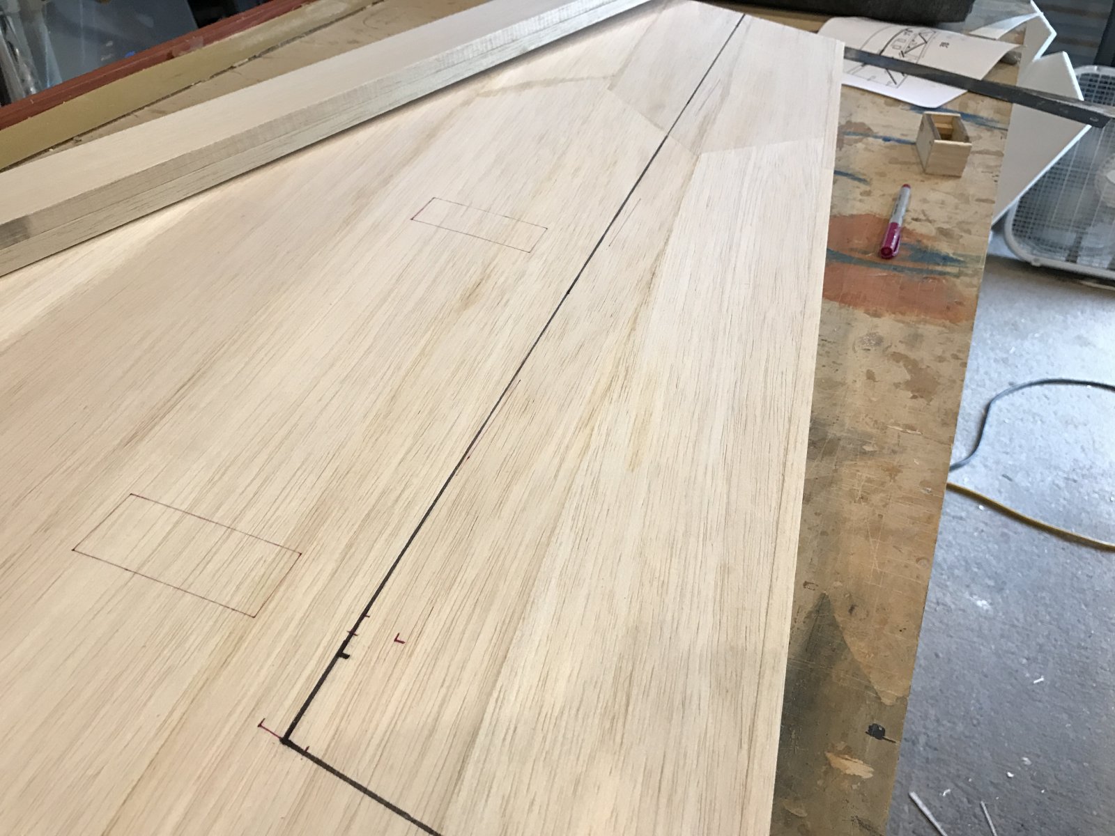

OK, started to plan out cutting out the ailerons. I will deviate from plans, and do something different to me, but has been done in past many times, by many builders. and to this, there are two schools of thought. Not to say anyone is right or wrong, it will be, purely a matter of preference. SO please, I hope no one gets offended by what I am about to do.
Ok, here it is, a forum friend has provided me with the measurements, and here goes something.
I would also like to say, that by using a shorter aileron, from, root to tip, then the chord has to be increased, otherwise, the required deflection to get same result will be too much. Another way to explain this, from my understanding, and grant it, I am not an engineer, much less, have any formal education in aeronautics; the small the aileron, the smaller the surface area that is deflected, and if the surface area is increased, bye increasing the chord, and still preventing the prop blast from hitting the aileron, as well as, by bringing the aileron root out, the air that hits that elevators and rudders, is not as disrupted by aileron deflection, therefore, there should be an improvement in the airflow over the rudder and elevator, without much compromise in the function of the aileron for snaps. IF the chord is not increased, then we can have a problem.
I made some measurements, and the standard stock ailerons have a surface area of 220 square inches. With these "shorties", the surface area is in the 190 range. this is, of course, with a wider chord as compared to the stock ailerons.
Have i confused you??

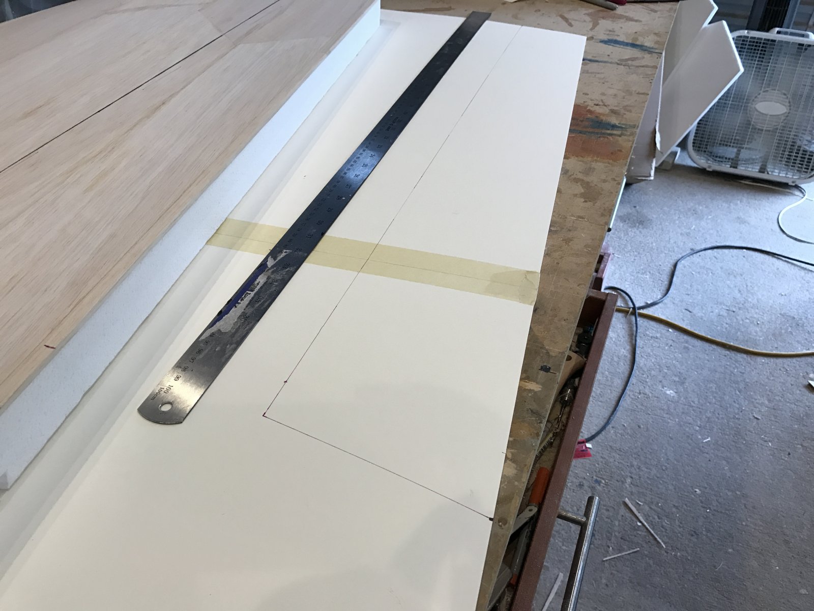

well, let's see if pictures can demonstrate this.
this first photograph demonstrates the new short aileron in black. in the bottom of the picture, the red depicts where the stock aileron root would have been. dicciuclt to see, but the aileron tip now is much wider than in the stock condition, by , i believe, 1.5". I have those measurements all written down, but not right in front of me right now as I type this.

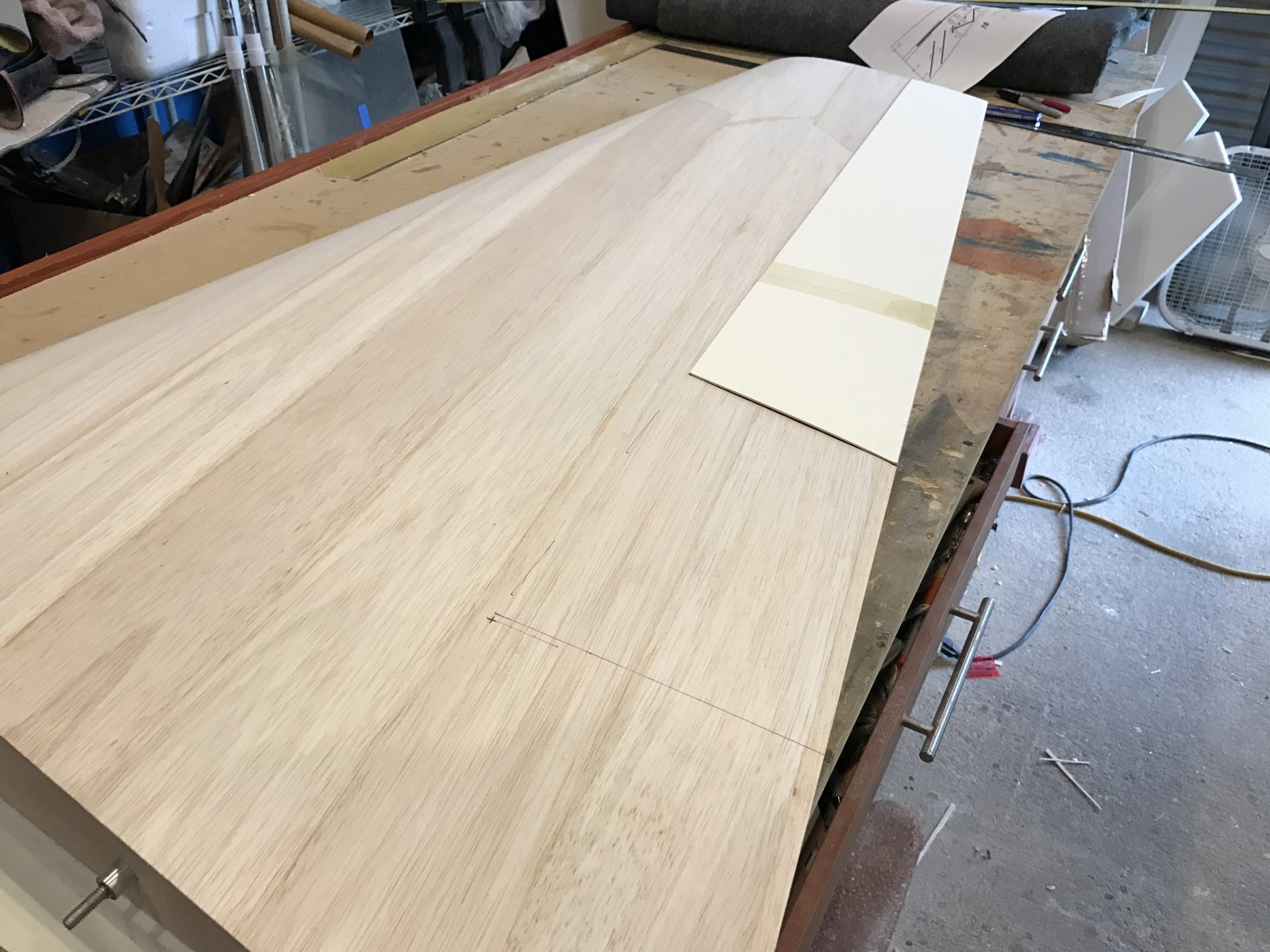

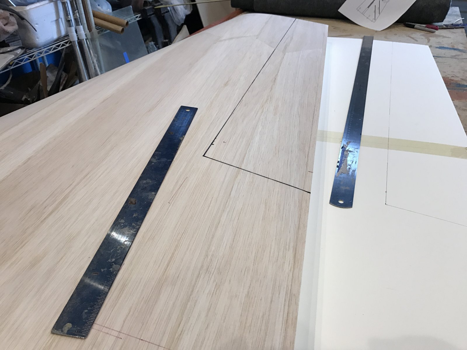

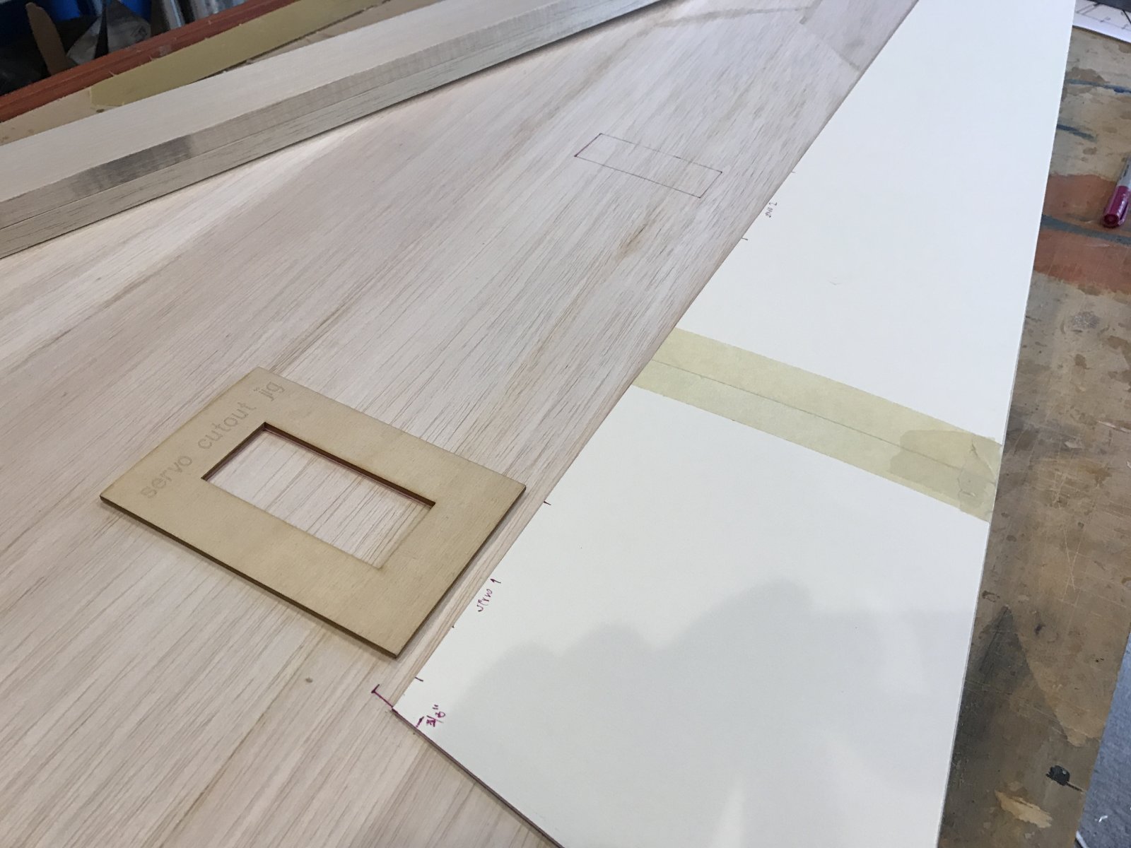

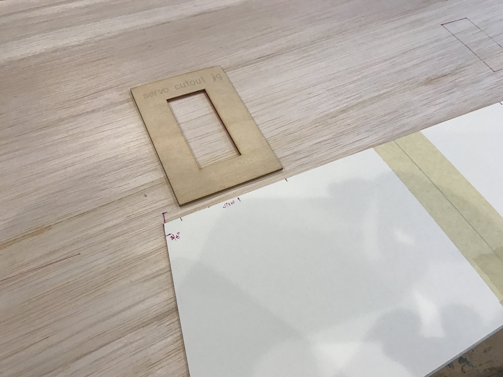

after I calculated where the aileron will be, I wanted to make a template....
cut out the template:
now, I can mark the top and bottom of all the wings.
I also have placed two marks on the template, for the location of the servo boxes.

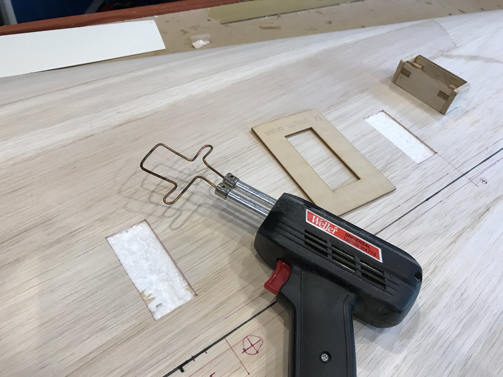

this is to demonstrate the "surgical" plan!! LOL!

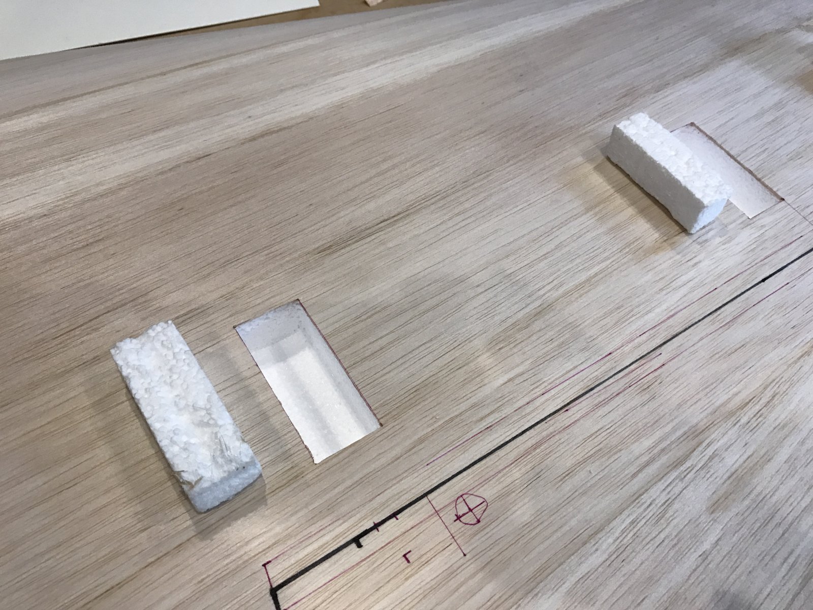

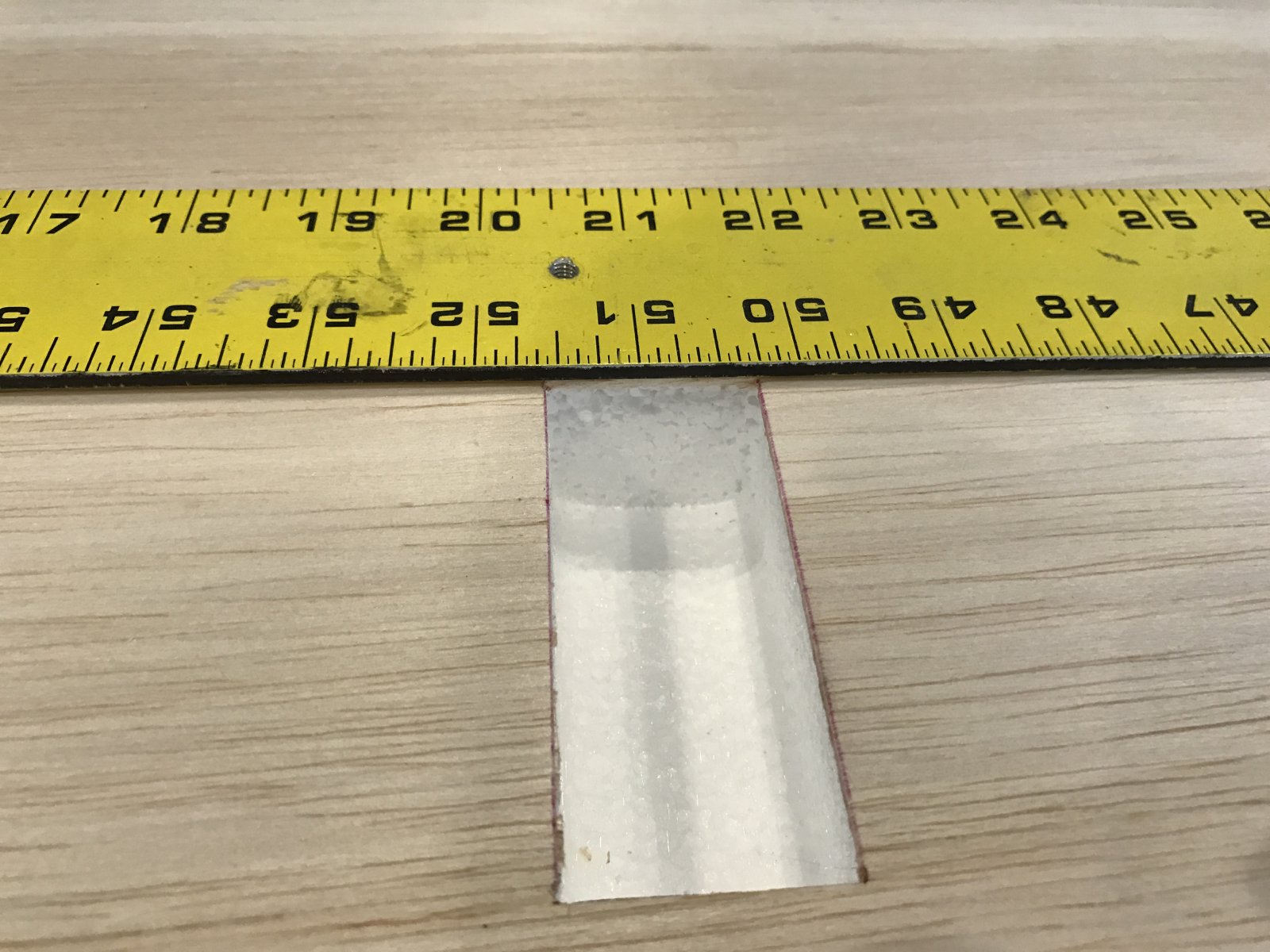

this is how I cut out the foam for the servo...
I then make a hole in the root of the wing, and using a copper pipe, I burn the foam from the root to the outer servo bay.

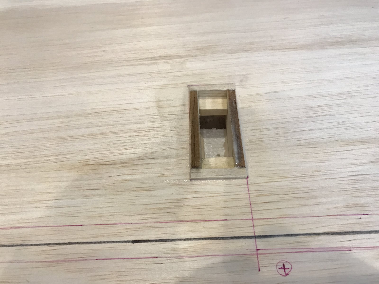

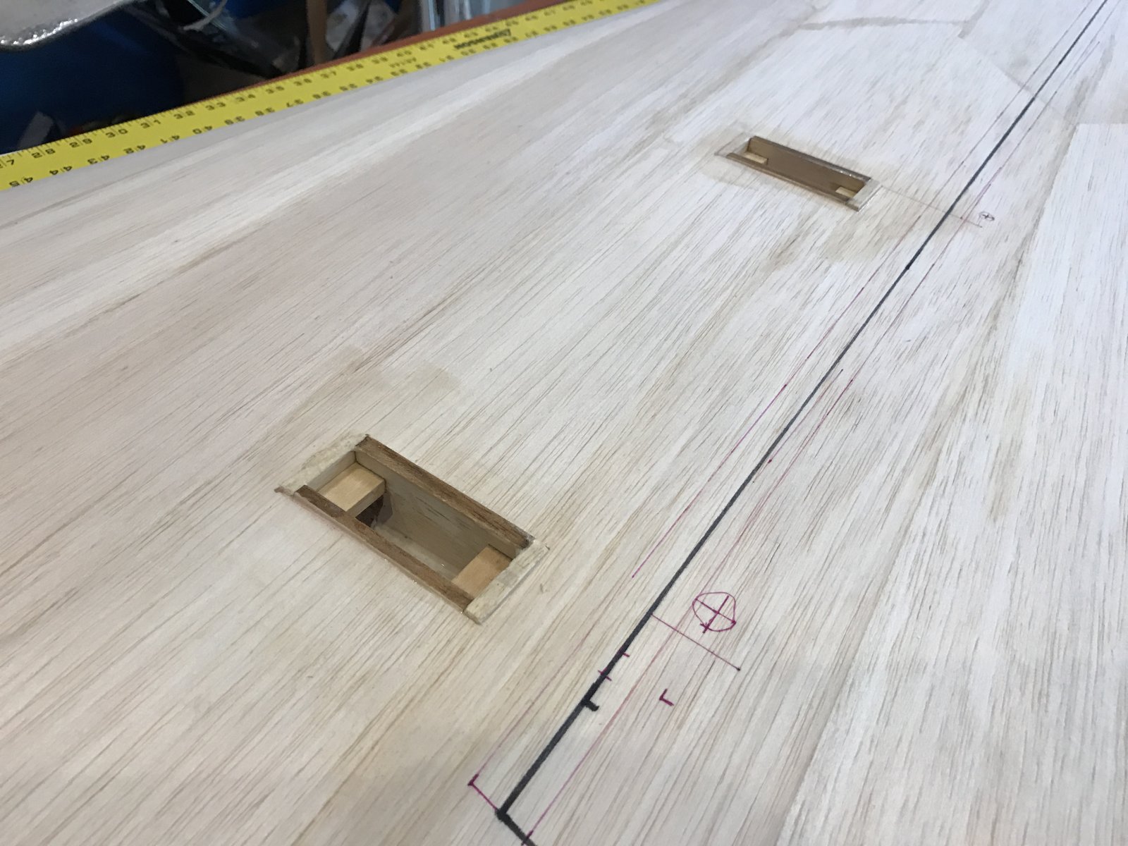

once I make the tunnel, i then glue in the servo boxes.
once the glue cures, I will sand the servo box flush with the balsa sheeting.
