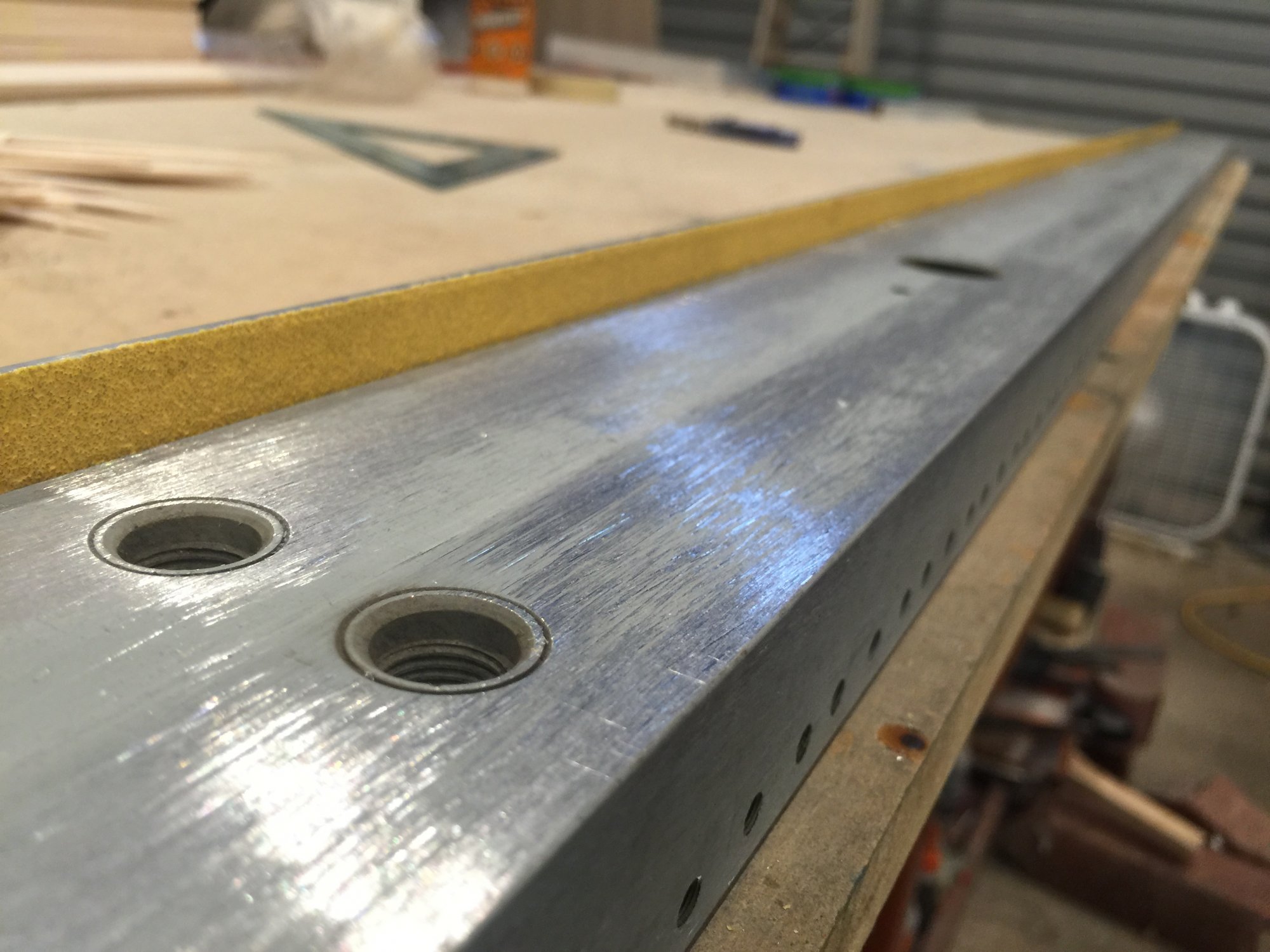

Got it all set up and it works great!

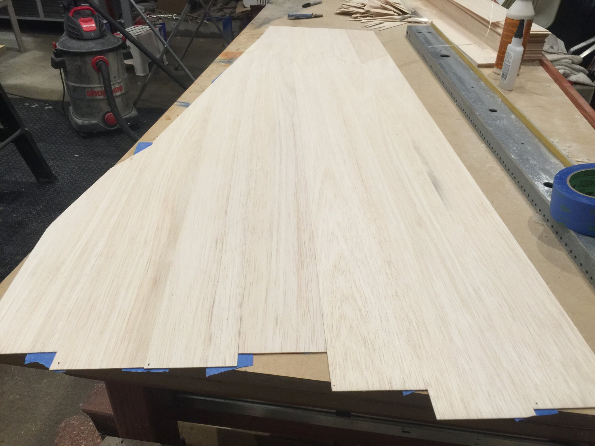

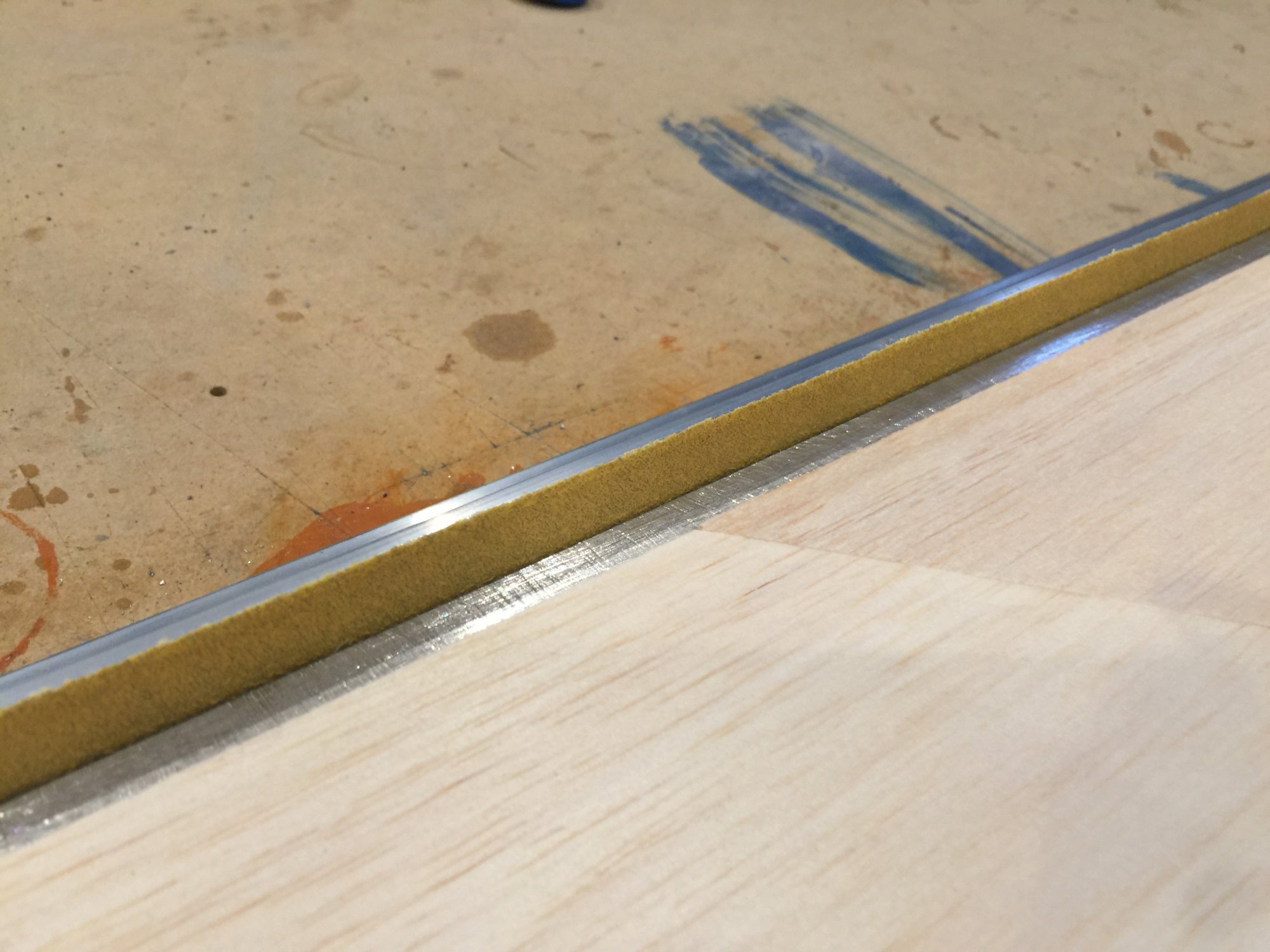

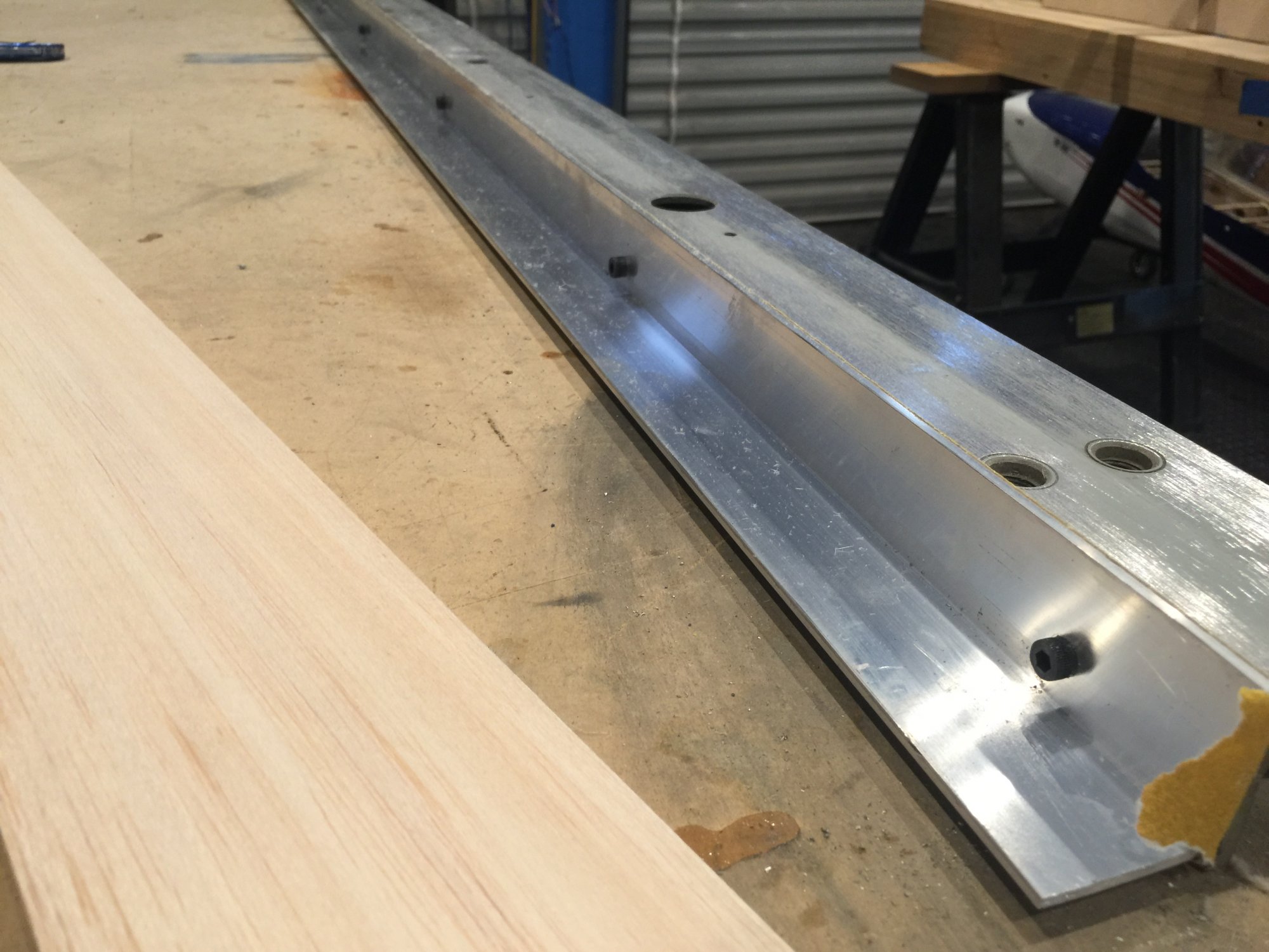

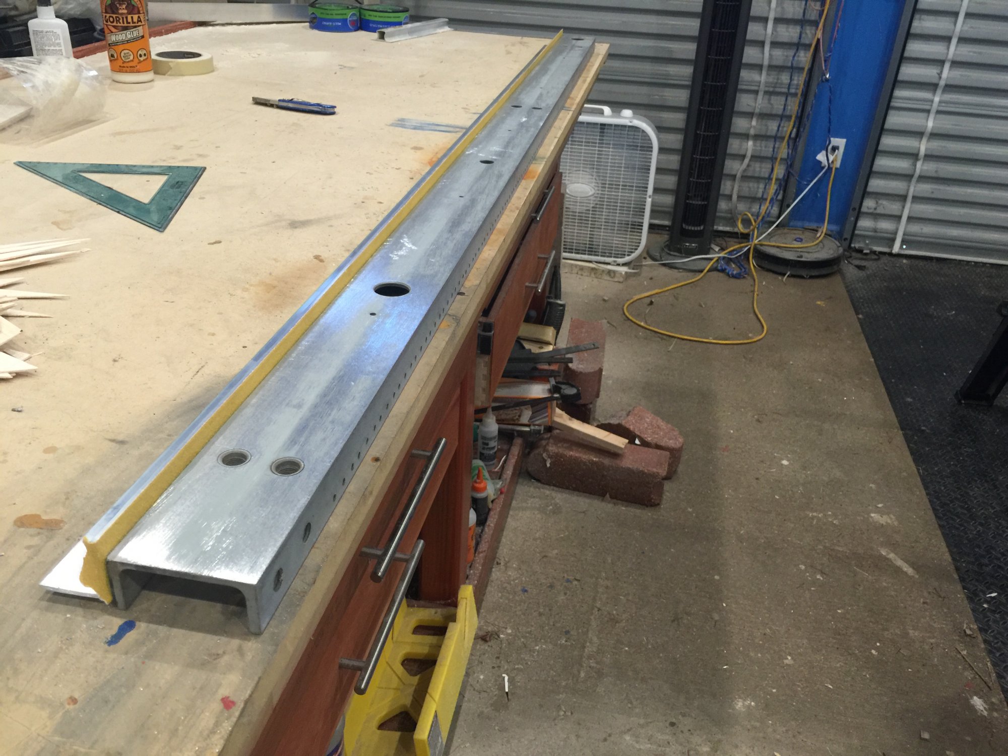

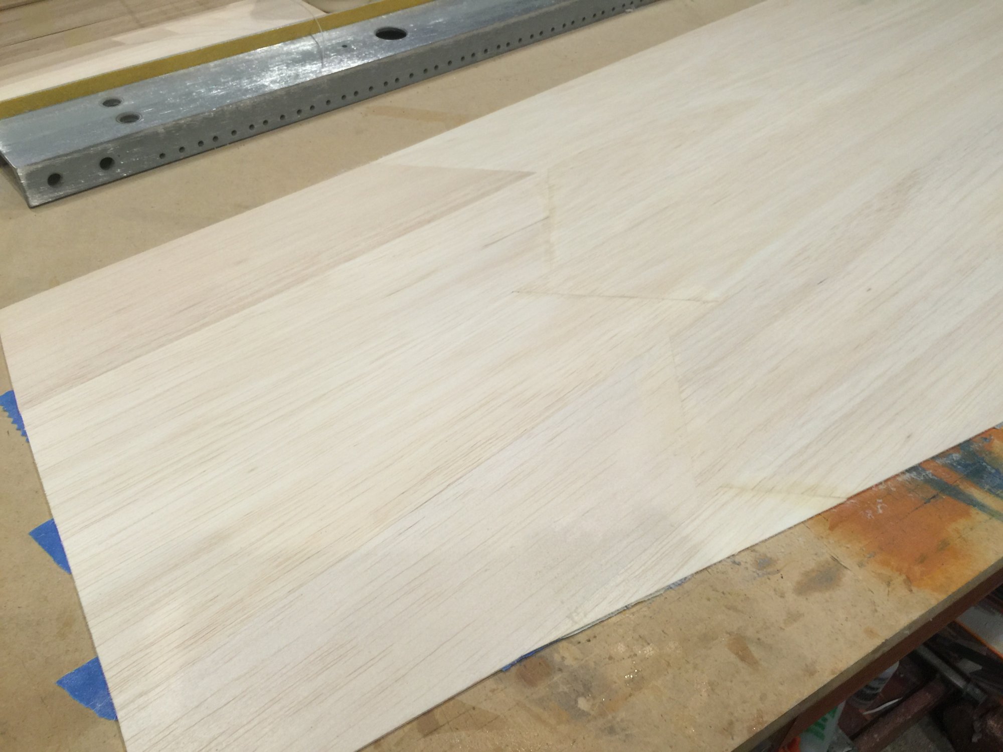

Made my 2nd skin, this time, using a wider blue masking tape, and using this rail to make sure the sides are true and straight. Worked out great. I am really happy with this.

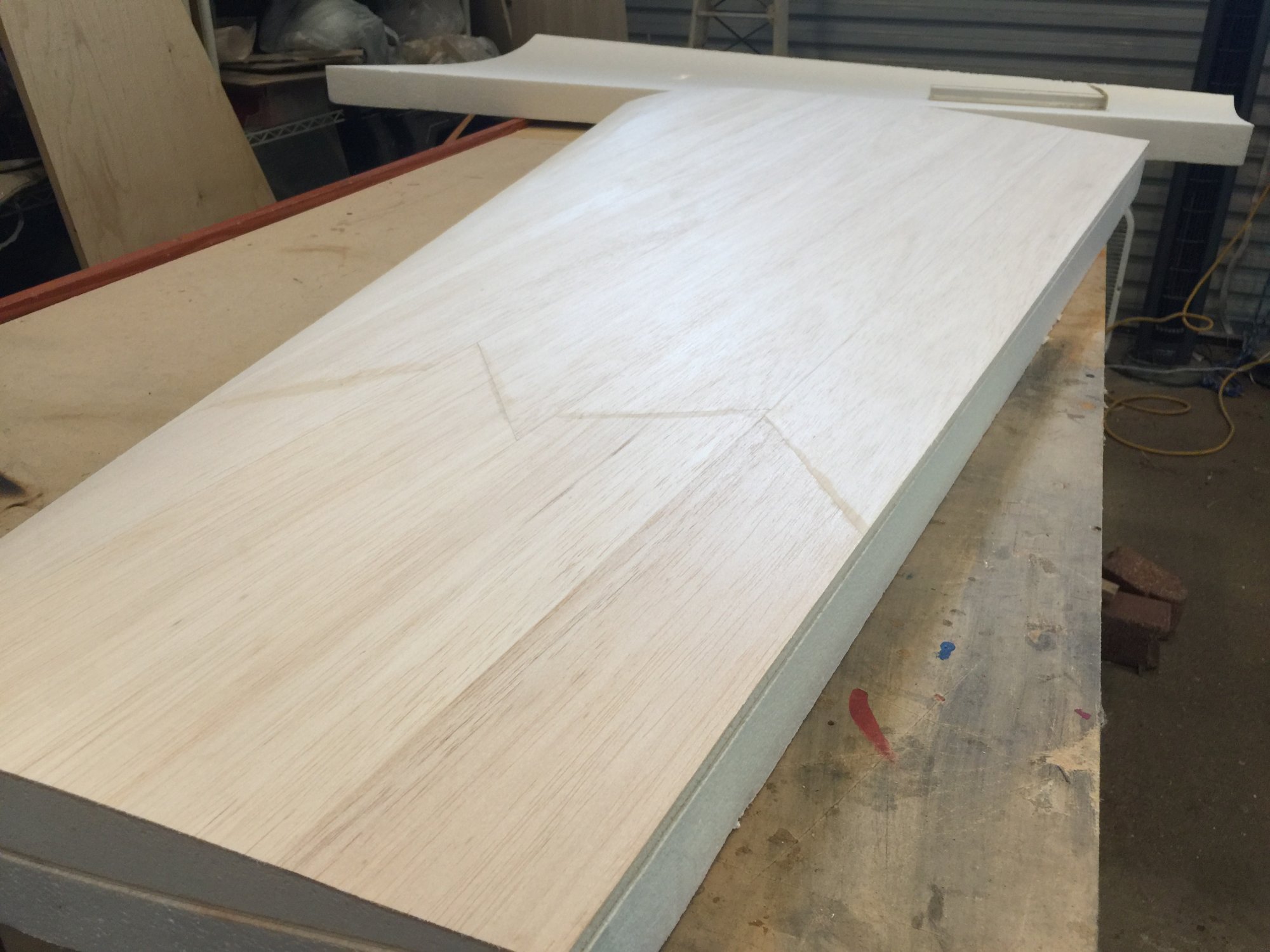

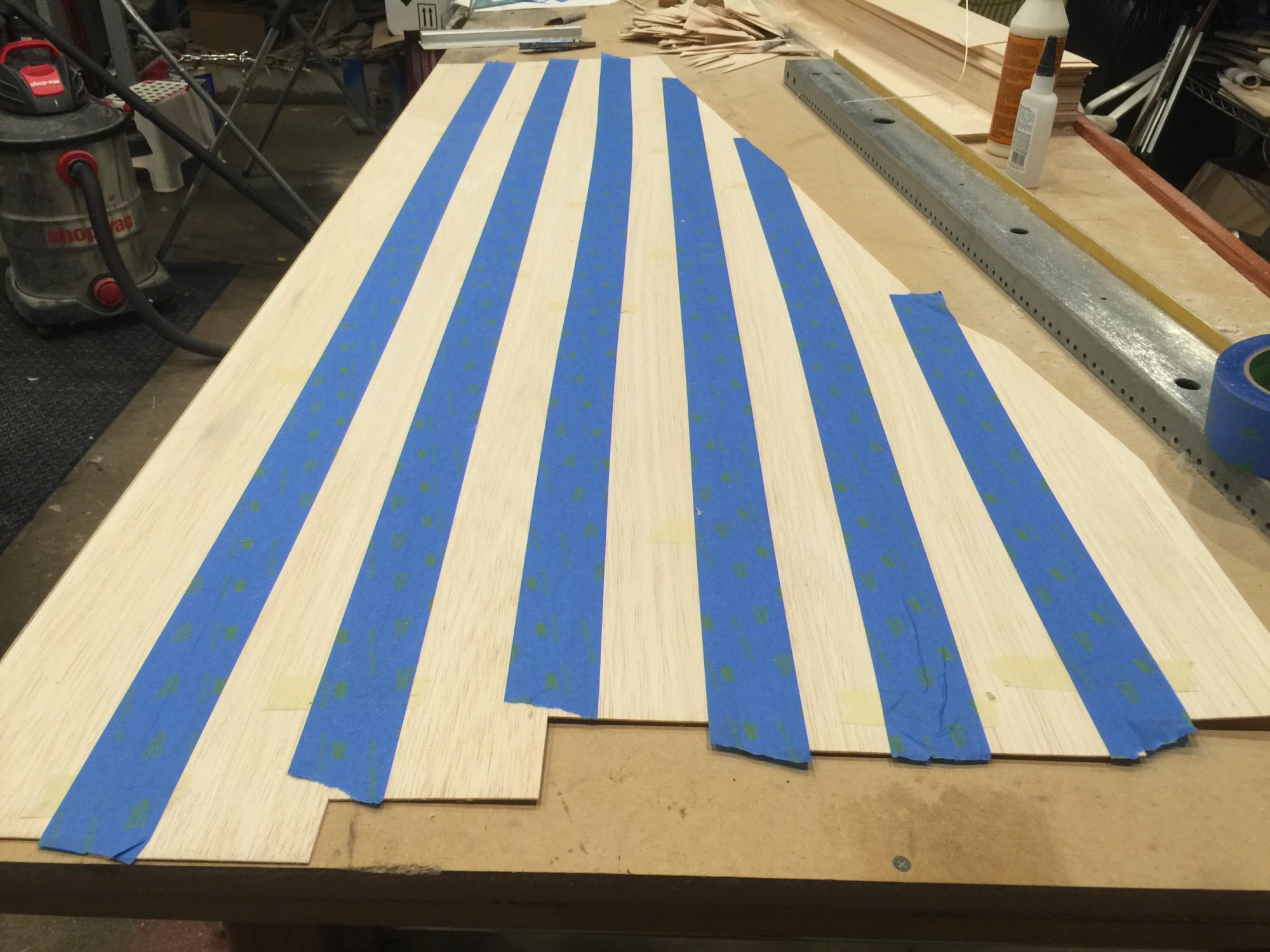

This is it all taped , using a wider 2" masking tape.

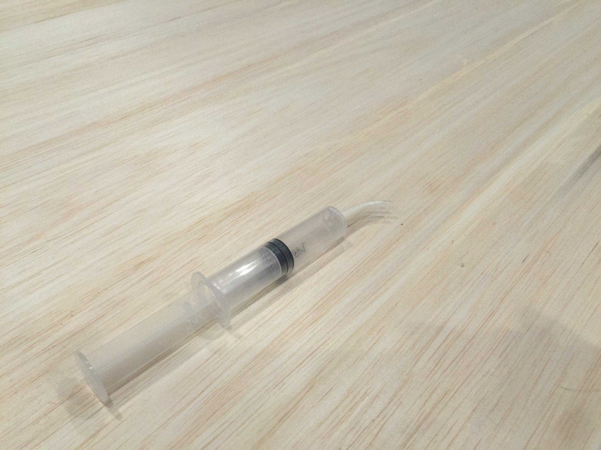

I flipped the balsa sheet, and then using this syringe, I placed a thin beed inside the gap.

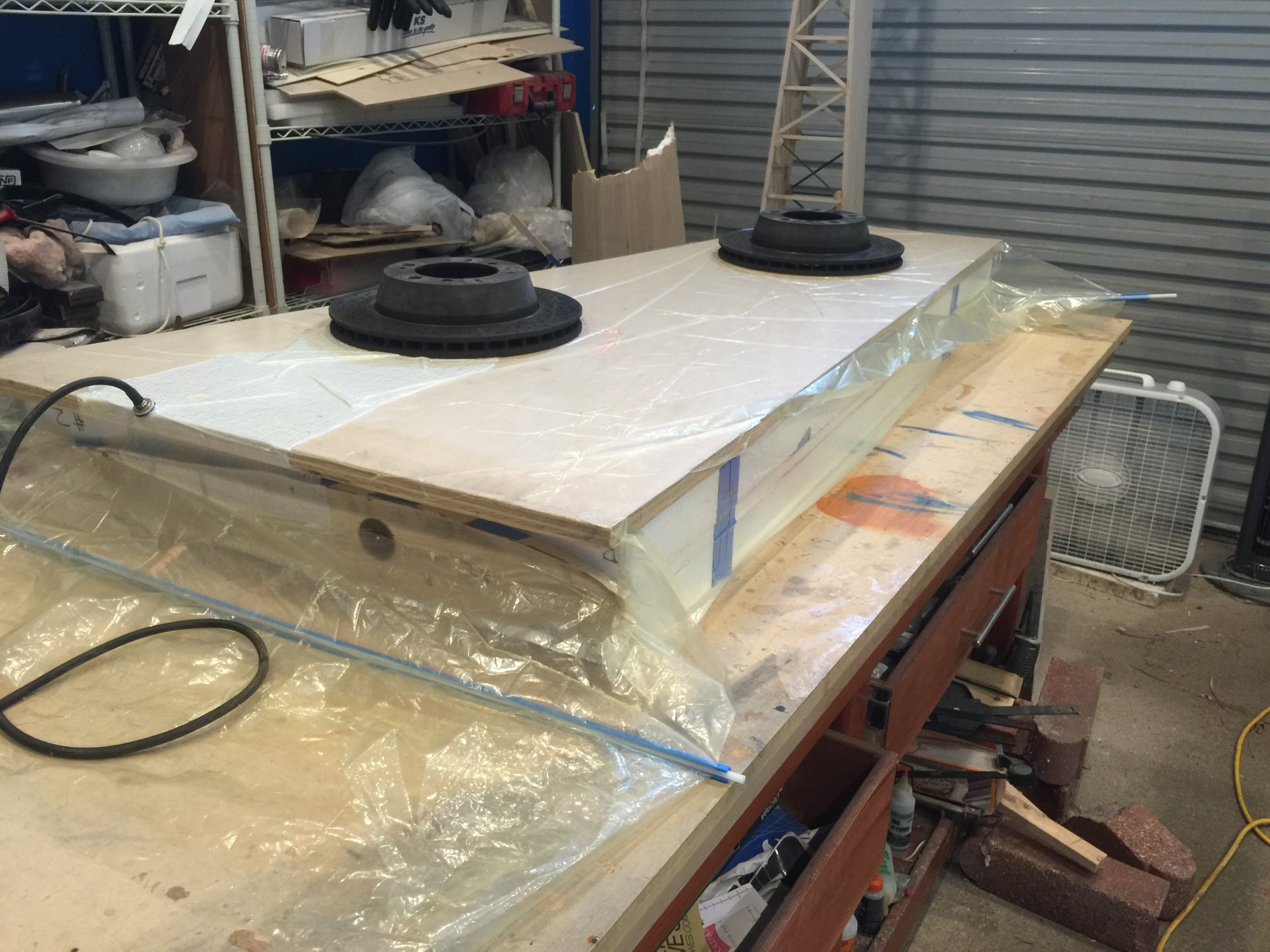

I believe by this afternoon, I may be able to bag the 1st wing.

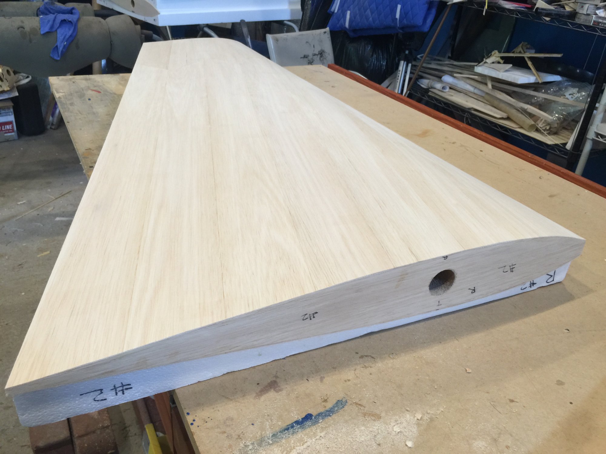

Here is the 1st wing! Well, I use a red dye with the epoxy resin, West Epoxy resin, and if it goes thru the cracks and appears on the top surface of the sheeting, then I will know I did not do a good job!
This should be ready by 5 pm today.
I will remove and show you what has happened.

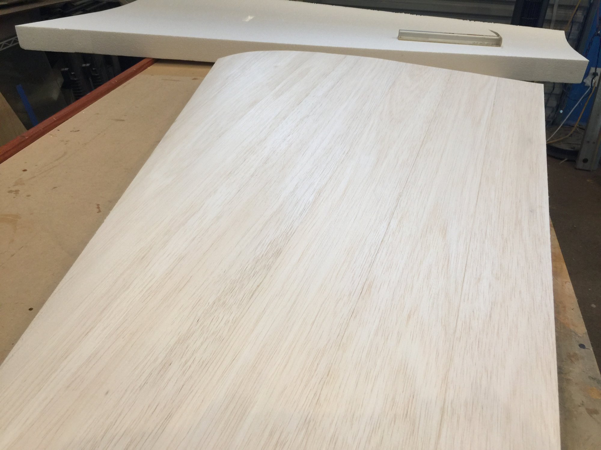

just weighed the wings, and the right and left have a 0.8 ounce difference! Not bad, I would say.
Just did the edge gluing on airplane #1's wing skins. The airplane model I have been working on and the wings are done, is known as airplane #2, well, that is how they are labelled. I have the wings and stabs and fuselage all labeled #1 and #2 respectively. #1 will get the quad, and #2 will get the 150 cc twin with tuned pipes. I am hoping #2 weighs under 38 pounds. and that #1 weighs under 43 pounds.
