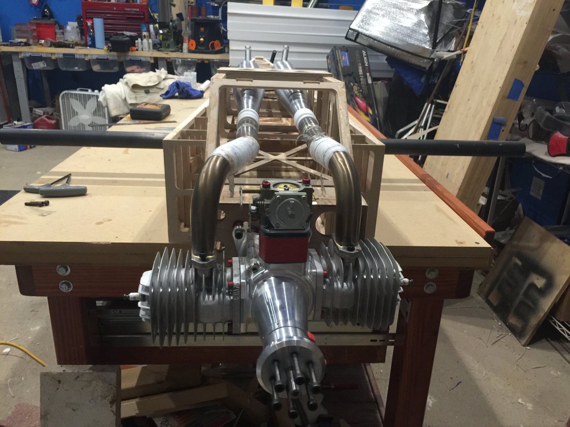

This morning, I was able to install the DA 150 on frame #2, the one with the longer motor box, and preliminary placement of the KS tuned pipes. Now, I need to figure out what to do to install these. I have the KS comfort mounts. But, I just removed canisters on another airplane, and those comfort mounts, the rubber, just crumbled apart! And this is after 320 flights or so. Therefore, I am hesitant to use the comfort mounts. I can post some pictures when I get home this evening.
Here are the pictures:

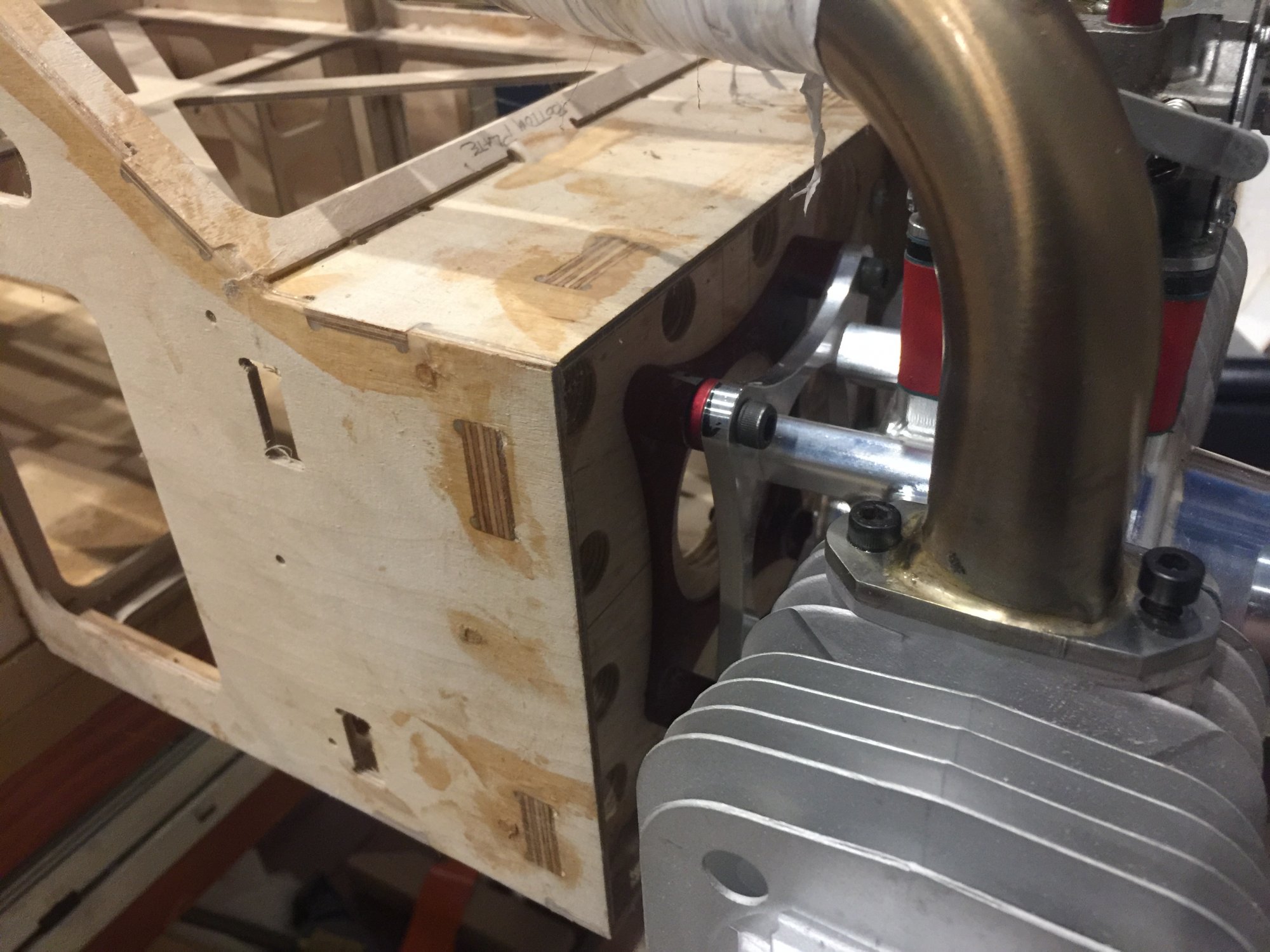

The header length is 34 cm. These were some older headers, that had been cut in the past, and I had to re-lengthen them, by using the extensions, and welding them on.
Now, from what I understand, with a DA 150 and KS1090 tuned pipes, the header length should be:
13 & 3/4"
If anyone knows any different, please let me know.

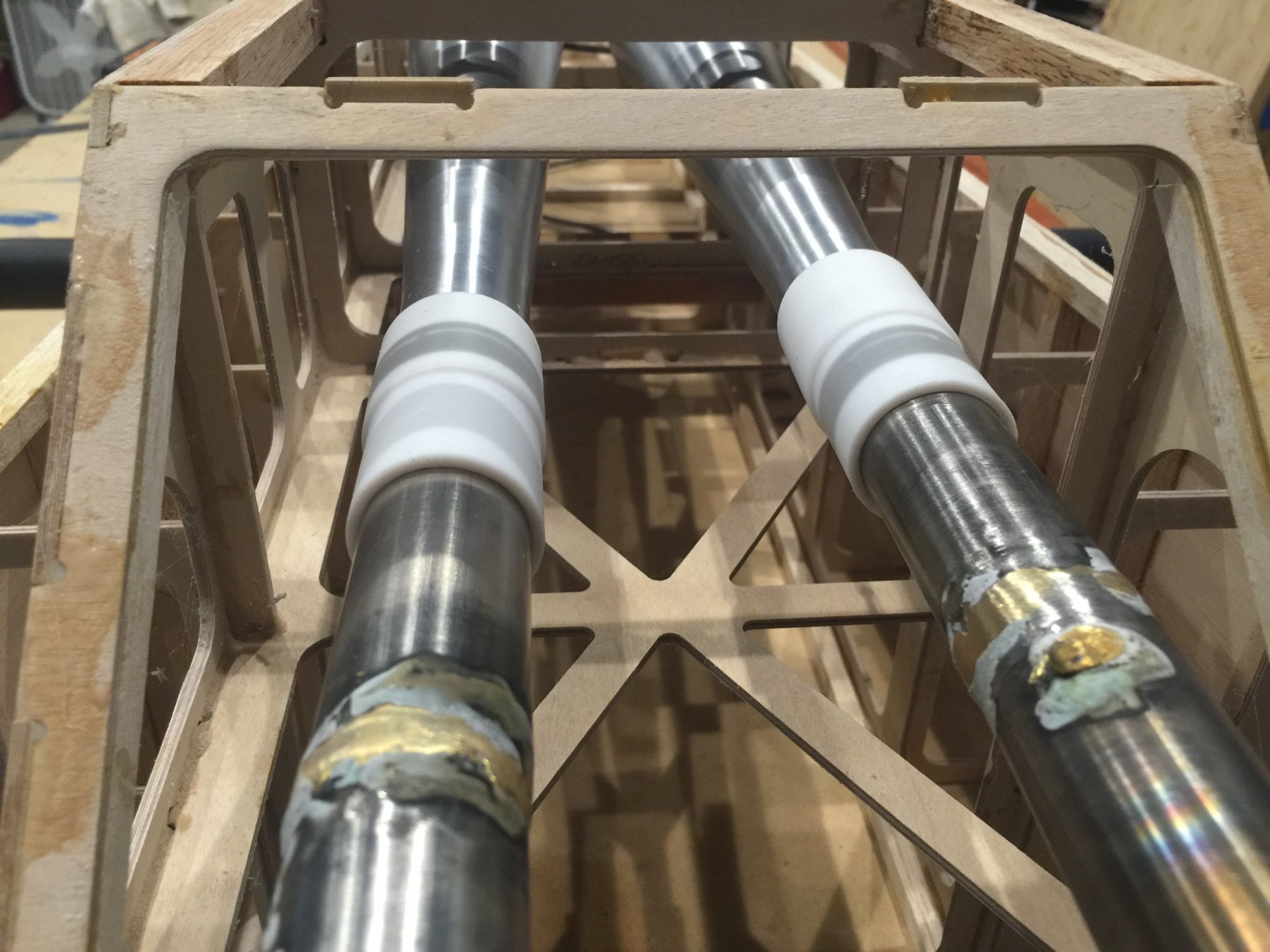

This picture. demonstrates the header and where it has been lengthened. They are each 34 cm in length. this is the NEUTRAL LENGTH, meaning, taking into account the bend, in reality the length is shorter than this measurement from the exhaust port to the coupler, meaning, it is a distance that is of the whole tubing, even as it bends.
(hope I have not confused anyone)

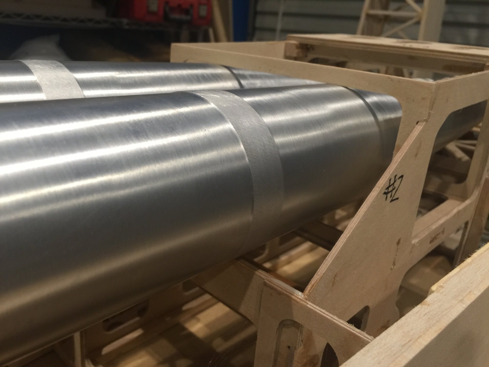

here, lies the problem......

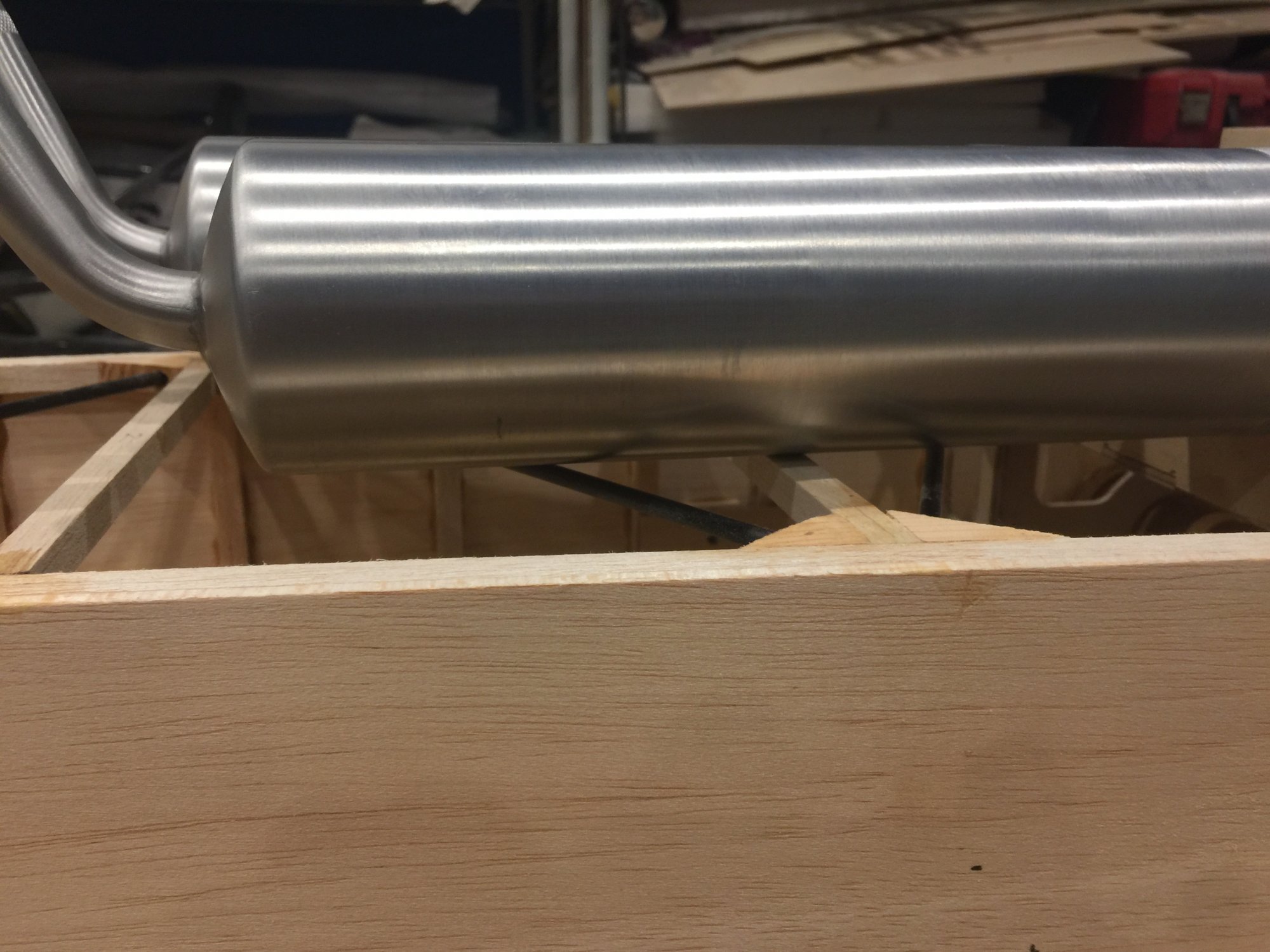

these pipes fit, but they are snug in there!
and it also has contact with the balsa cross brace! I cannot imagine this working out???!!!
anyone have any advice?
