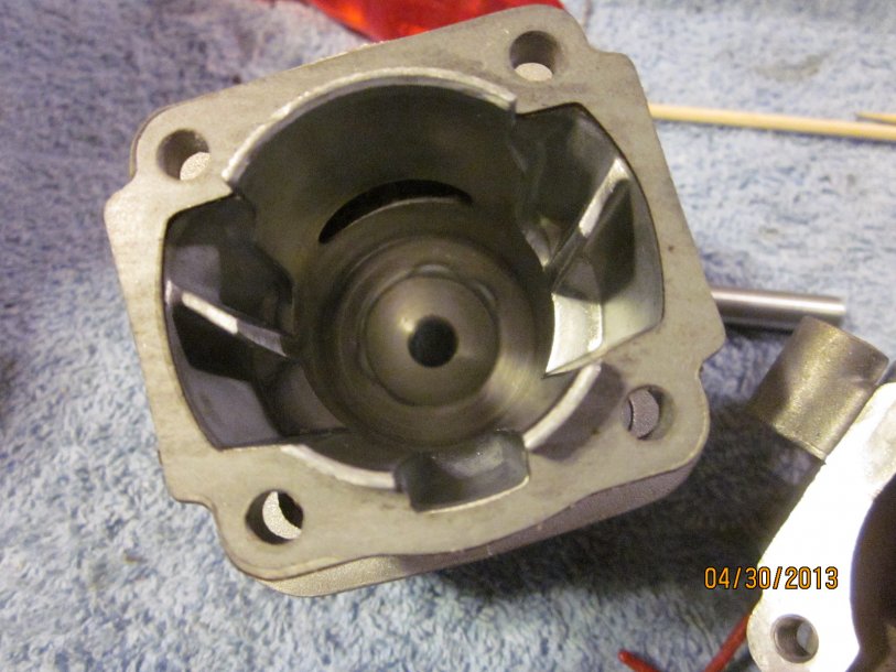

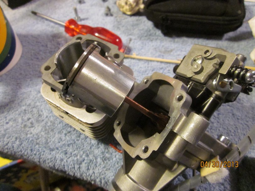

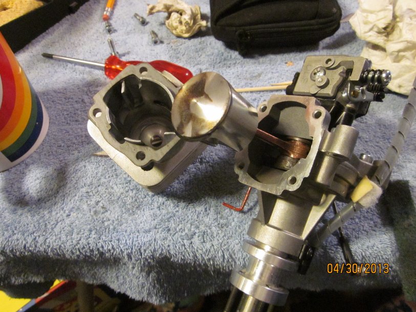

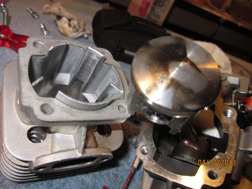

here is one of the DLE 30cc engines I converted from a side carb to the rear carb. I took it down to inspect to see what shape it was in, and do the reed block mod for the guy I sold it to. He was amazed how clean it was after 3 years and 20 some gallons of fuel, running Stihl HP Ultra from first start. Doing the reed block mod did make some difference ran smoother and started with one or two flips IMG_2416.JPG IMG_2418.JPG IMG_2421.JPG IMG_2426.JPG
