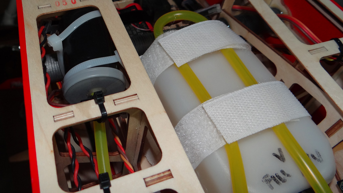

do you have a loop in your vent line? that might help. I know if you run your vent line straight out of the tank, it might fill with fuel, so you have to run a loop on top of the tank. that might help a little!
Thanks for the suggestion Carter. The photo below shows part of the vent line. Is this what you're talking about? The vent line comes out of the tank, then goes towards the back of the tank and loops back up front. Then I run it out the bottom of the fuselage. You may notice that I have a filter in the vent line. I put that in when I first built the plane at the suggestion of someone who said it would prevent crap being pulled back into the tank. But I removed the filter element yesterday as a test and it still died when I rolled inverted.
But that also brings up the question I had before...When I fly inverted, the vent line is under liquid gasoline. So what prevents the tank from going under a vacuum and starving the engine? Is it that the engine pump is strong enough to overcome liquid gas in the vent line?
