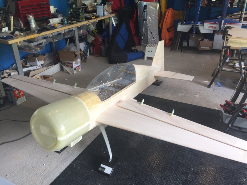

I just weighed it, so far, under 23 pounds.
Motor + canisters/headers = 12 pounds
radio + batteries and fule tanks = 1.5 pounds
we will be up to roughly 36.5 pounds
I do not know how much the covering and paint will add,
Possibly total weight under 40 pounds????
that would be amazing!

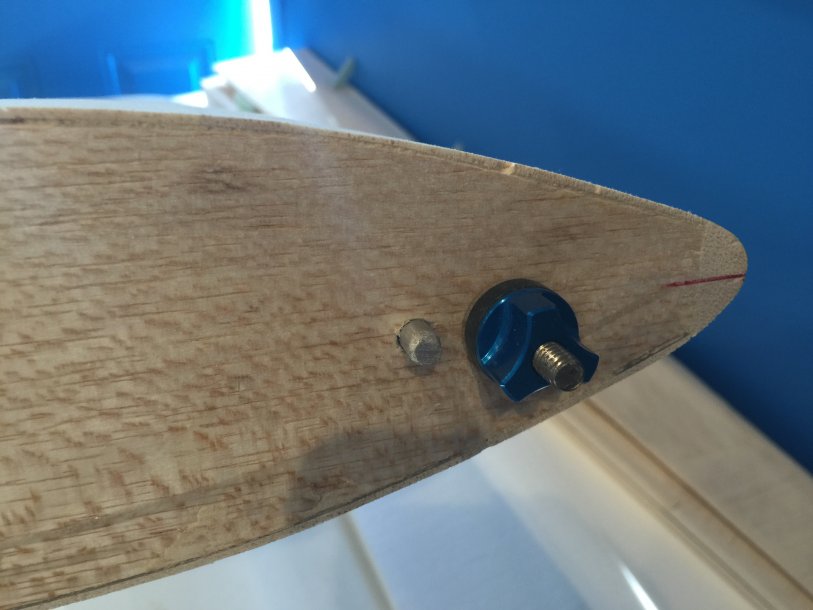

The pins are dry, took the wings off and took some pictures for you all to see. They are composed of titanium, 1" long, does not weigh much. It is glued in with Hysol. The aspect of the pin that is in the plywood has been scored, so that the glue will inter-digitate with the pin and wood. Helps to lock it in there.

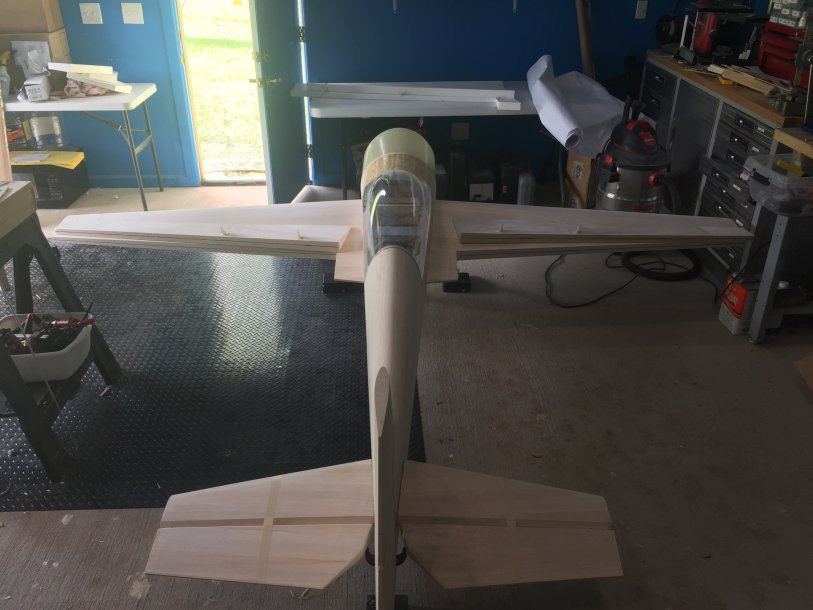

the stabs and elevators are now ready to be covered. Well, 1st, balsa needs to be prepped. But after that, then they will be ready to be covered.

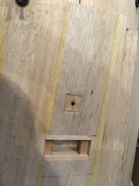

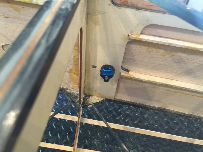

this was the last step, to install the hard point for the stab tube lock mechanism.
Yes, I do a sandwich, 1/4" plywood, 6-32 blind nut, then 1/4" ply again. All the way to the phenolic. Then, I insert tube and use small drill bit, drill into tube, then I tap it with 6/32.
