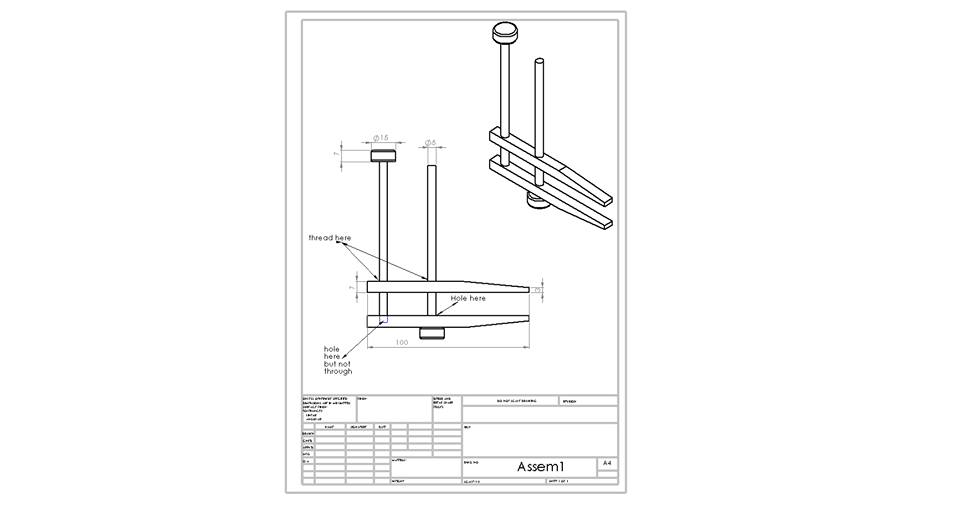

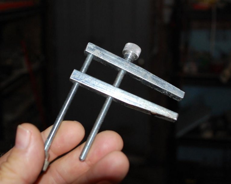

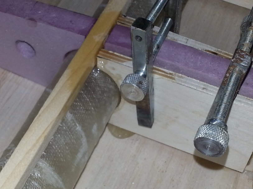

I like those little clamps in the second picture. Did you make those yourself? If so where did you get the long thumbscrews?

Yes I did make them, not that hard to do . as for the screws , I made them also, using threaded rods, and made the small aluminum knob, simply screw the knob on the end and glue with CA,
