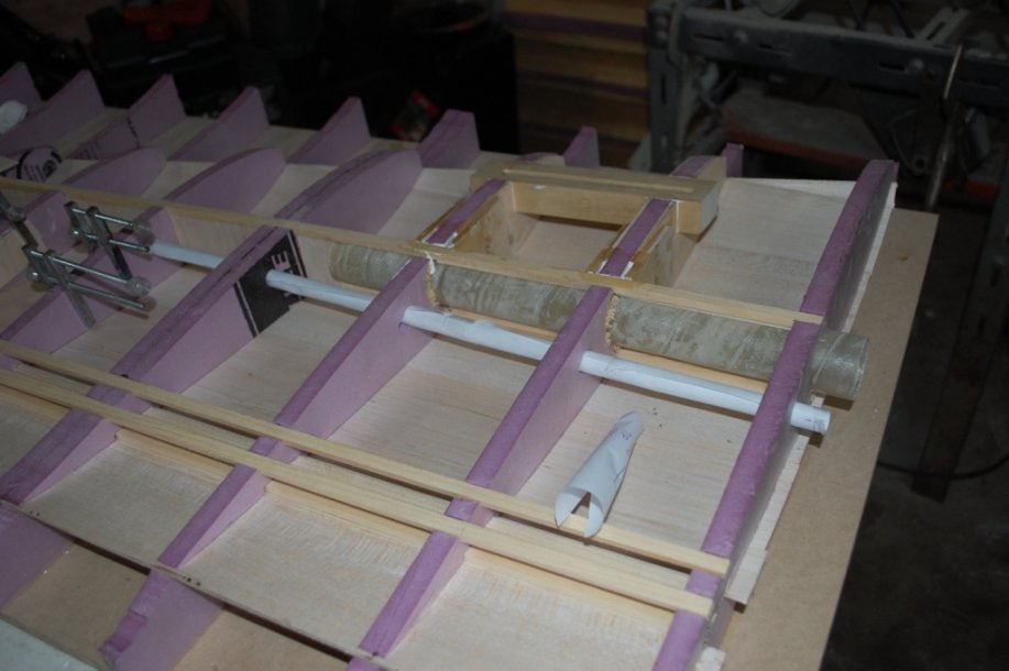

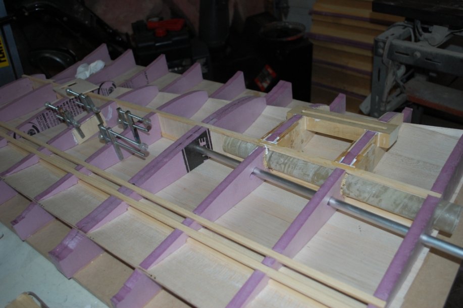

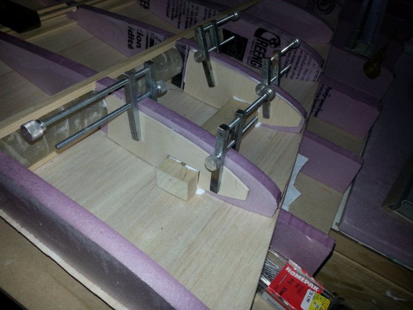

inside of wing panel just about done and then sheet it

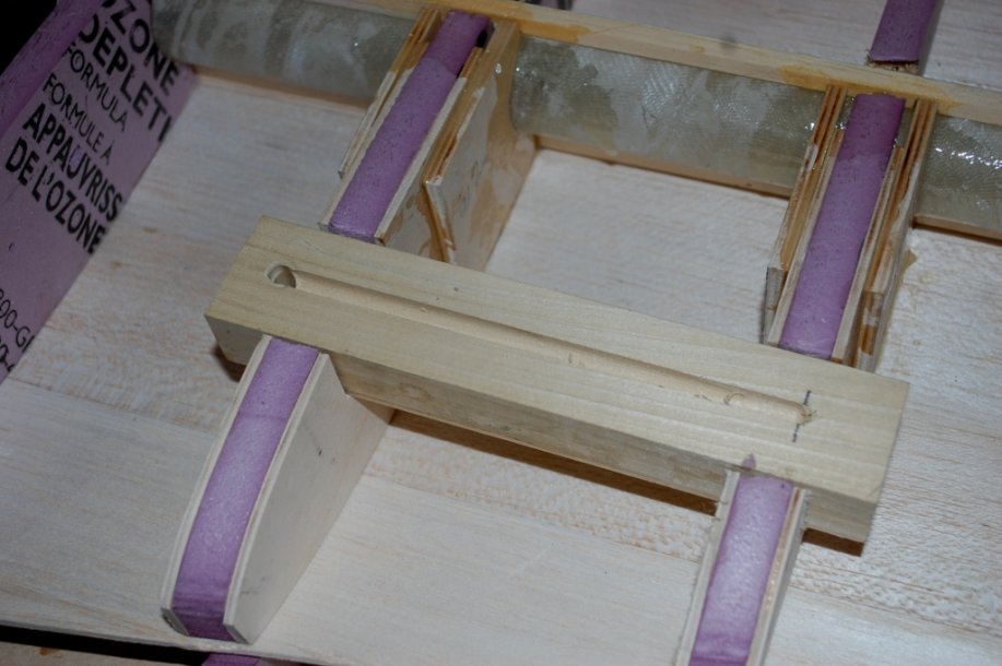

landing block since no retracts on this one, servo plywood installed
and paper tube inside for guiding the wires to the servo.

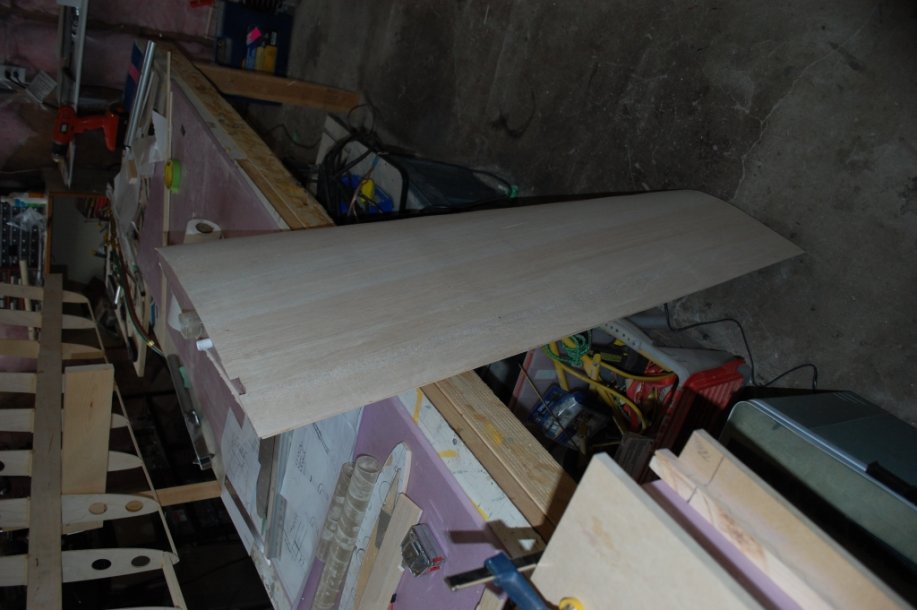

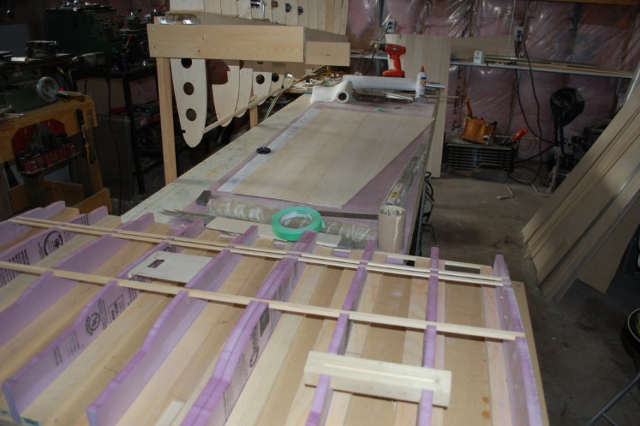

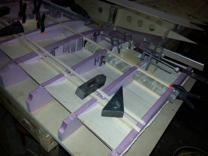

first wing sheeted and out, now for the second, then will work the innards, aileron, leading edge etc.
After checking it, it is as straight , and light as I knew it would

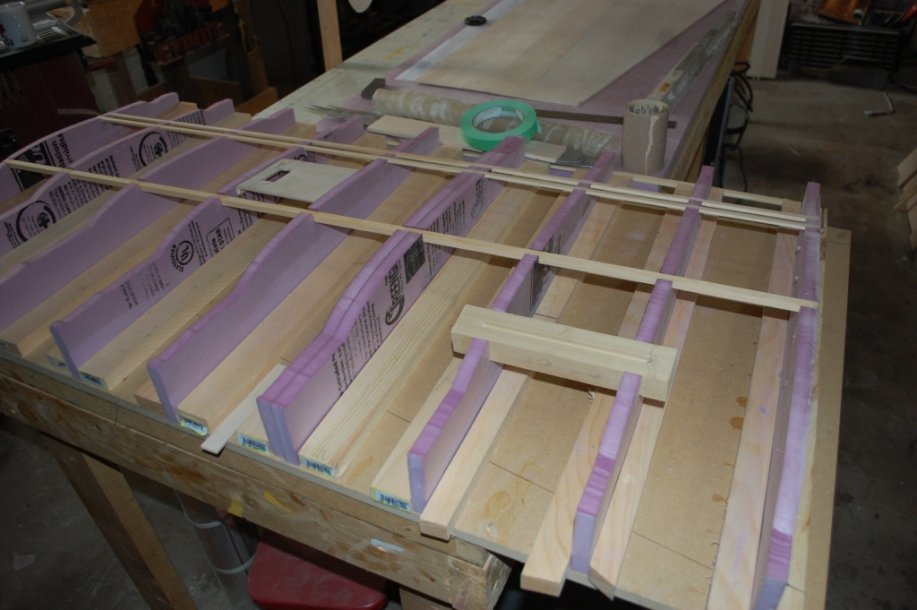

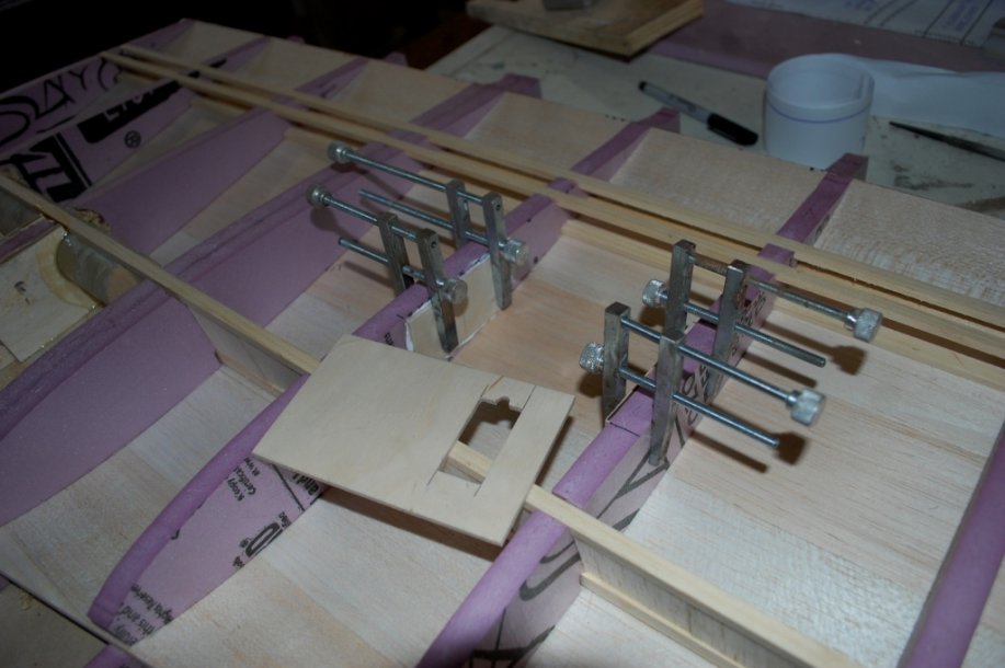

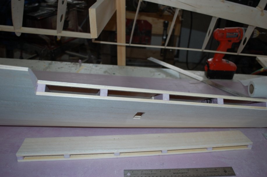

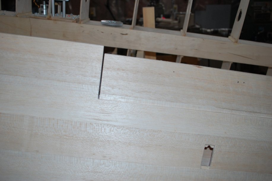

in these pictures , you can see the servo plate, and the landing block, , this time I am sheeting the underside first and the top next,

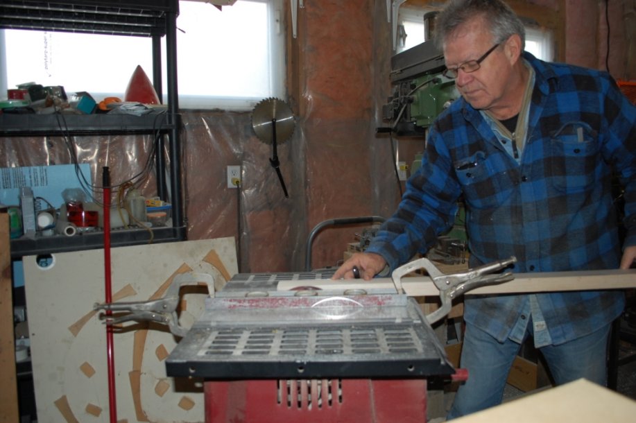

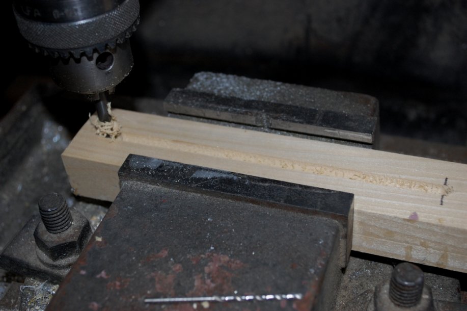

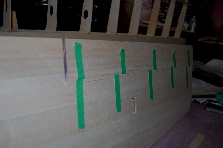

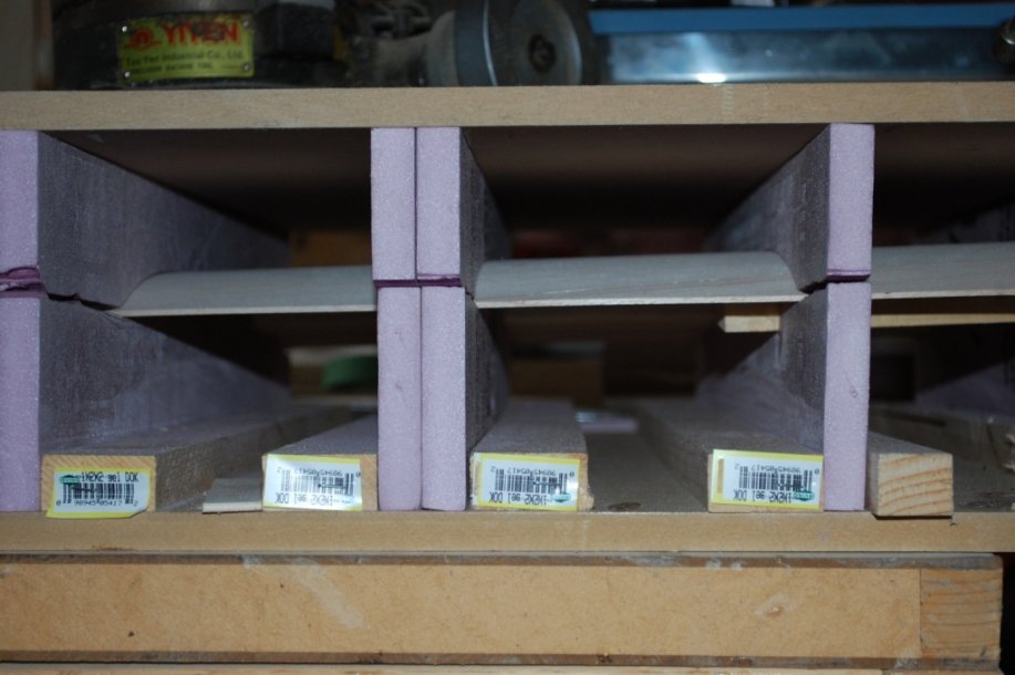

after preparing for second cut , I cut off the aileron, sanded smooth, sanded smooth also the wing leading edge , cut the proper thickness on my table saw from a solid balsa block the strips needed , then my buddy showed up so we ended up cutting the second side of the second wing,
