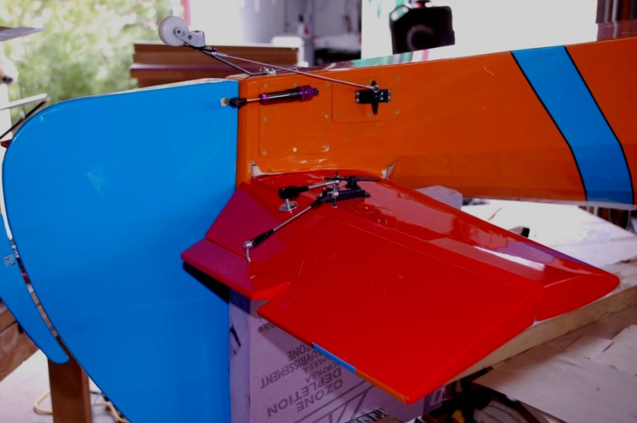

made hatches, have you any idea how hard it is to cover 1/64" plywood with plastic covering? LOL

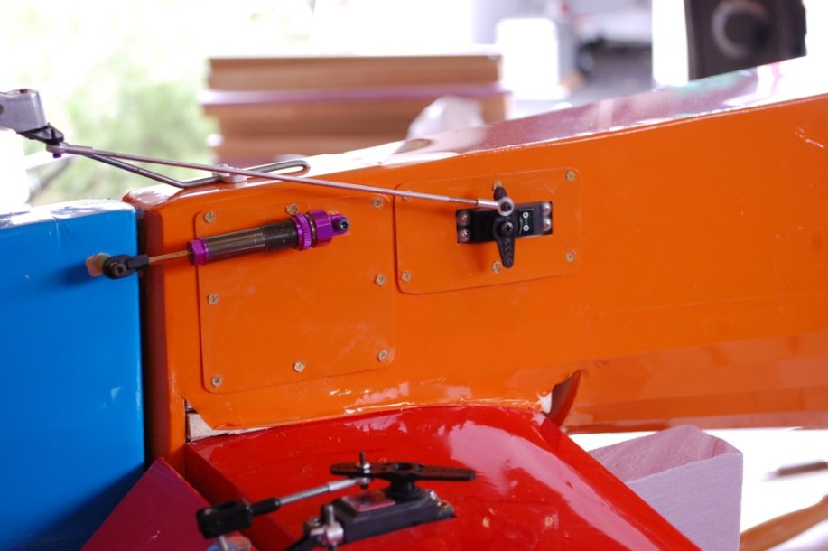

also while it was on its wheels, I didn't like the height , the prop clears ok but with the tail up, a bit close and we have tractors to cut the grass, so I made two new landing gear struts, and working on the maine Power battery installation for quick removal, ,

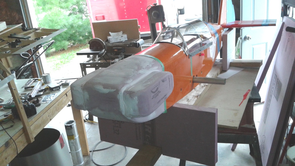

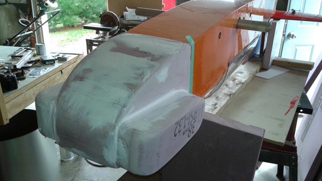

The cowl is also getting nearer to completion that is the carving
adding spakling filler , coming along fine, hopefully will start on the fiberglass this week

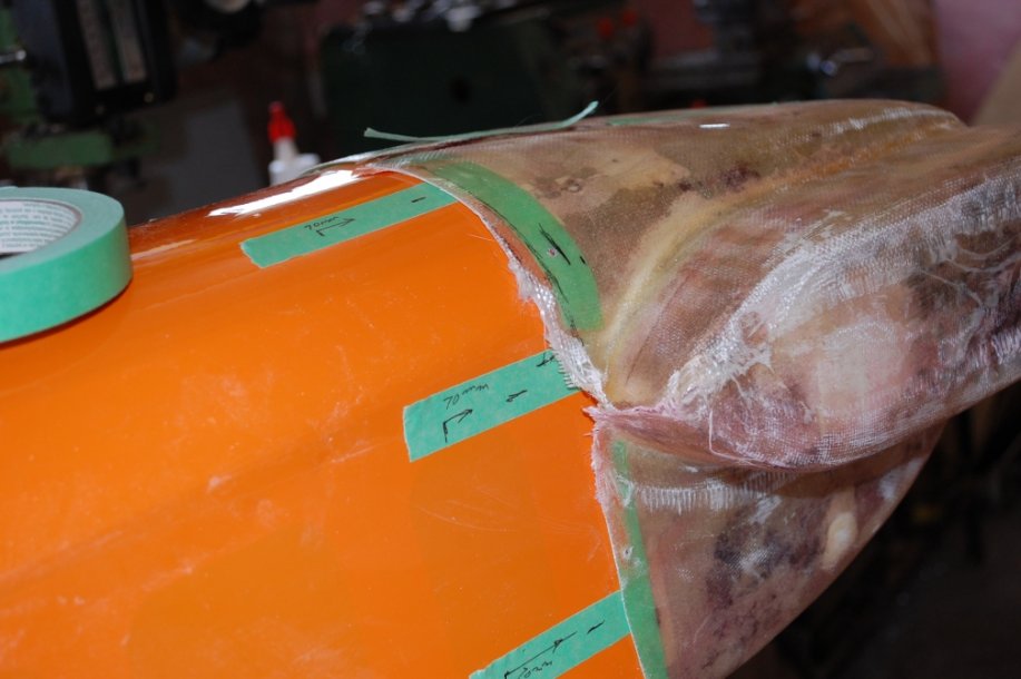

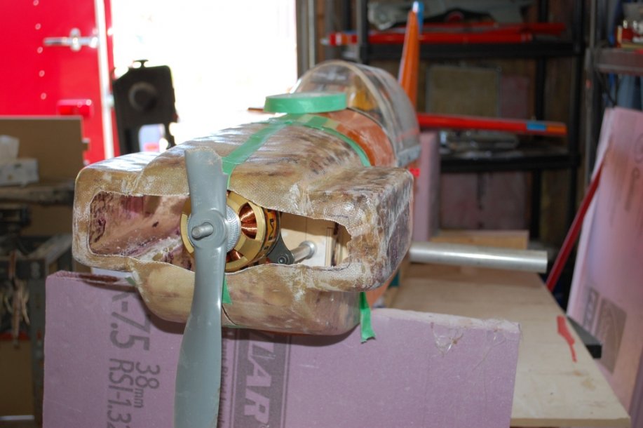

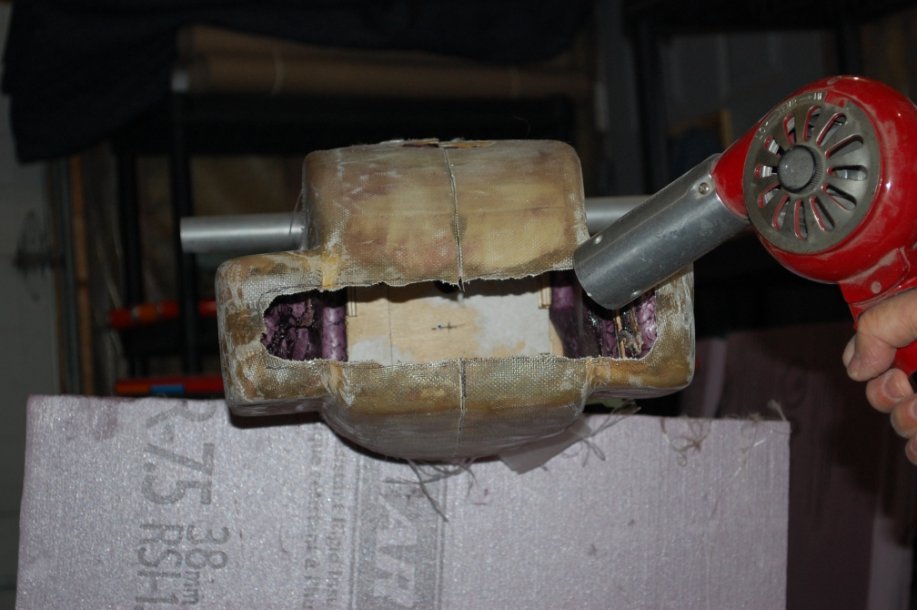

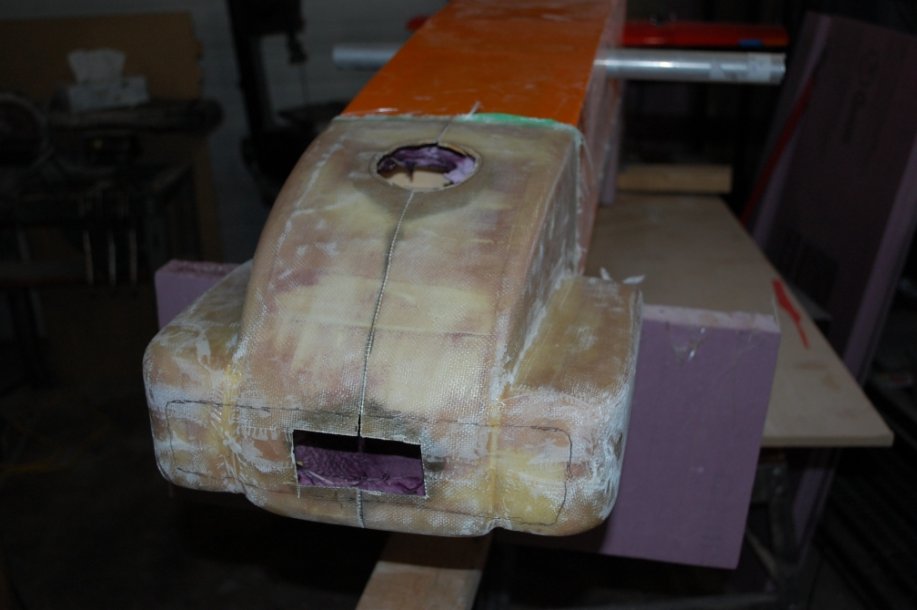

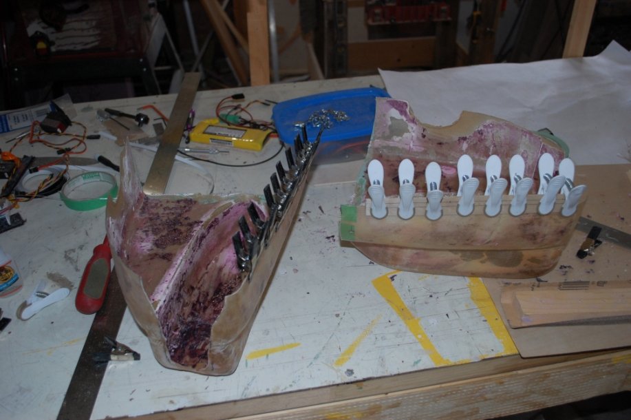

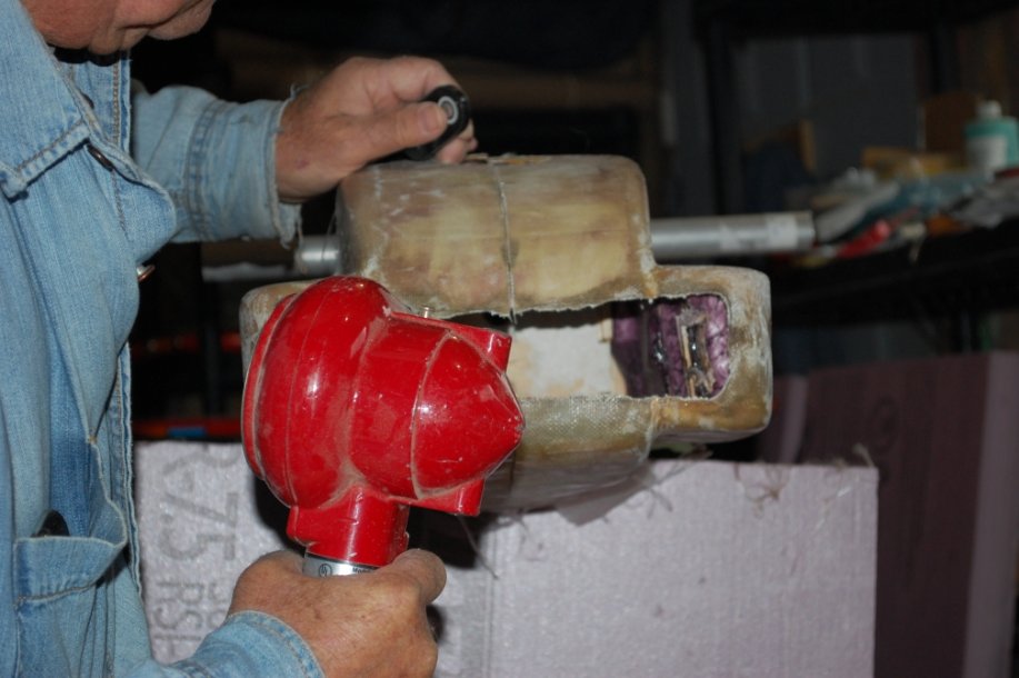

fiber glass done, and foam removed, not easy had to heat it from the inside to melt, then once off the fuse, used gasoline to melt but now its down and fitting the attach points, getting along, and on schedule to test fly this week, weather permitting
