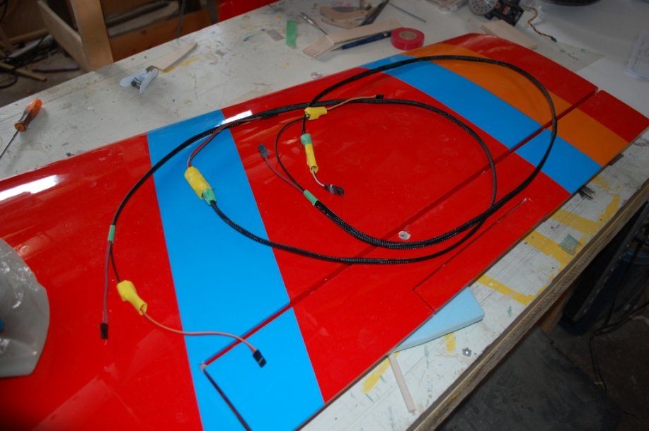

installing the motor with 2 degree right trust, and checking all fiber optics , you will notice a little pink knob in the middle, can anyone tell me what this is?

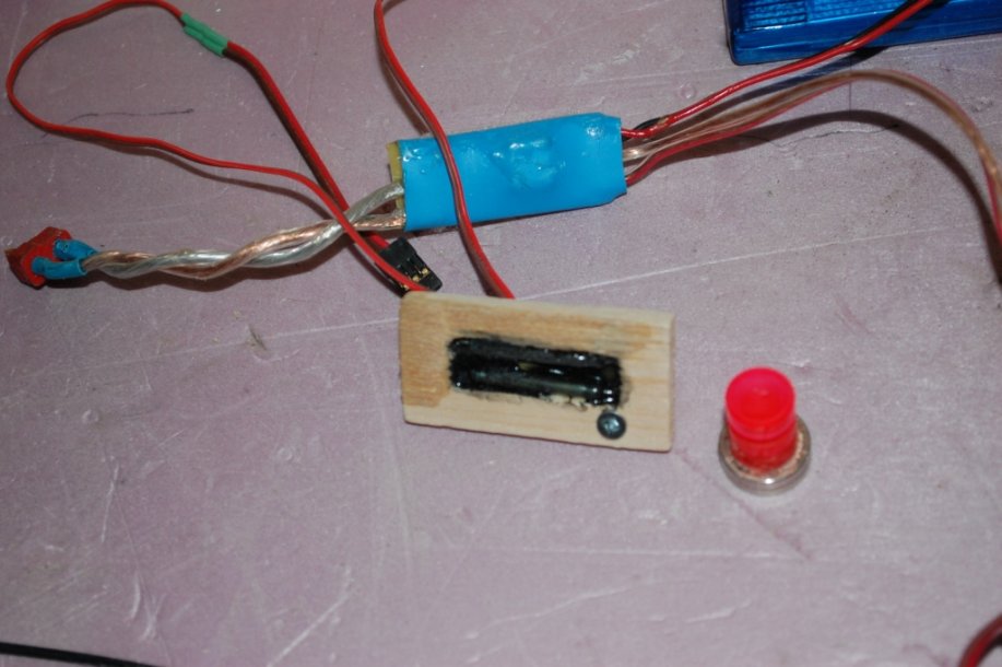

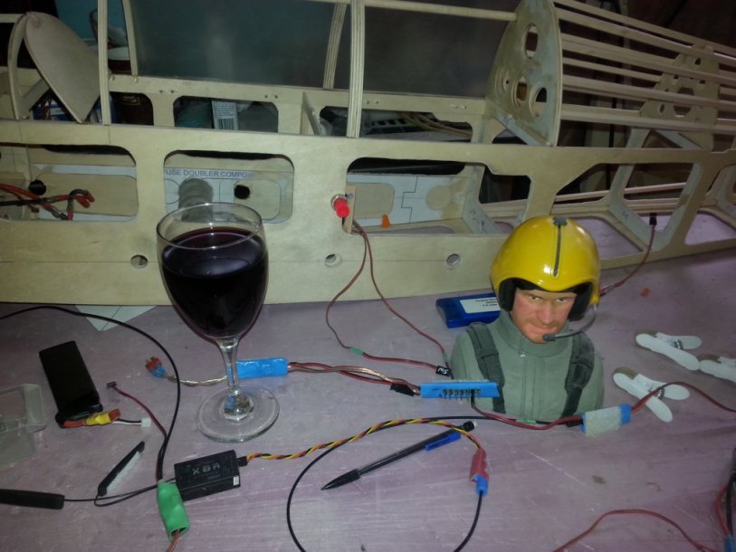

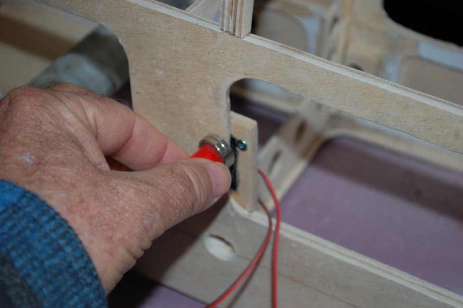

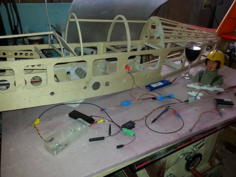

I'll post another picture later today, but its a magnet, the pink part being simply the handle . The receiver battery and servo battery both have a fail safe switch which is activated by removing the magnet from the hidden switch, so no visible switches.
here are a few more pictures of the magnetic failsafe switches
The second picture there is the magnet with the pink handle, just to the left of it are the two magetic switches, and on top of it in the blue shrink, is the failsafe mosfet (90 amp)

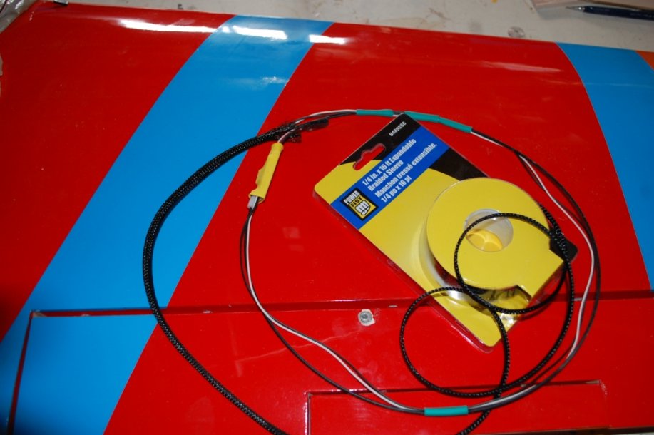

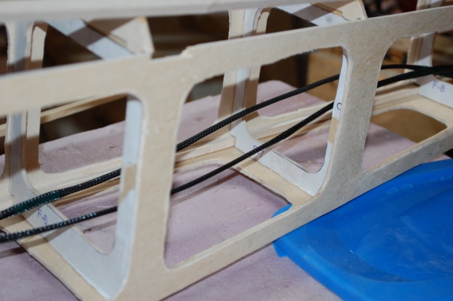

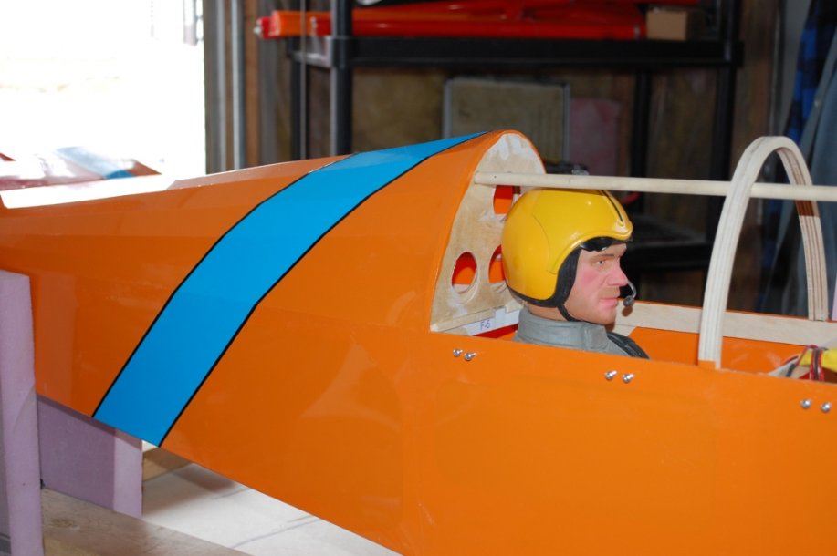

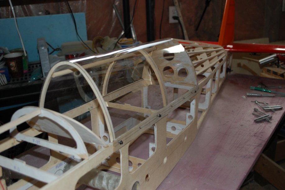

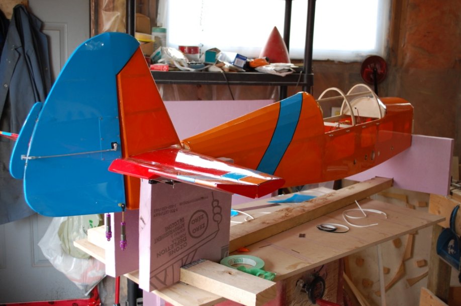

You can see it is rough for the wires and fiber optic cable to run in the back of the airplane, so I am using this braided mesh to smooth things out , also have finalized the canopy installation.
