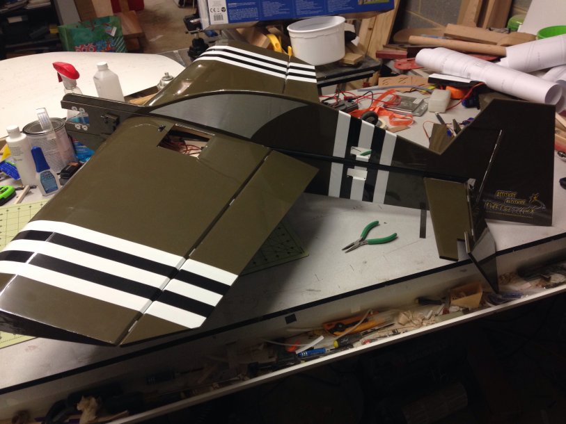

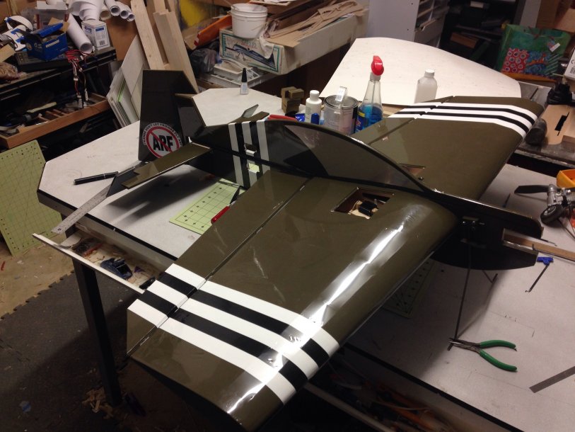

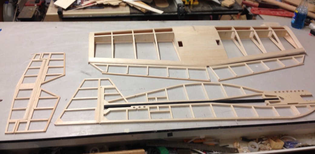

Mojo40 ready for sanding. As it sits 18.6oz.
The motor mount will be glued to the tube and wing with epoxy. The tube to fuse joint will be tacked with medium CA and then followed up with loctite GO2GLUE.
