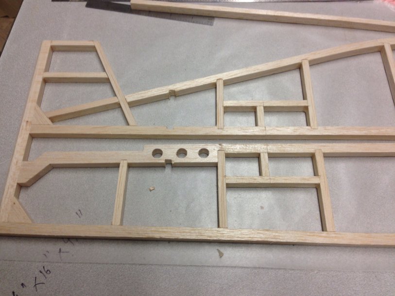

Start of the mojo. Most important part was to trace all the cut parts as I know I will need another at some point. I will get more pics tonight as I have the rudder stab and elevator all framed as well and the wing is ready for sheeting. Not as much as I wanted to get done today but it will have to do. Had other things come up like getting the white and blue slime scheme profile shipped to its new owner in Texas, work on gifts for the wife, and go get our tickets for the 1PM showing of Star Wars on Saturday. Should finish framing it tomorrow and have it ready to cover.

Nice! Does that one use the 1/2" fiberglass tube in the fuse?
Yup. 3/8" thick fuse with a 1/2" tube. If I don't repair my old one I plan to tear it down and salvage to tube out of it.
Thin and medium ca through out. Tube will get glued in with loctite brand Go2Glue and the motor mount will be epoxied. They are not glued in in the picture just sitting there so everything gets framed correctly.

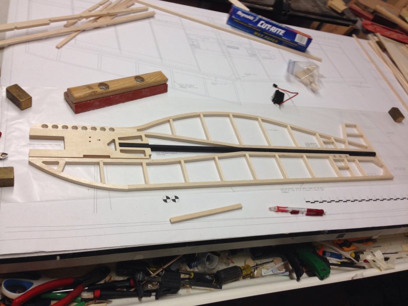

Ok slight change to the fuse. My previous mojo was way tail heavy. I relocated the tail servo bay up one and will mount the servo as far forward in that bay as possible. This will give me the ability to move my flight battery to adjust the cg.

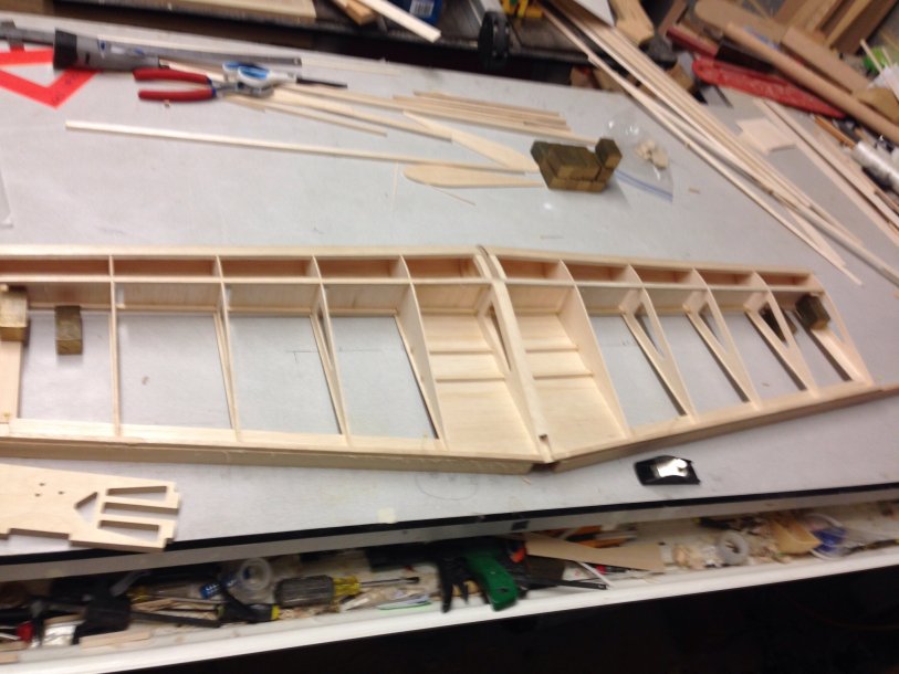

Wing bottom is sheeted and wing is flipped over and ready for the sheeting on the top. Got the LE sheeting wrapped around and that's it for the night. Starting to see double so it's bed time.
