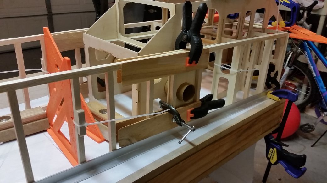

Looking good ROLLERMAN. Question: The notches in the squares that you used for clamping. Did they come that way or did you customize them?
Keep up the great work!!
JB
ROLLERMAN
Hello Jason, Thanks, and I customized them myself, they are very easy to cut.

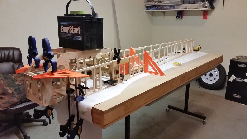

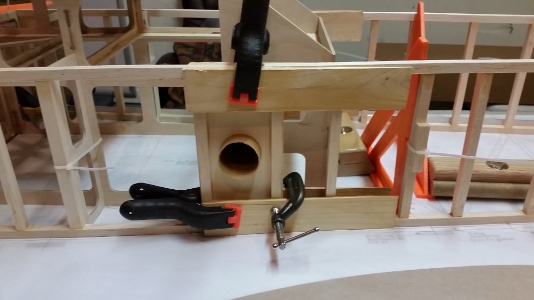

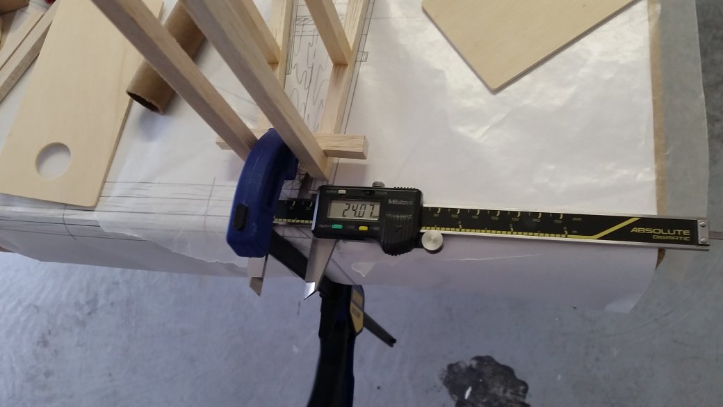

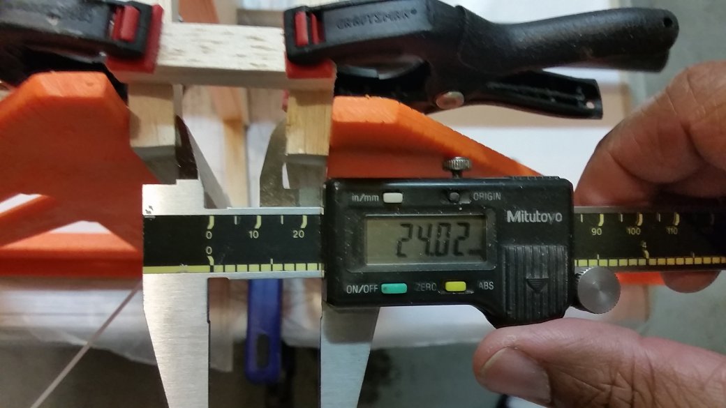

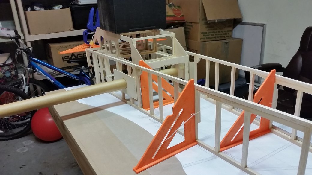

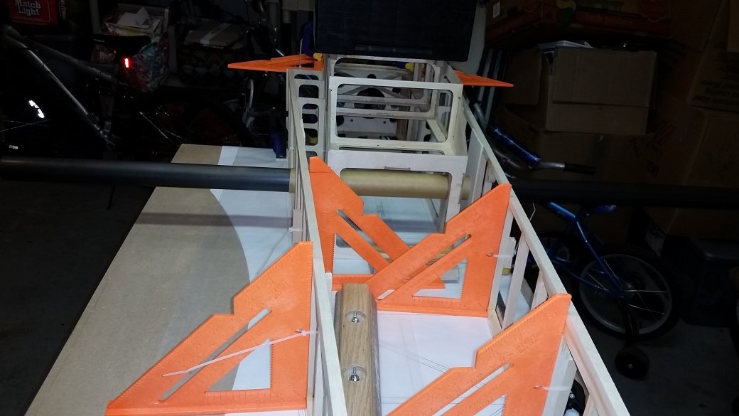

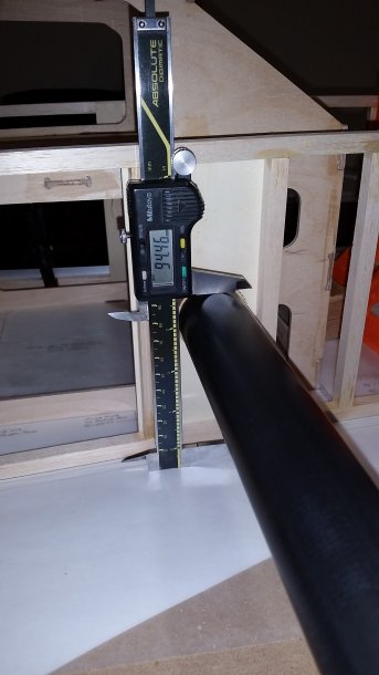

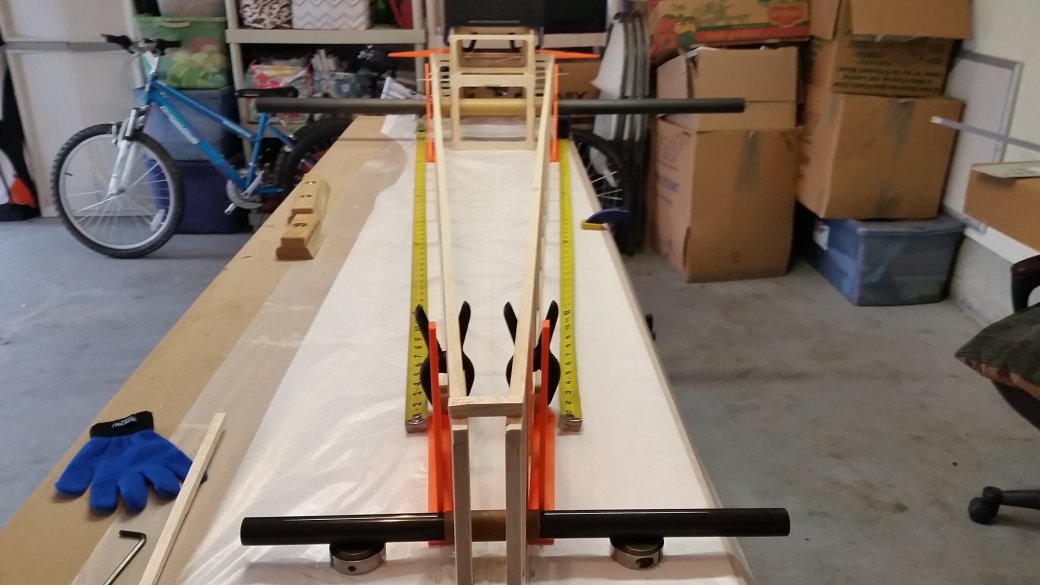

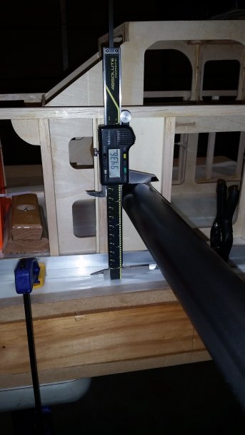

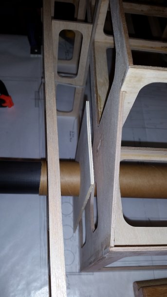

Hope everyone had a great weekend, so after all my house work and family time, I manage to get some work done on the PRO, I decided to use 3M epoxy on the wing and stab sockets, I figure why rush it. (Do it once do it right!!!!!) Since I spent so much time setting up the fuse sides in place I decided to glue the sockets while the sides were on the bench in their proper place or very close to it. Once I was happy with the setup, it was time to glue them in place. I follow pretty much the same procedure for the stab socket making sure it runs parallel to the wing tube. The pictures will explain this better.
