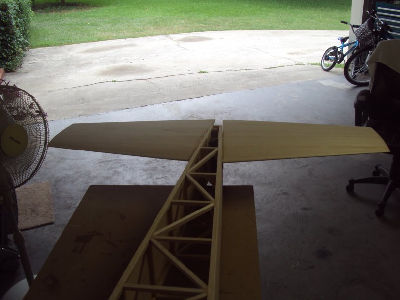

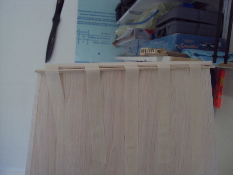

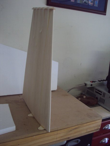

It’s looking like a plane now, I have both stabs ready, once I have the wings done, and I’ll set the incidence on all feathers at the same time. First a few pictures of the stabs end caps. I used gorilla glue to glue them in place.

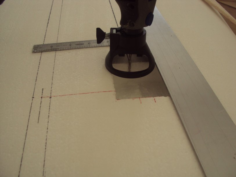

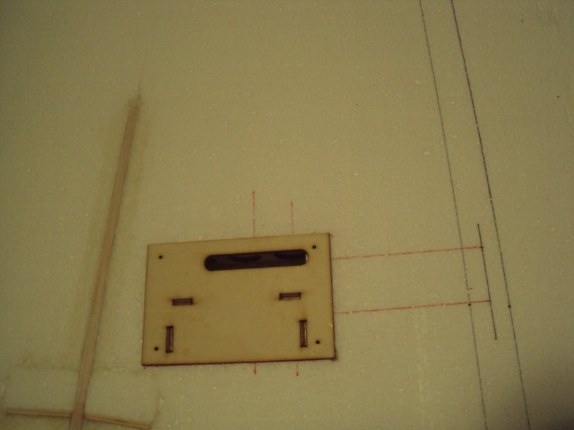

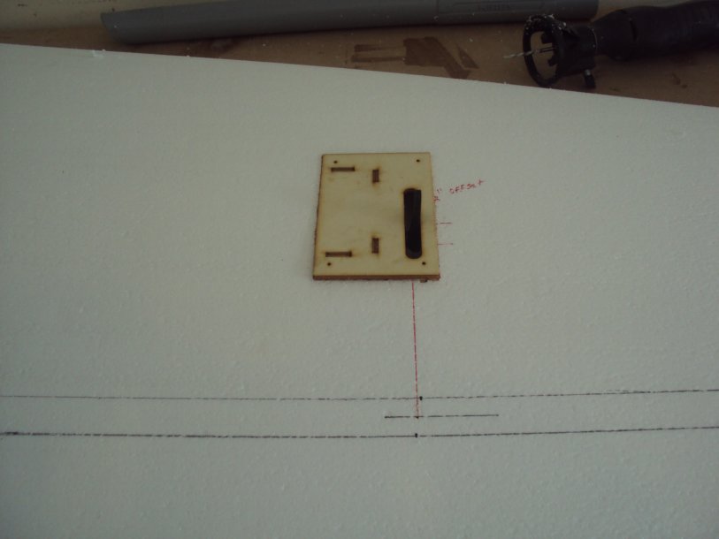

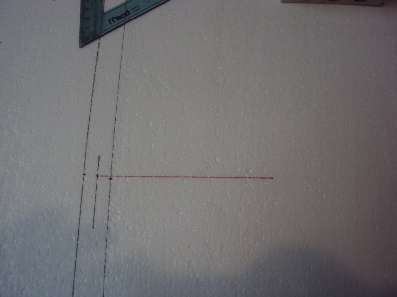

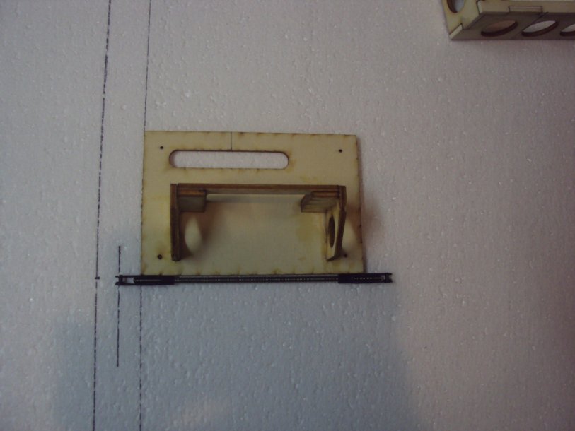

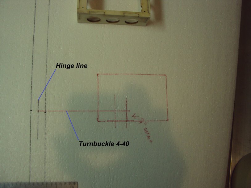

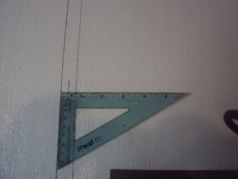

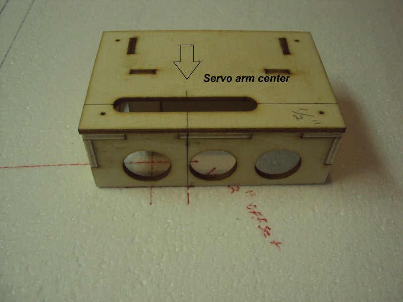

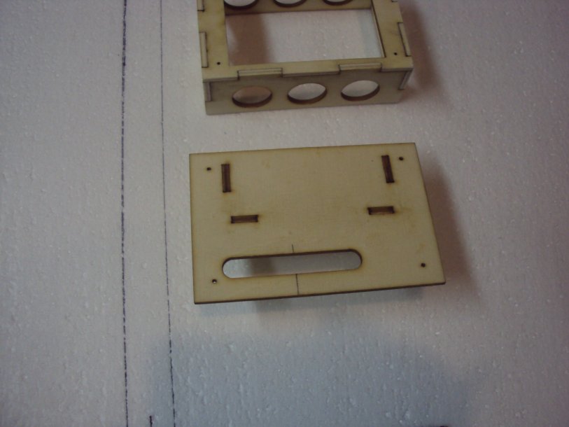

So now on the wings, first, mark the ailerons and locate the hinge line. My next step was to locate where I’m going to cut out the foam for the servo boxes. I located on the box where the center of the arm will be coming out as well as the offset and I transfer that to the foam. The picture will explain this much better. I hope to be vacuum bagging the wings this weekend.

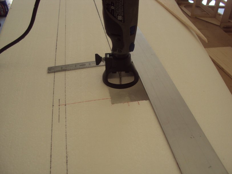

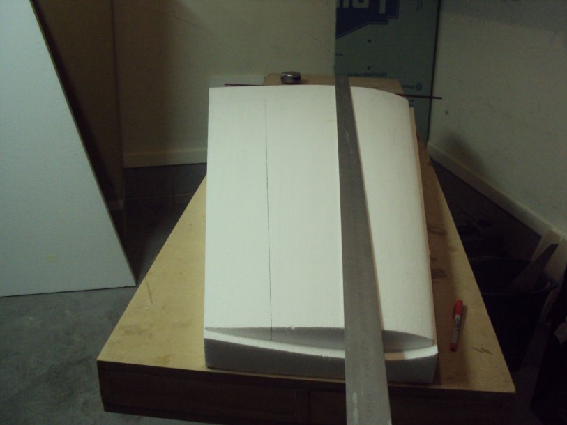

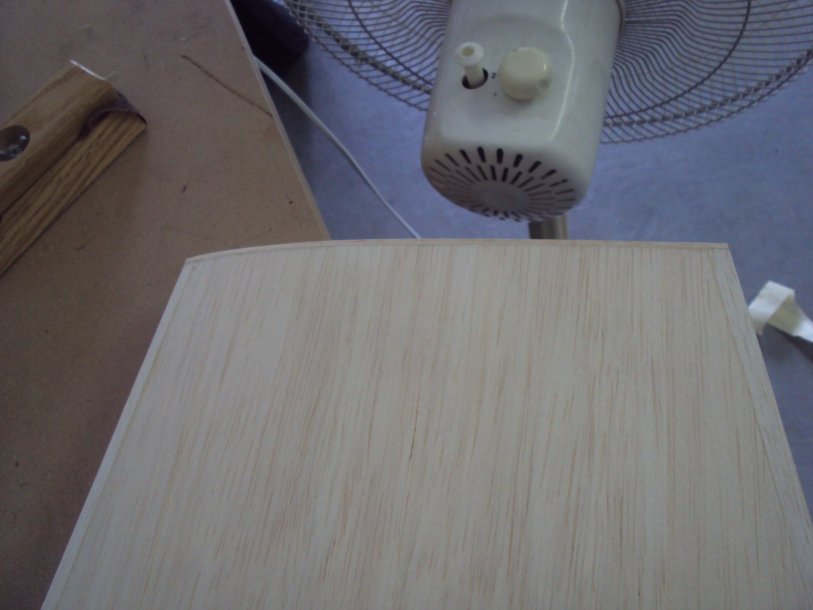

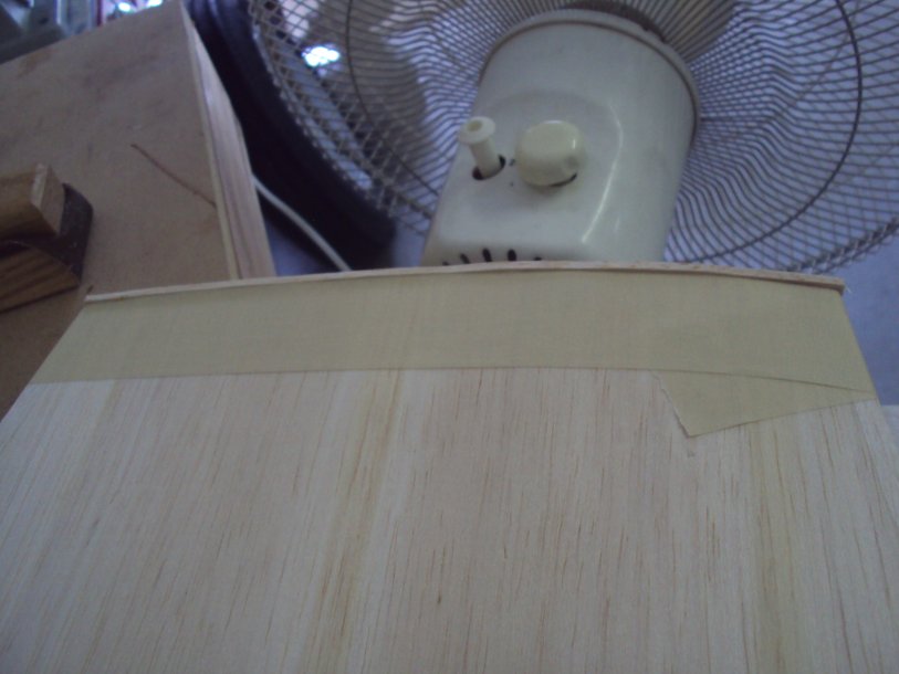

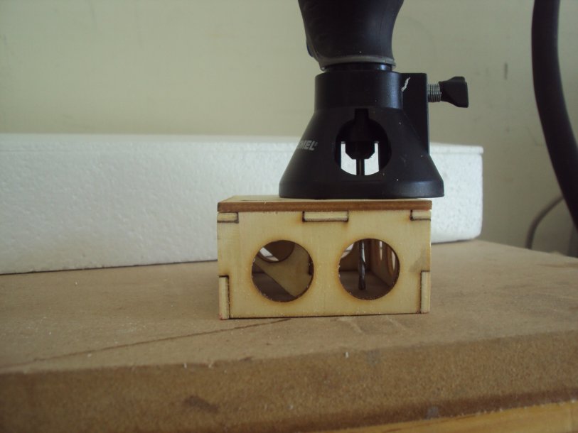

One step closer, I was able to get one wing sheeted, but before that, I located the servo doors and cut the foam out as well as the servo wire slot. The other thing to make sure before sheeting is to check the root end against the fuse; I didn’t have to do any sanding.
