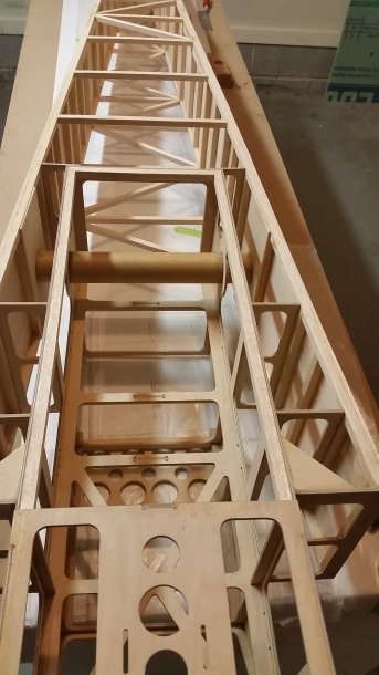

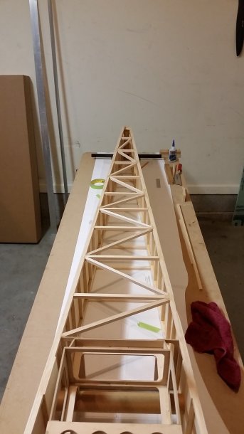

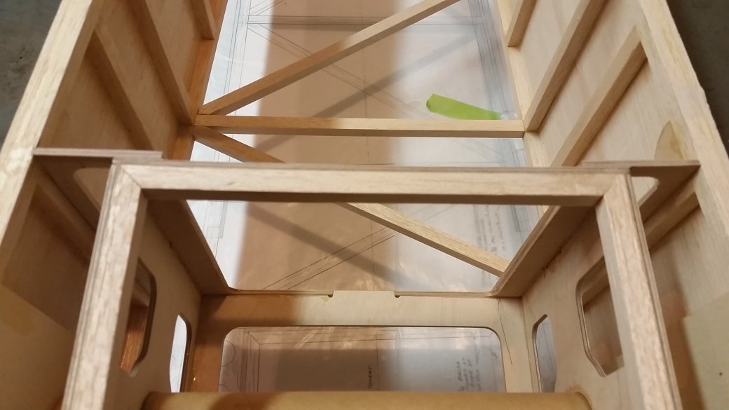

Picture of the fuse.

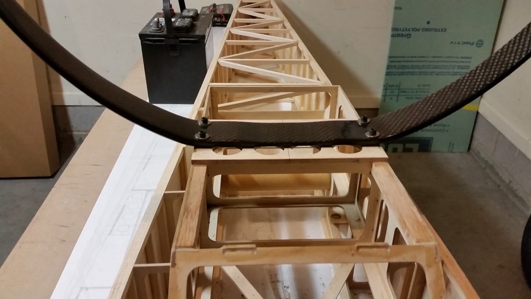

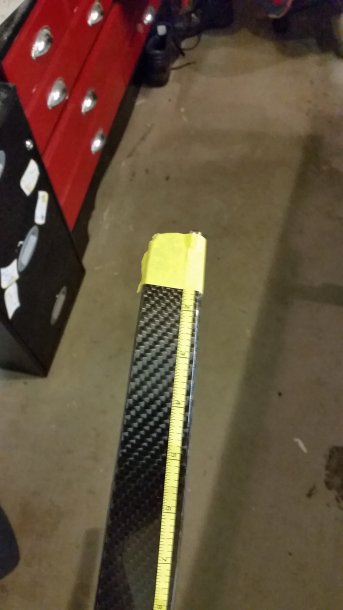

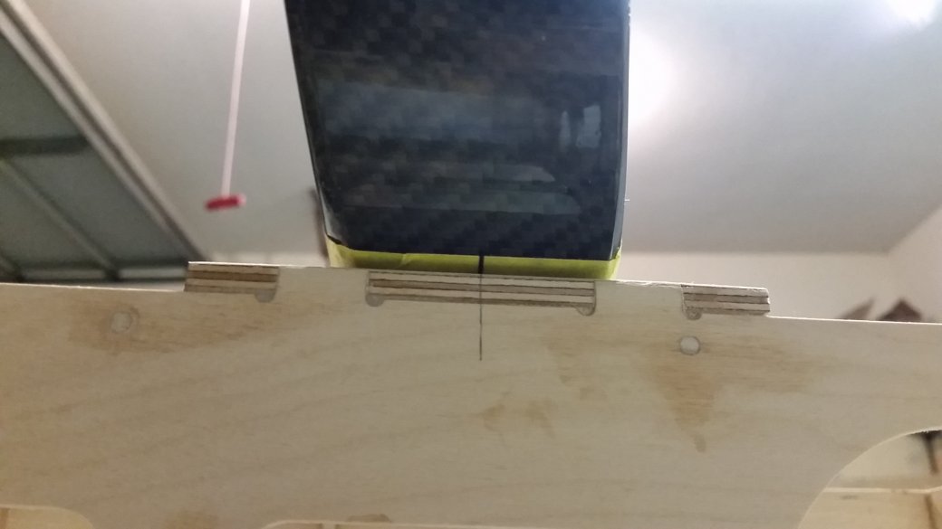

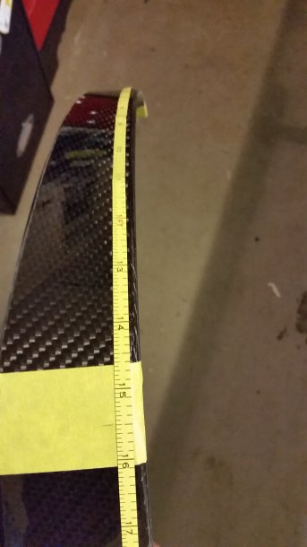

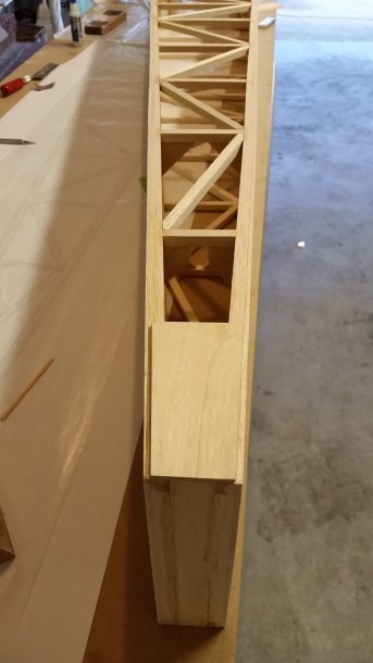

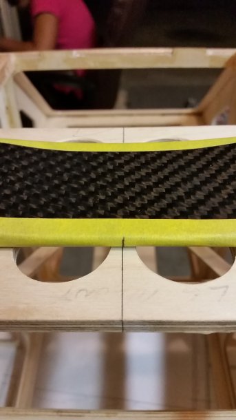

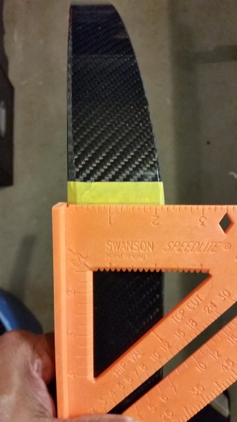

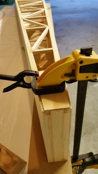

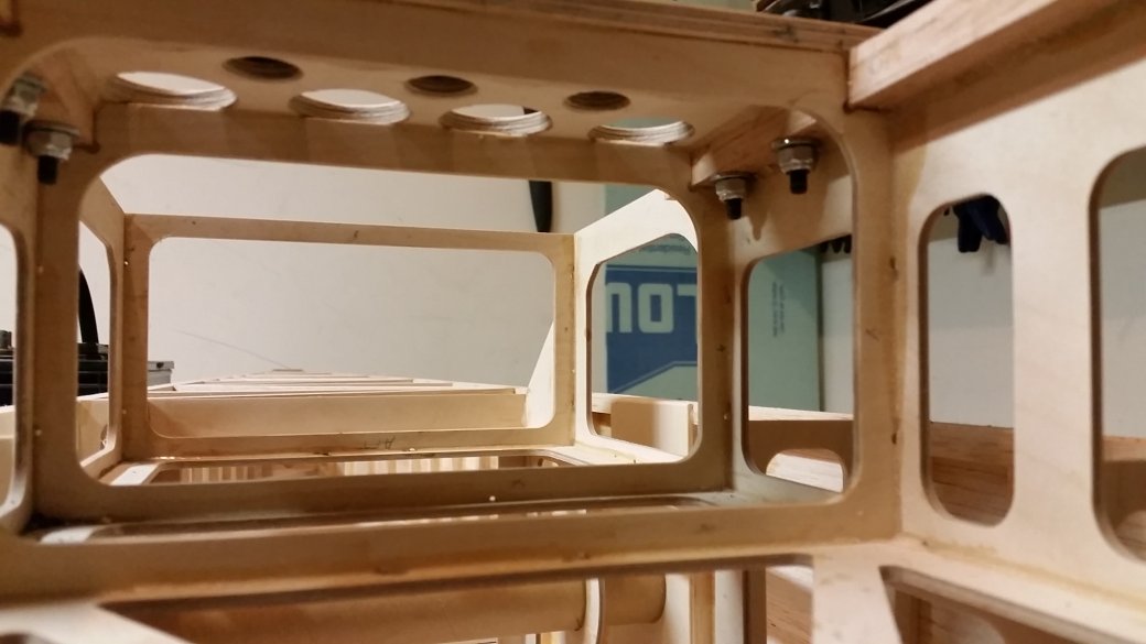

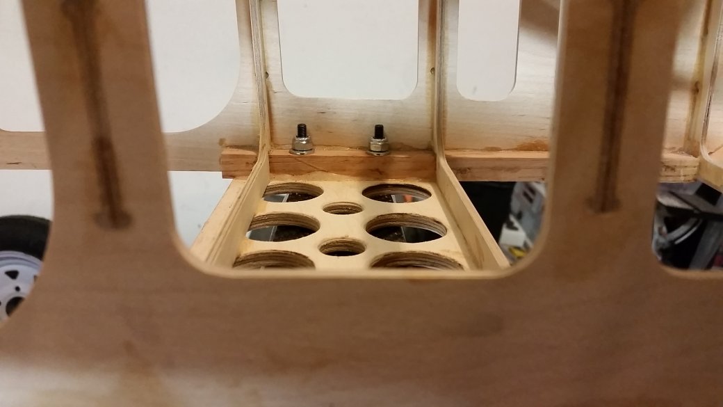

Well this was a Golf weekend for me so I only worked on it a little, I got the tail wheel plate glued in place, sanded the tube socket flush with the fuse and I marked the landing gear. I will be using 10/32 bolts with lock nuts. The plan calls for 8/32 taped on the hard wood but I do not trust that set up.

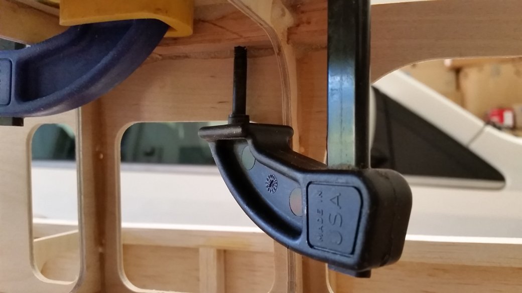

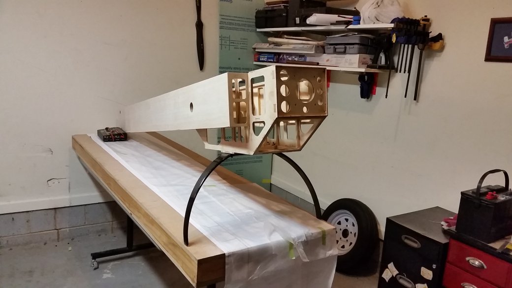

So far I have about 80 hours of building time since I got the kit 34 days ago. I have the tail wheel to install tonight and I may start gluing sheets together for the skins. I’m planning on going to Joe NAll next week, from Wednesday till Saturday (POOR ME RIGHT?) so I will lose some building time there. I’ll be picking up all my hard-wear while I’m there.

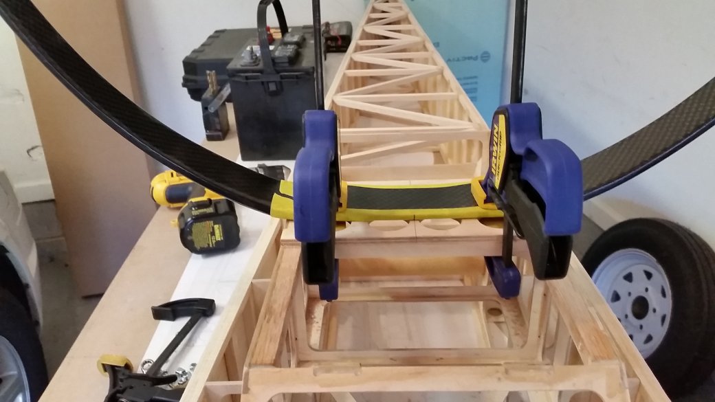

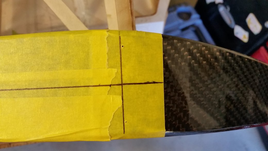

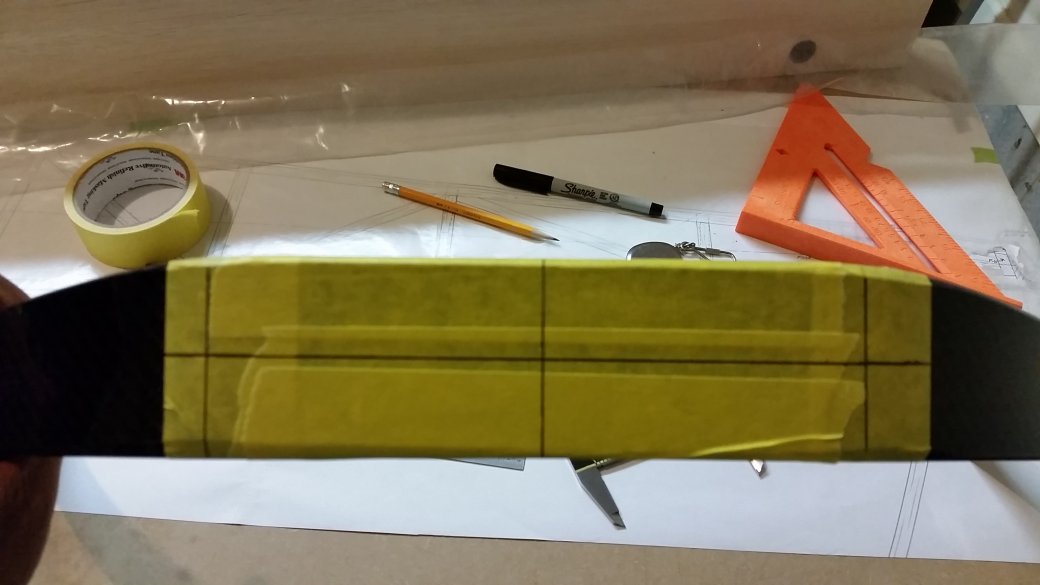

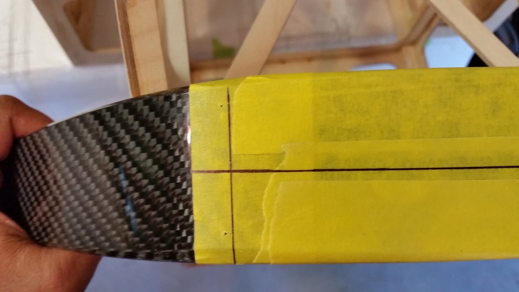

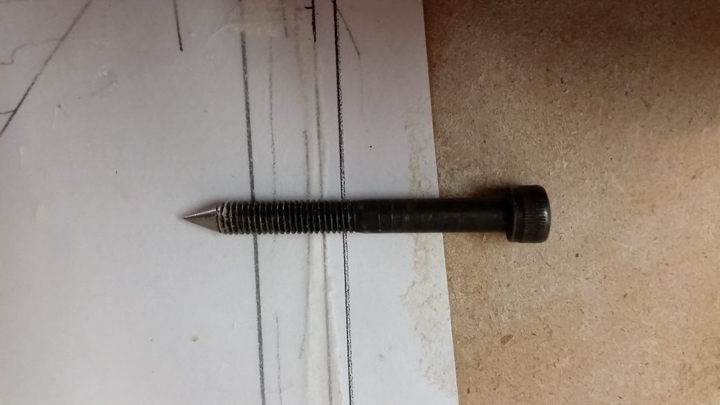

OK, now for some pictures. I drilled out the holes on the landing gear blocks in three steps to make sure the hole didn’t wonder off. I made a center punch using a 10/32 bolt so I could insert it from the inside and mark the landing gear; I used a clamp to press the bolt against the bottom of the LG.
