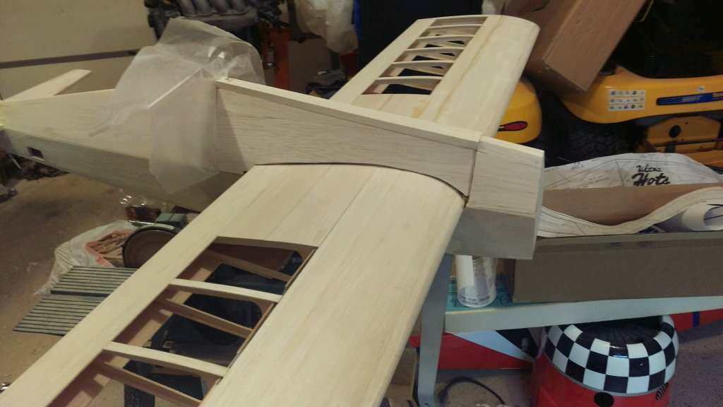

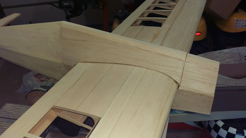

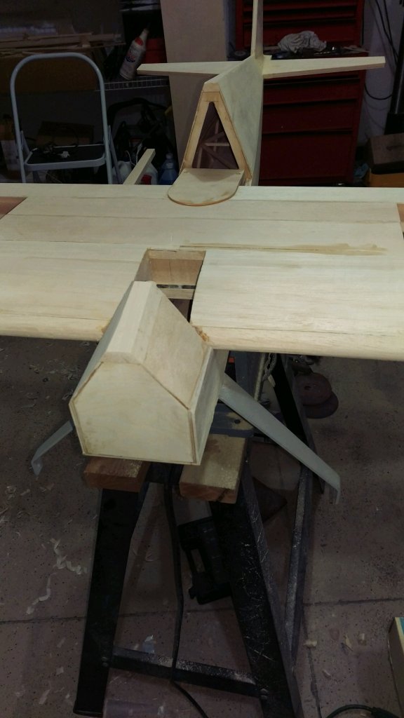

Rear turtle deck added after I cut in swervo holes and glued in ply doublers for the screws.
I added a little of that wood putty I mentioned earlier after a good sanding to fill in any gaps and make the fun to stab area look good.
Lots of sanding ahead!

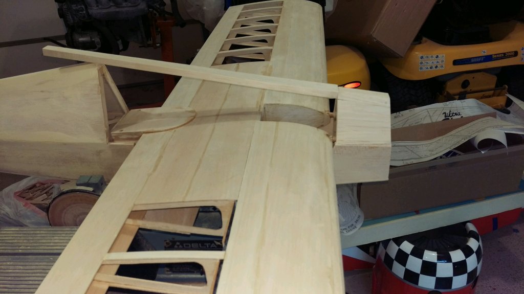

Hatch rough framed. Now just gotta figure out how to attach it.
This whole airplane has been kind of a royal pain to build.....
But I guess at this point it's all rough framed now just gotta work out the details.
capthis

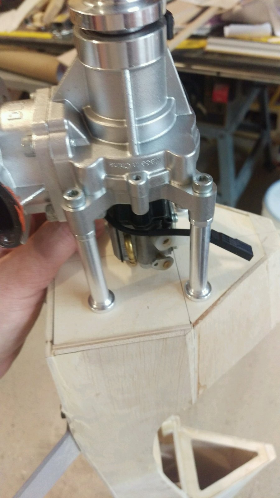

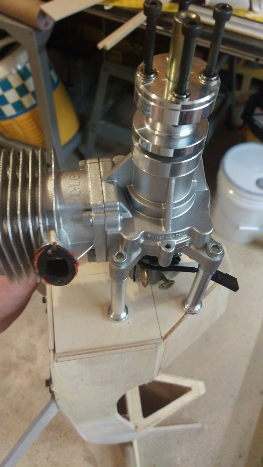

Next issue is the motor mounting. Everything is supposed to all be on the same line. Motor, wing, and stab. Problem is my top motor mounts won't hit the firewall....
I see two ways of dealing with this. One is to lower engine about 7/8" this would be the easiest.
Second would be to build a firewall with tabs and attach it to the existing firewall. Kind of ugly but it's do able.
Any thoughts here? Is an inch going to kill flight performance?
Thinking outside of the box a little. What if you mount the motor at 45 degrees. Put the head at 7 or 8 o'clock position. Might cause problems with the exhaust?
