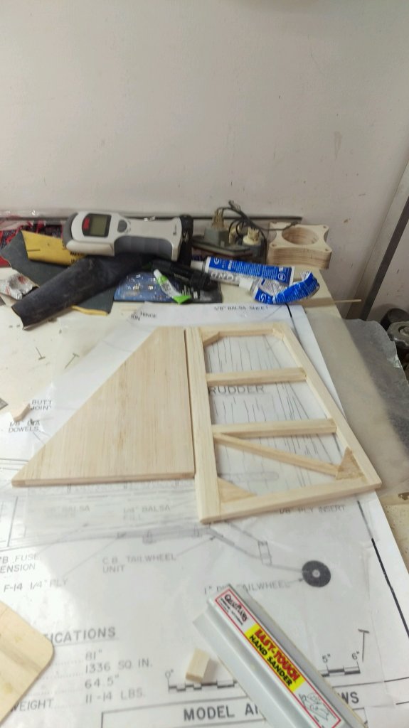

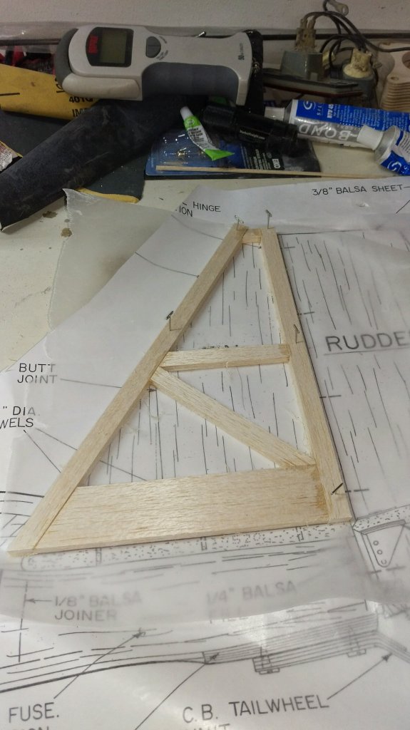

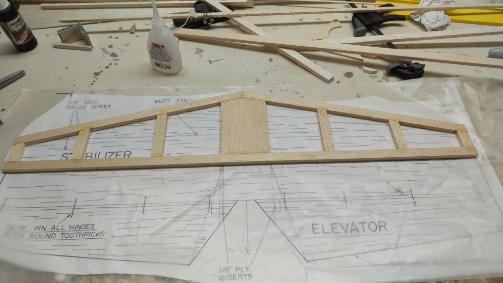

Vertical stab and rudder built. Plans call for 3/8 sheet stock. I went built up. Stab is 1/4" sheeted with 1/16. Rudder was slightly enlarged.

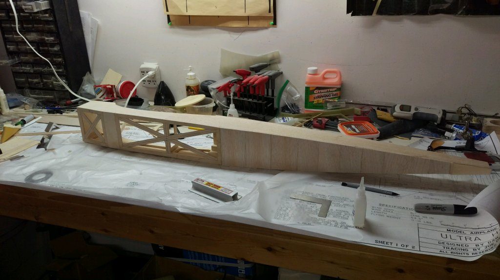

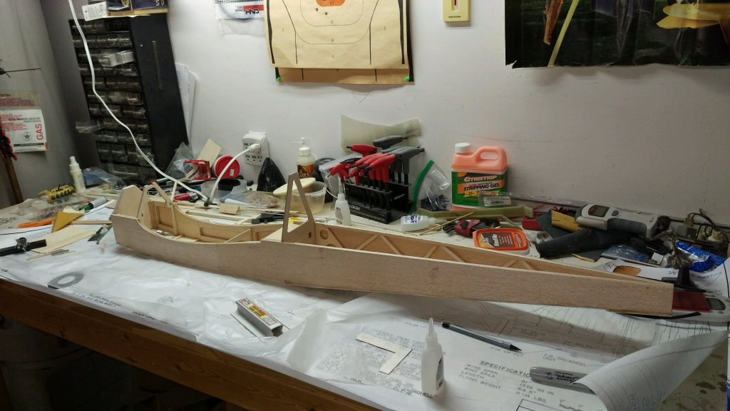

I also got a good start on the fuse. I cut my middle ply doublers out like my inner ones. My scale battery is dead so I didn't get a chance to weigh what was removed but I would guess about 2ozs.
I forgot to take a few pictures as I went along but here's where it is at.

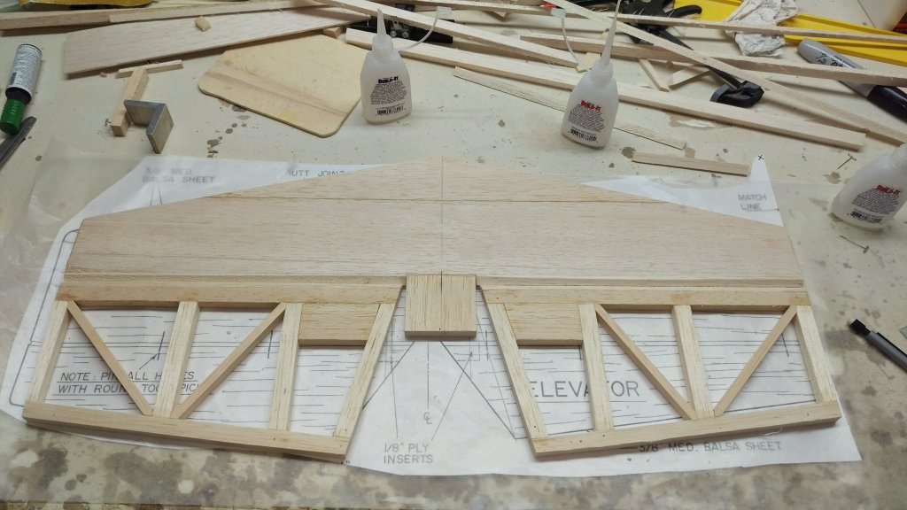

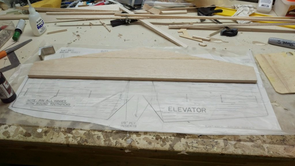

Built the elevators. Plans for the stab are off so I had to pin both elevators together and then sand them. Also straighten my stab ends up square with the trailing edge. Old hand drawn plans that's been copied a few times aren't perfect....

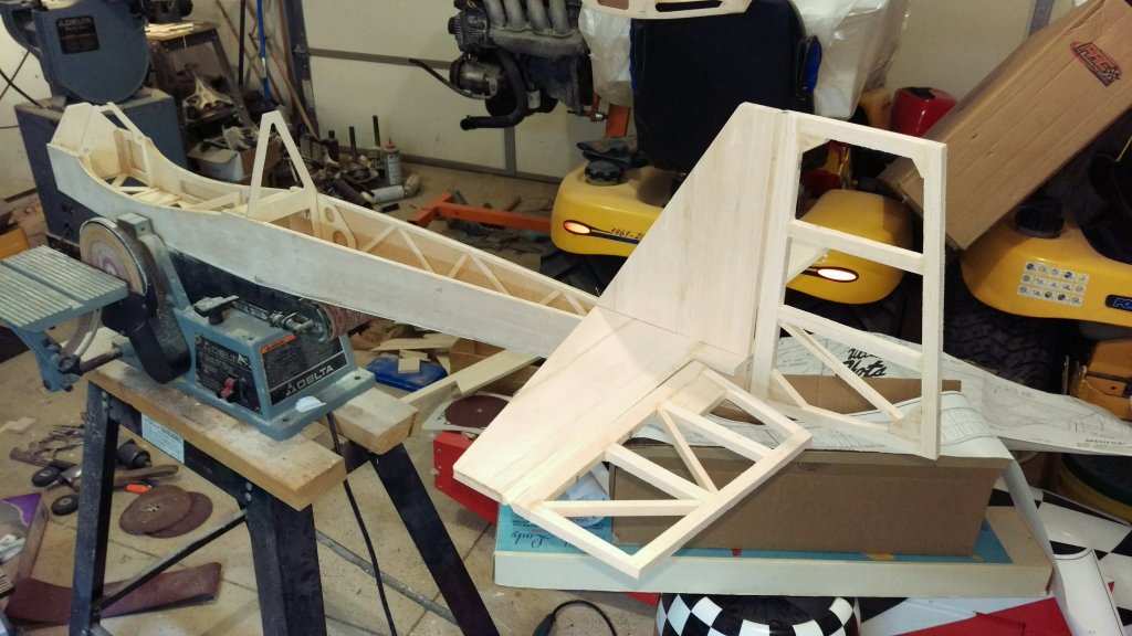

Mock up of the tail feathers. Think those tail pieces will work? Don't want to get accused of not going big enough :)
