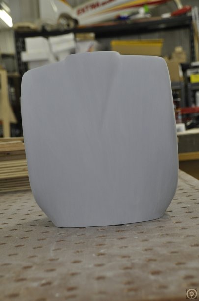

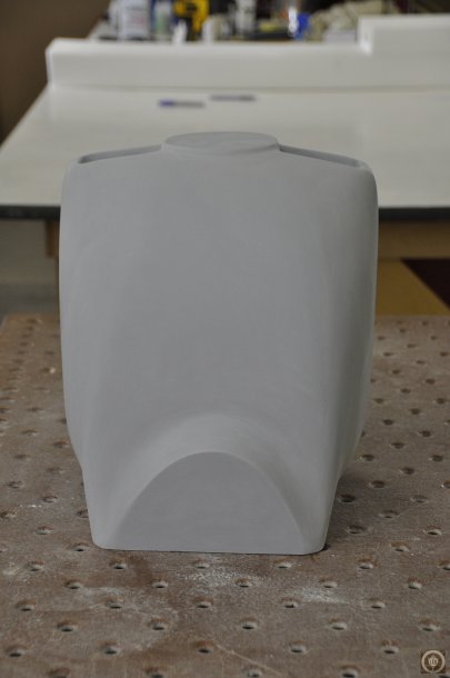

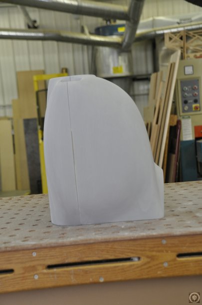

BUT, I just finished the final sanding and am going to shoot clear!! So that means we are a week or two away from getting some design work done on paper. I've been gathering notes and once I have made an actual cowl / cowl ring I plan to dedicate a couple days of solid CAD work to draw the fuse and get things started.

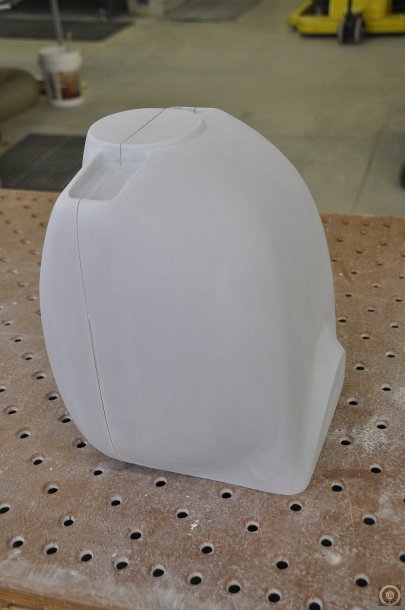

I have to say I was not liking the looks of it until I got it all one color, now I think attached to an airplane it will be pretty darn cool.
I'll feel better when I get it out of the mold and can lay up parts. That bottom part still has me worried. I'll probably lay on a couple extra coats of PVA so worst case I can squirt some water between the plug and mold and dissolve the PVA to release it.
