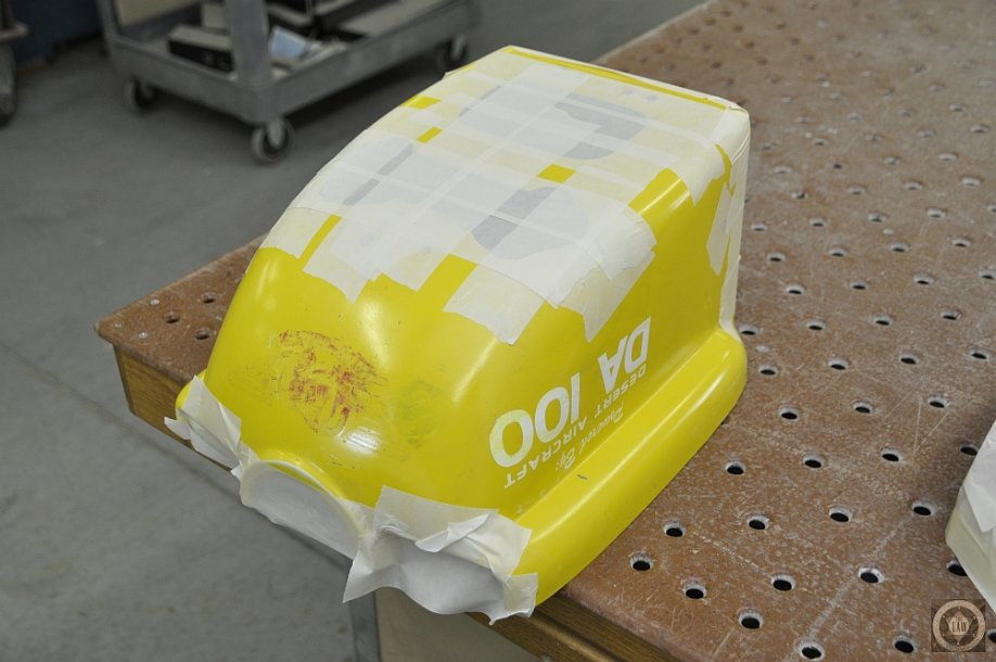

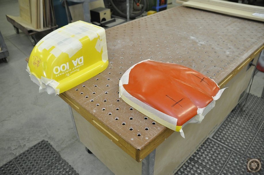

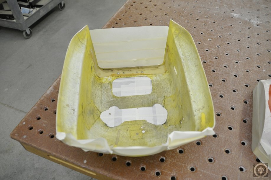

I have been kicking this around for a year or two now. So, a friend told me about a sale where there was a variety of things. So we piled in the truck and drove 300 miles round trip to pick up some stuff and I picked up this old CAP cowl that is really really beat up and honestly is pretty ugly. I'm going to be modifying the front, the sides, the bottom and completely changing the F-1 former shape. Widening the backside at least an inch and also setting it up so the cowl ring can be flush with the back of the cowl. Even after I bathed this thing in lacquer thinner to wash out the dirt and junk it still weighs almost 24oz!!

the bottom of the real cowls isn't as boxy as that one that you have. the snorkel probably ought to be there but doesn't have to be as pronounced as it is in that first photo.

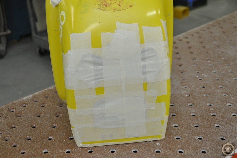

and i see you do what i also do to rebuild old snotty cowls with the masking tape. i was going to make a video about doing that for the beginners' area.
it's amazing how small a Cap 232 really is.
This one I'm just basically filling, There are going to be really large chunks of this cowl removed, and re-shaped, but you are correct.....I've done some pretty extensive re-work on cowls before with tape, milled fibers and resin. If you do a thread I'll try to chime in. I just got a PM from a GSN member this AM that I "might" be helping with a little repair on a huge cowl yet this winter.
