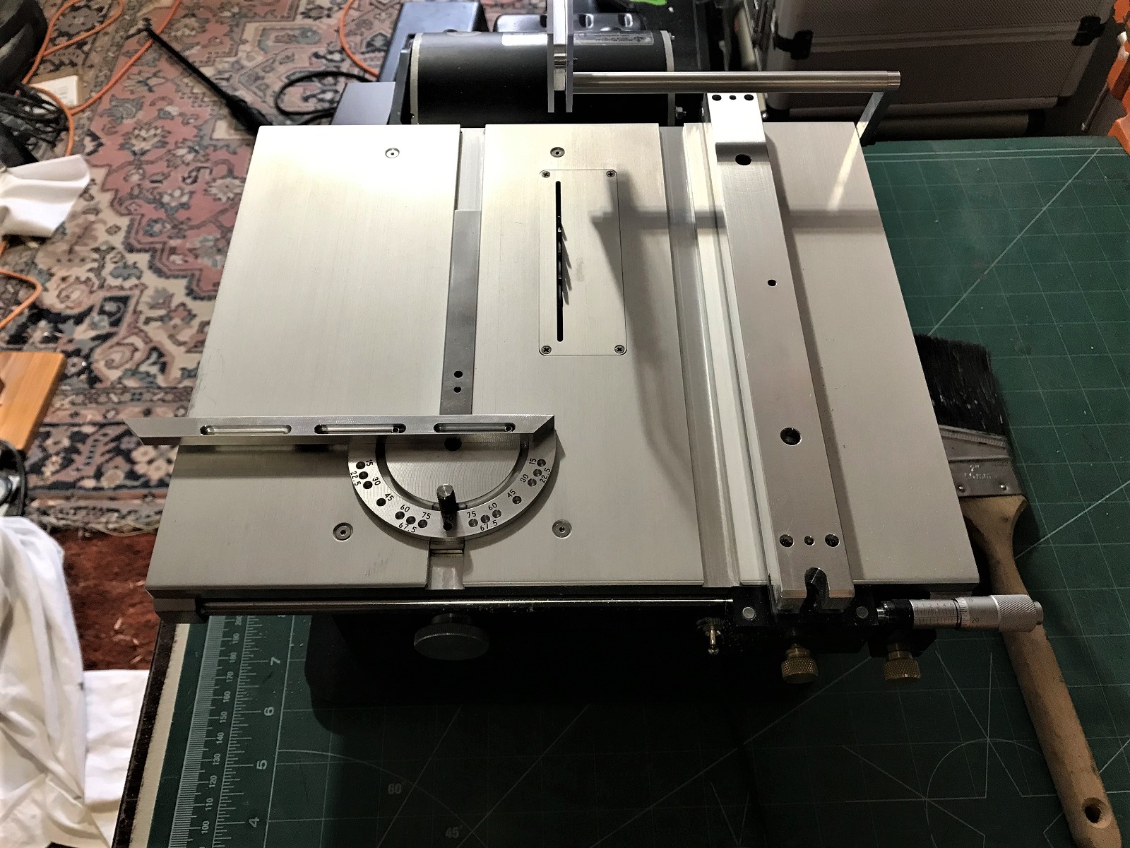

I'll give it a try. Looks like a great color supply as well. My new tool also showed up!! Been wanting one for some time now.

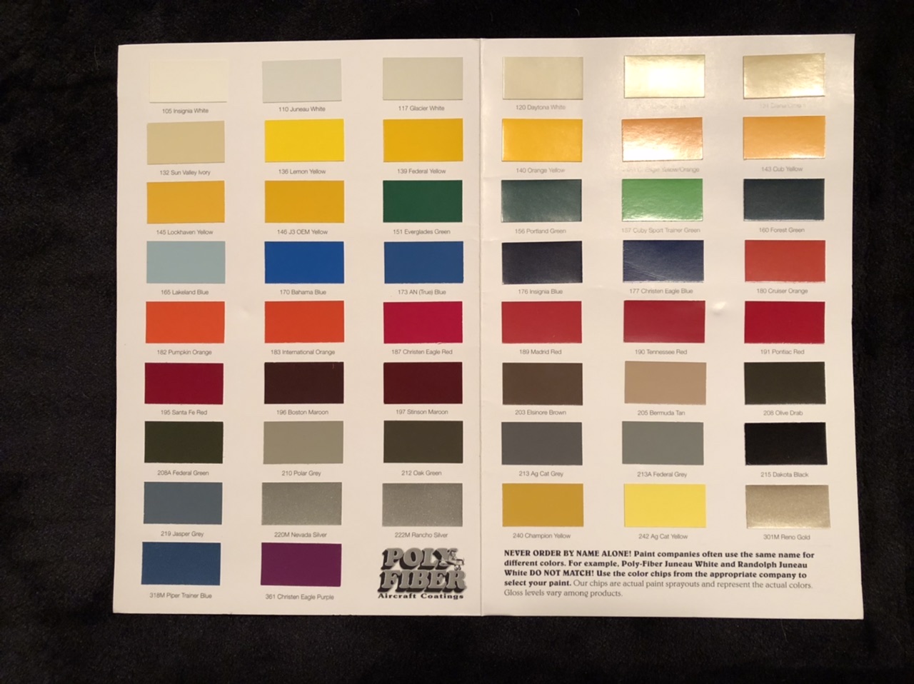

I order all my materials from www.stits.com. Give them a call and I’ll bet they will mail you a color card. I’ve had this one for a long time but didn’t see it on their website when I looked just now.
