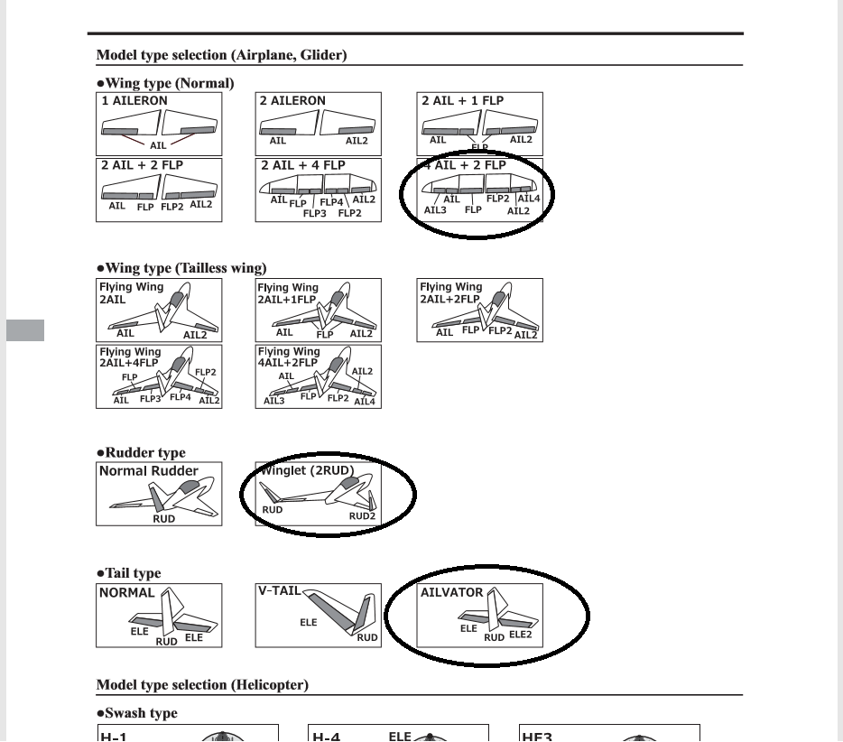

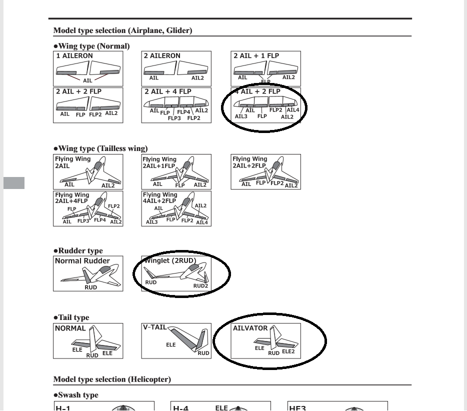

acerc
It is part of the model type found in the manual on page 72, it cover's the wing type, rudder type, and tail type. It is also possible to mirror these channels with the auxiliary channels for more surface servos but that is for another discussion.
acerc
The radio is simple giving the selected model multiple surface outputs, I don't agree with the language such as ailevator but it is what it is. But then again then if using the elevator for ailerons also, ailevator would be appropriate but this is not a given option and would have to be mixed in.
If one selects winglet the radio will show two rudder channels, ailevator will show two elevator channels.
The Vtail selection will put rudder and elevator together.
