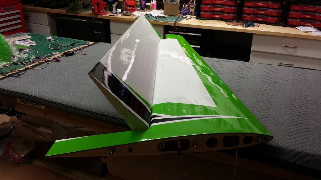

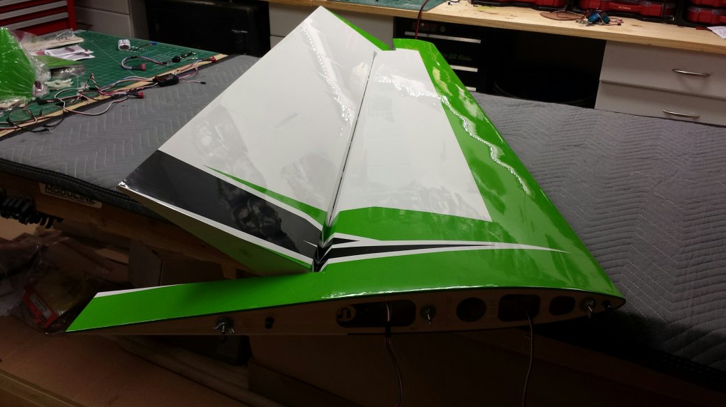

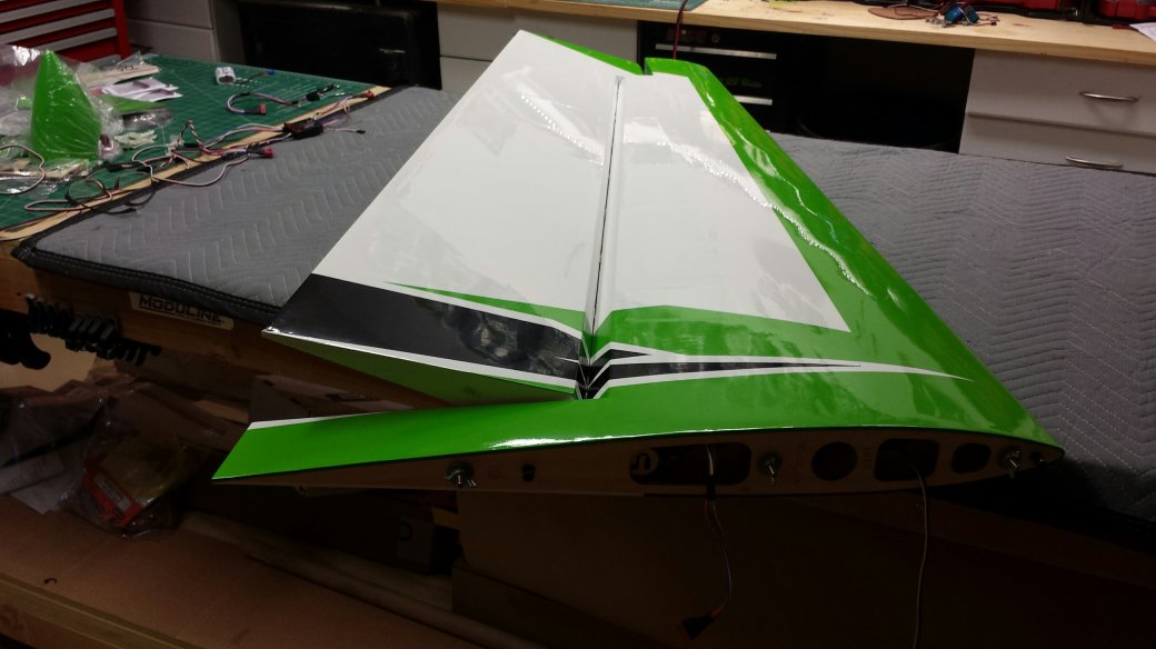

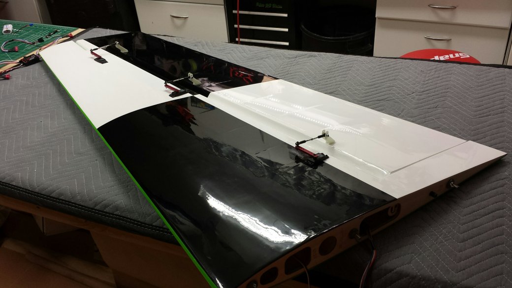

Saved the best for last and finally got around to the wings. The geometry was a bit different than the standard wing. The servo on the end is rotated due to the wing being so thin. The servo wire for the outer servo exits forward of the wing tube so I couldn't use a multi pug for all three servos. The wing spars are solid in the core so I didn't want to drill through them for the end servo wire.
Not sure how the ailerons will react in different flight situations so I put them on a three position switch until I get the characteristics sorted out.
I have not weighed it yet but these wings are without a doubt feeling heavier than the standard Pilot Extra 300 due to the extra strengthening.
