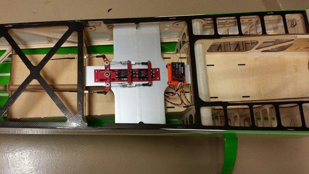

Been fighting a cold so all I got done last night was putting in dowels to keep the firewall from crushing when tightening down the bolts and painting the engine box.

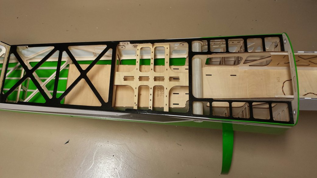

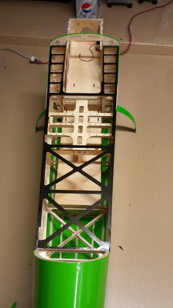

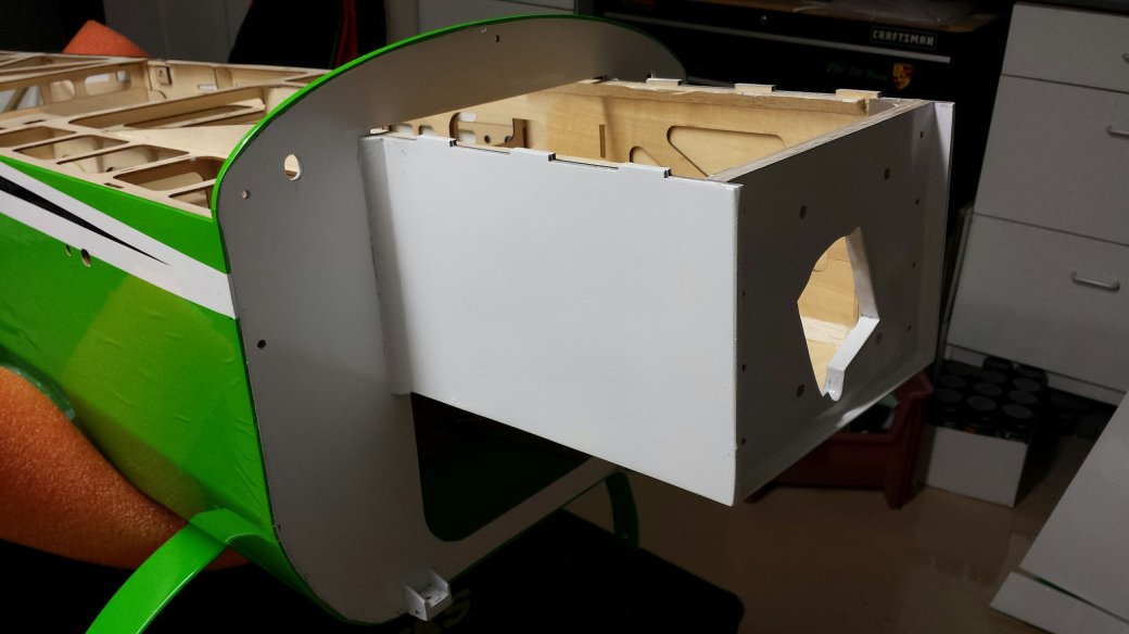

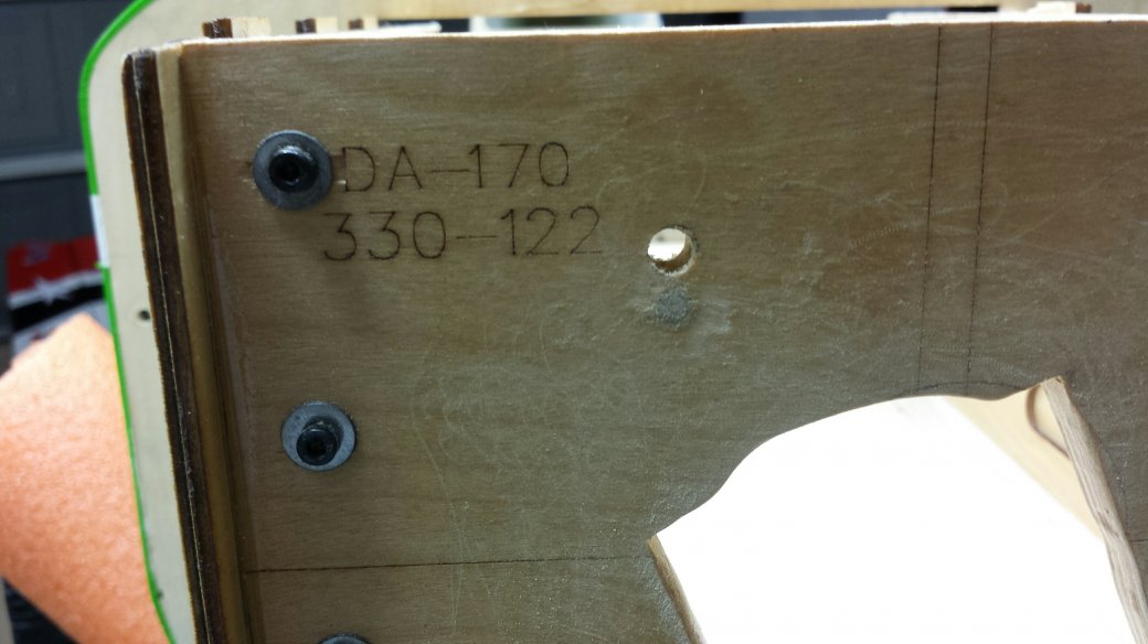

I have been dragged down by a cold so I’m moving along slow on top of that I decided to do a little custom covering. I don’t know why I get myself into this custom stuff. Probably could have finished the plane by now if I didn’t.
I installed 3/32” dowels next to the engine bolt holes to prevent the plywood from crushing resulting in a loose engine.
The engine box is painted and ready to install the ZDZ. I am keeping the top removable so that I can get to the carb and throttle servo. I am trying to decide whether or not to use a choke servo. Would love to hear some opinions on this from anyone with rear carb ZDZ experience.

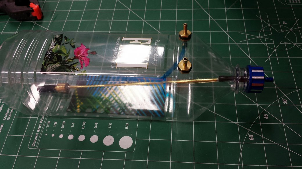

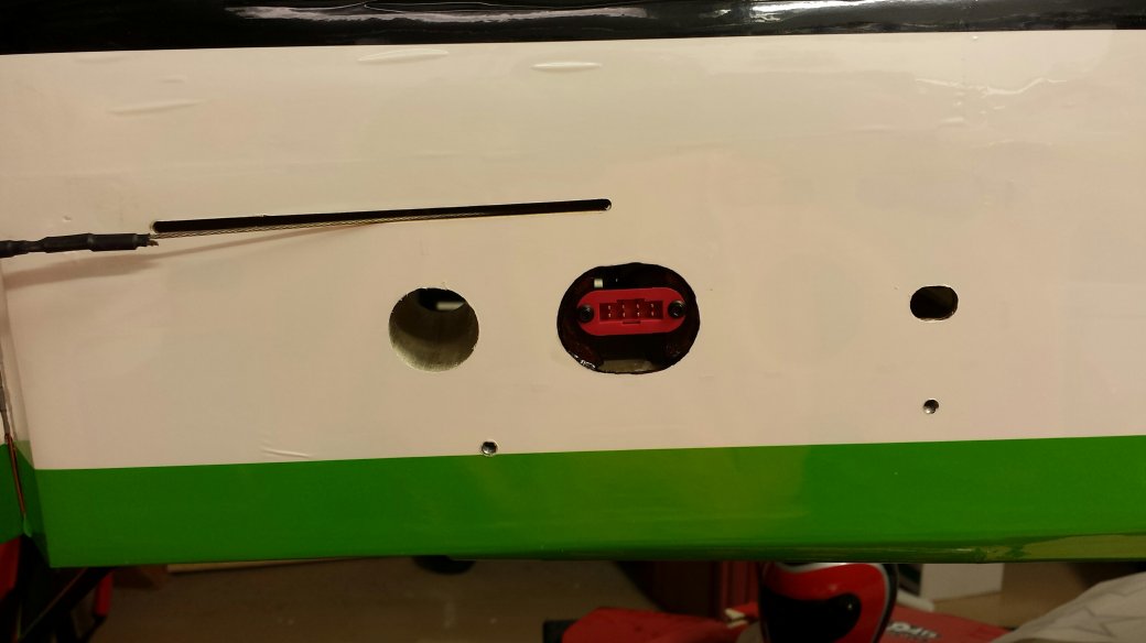

I love the Tail Dragger RC plugs for multiple servos. It makes for a clean set up and easy to assemble at the field. I made the fuel tank using Tail Dragger tank hardware. The cap and fittings are great quality. Definately going to use them from now on.

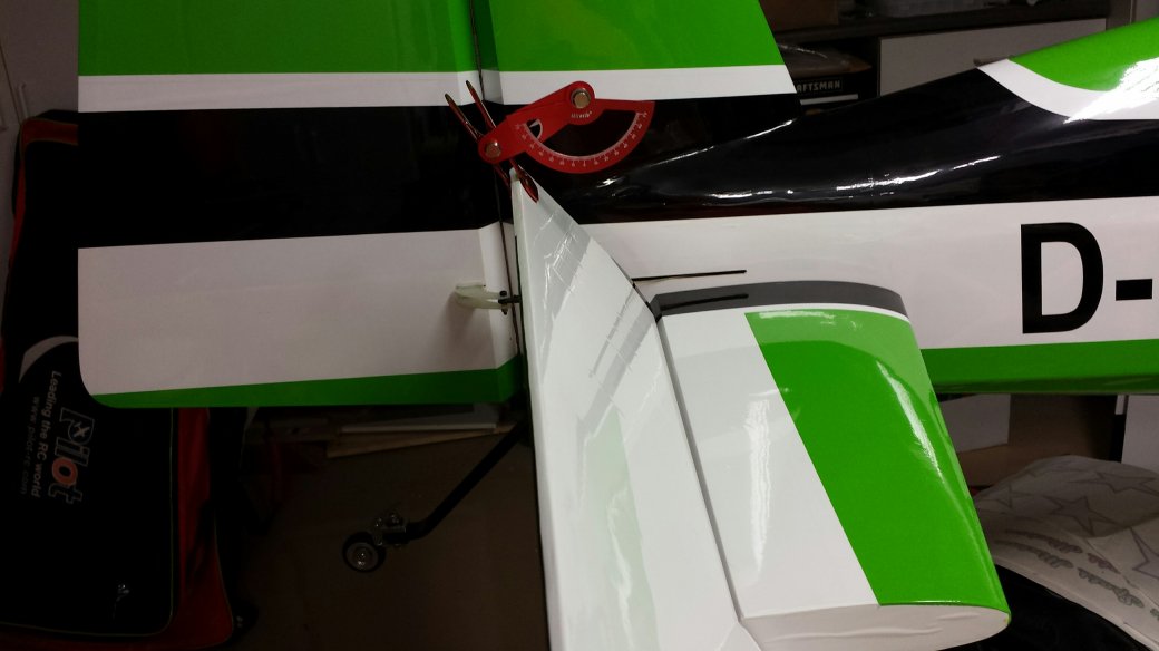

I think I almost have enough elevator at 70 degrees.
I was going to start on the wings yesterday but I am saving them for last.
Thanks for looking, Spats
